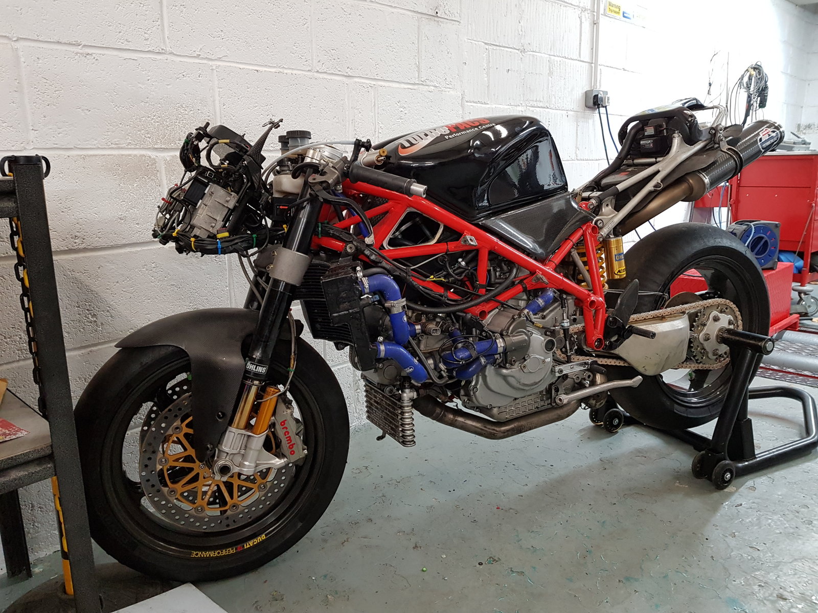

  14. @ducv2 we need some pics of your bike mate, every one loves a track bike.:D
    Been posted before, but here you go.
