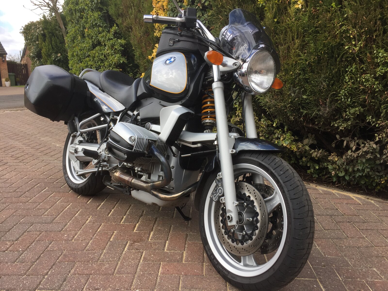

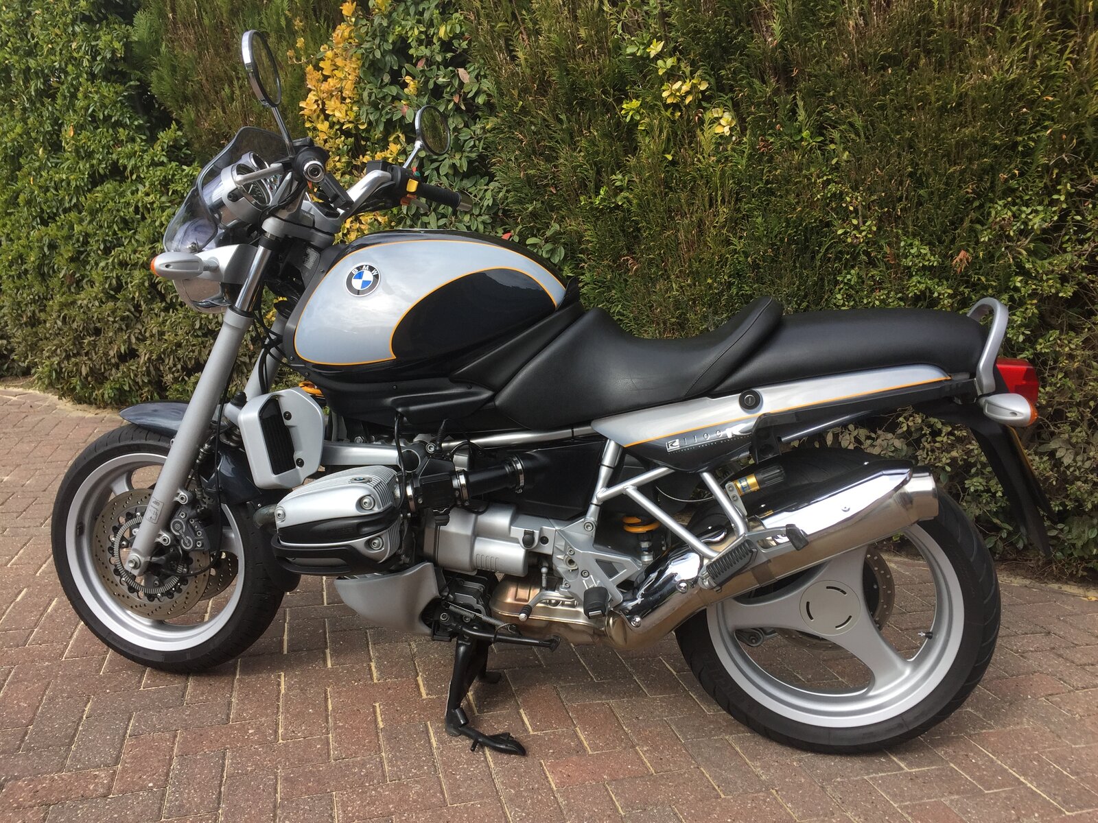

    My “Keeper” almost 21 years old, 43,000 miles looks good as new, goes like a train and it’s got Ohlins shocks on it so it’s a great thing to hustle about!
  7. Oil cooled heads.... the evolution of my air cooled heads.
  8. My R100rs with the 916 lurking in background
