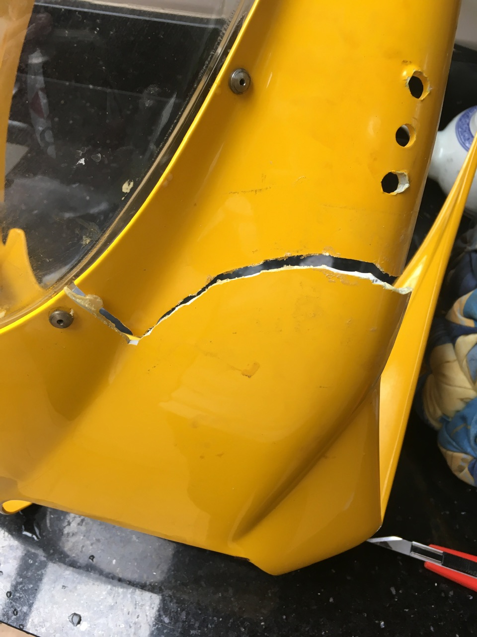

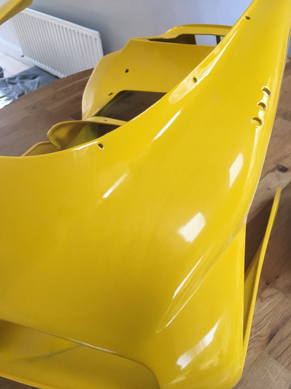

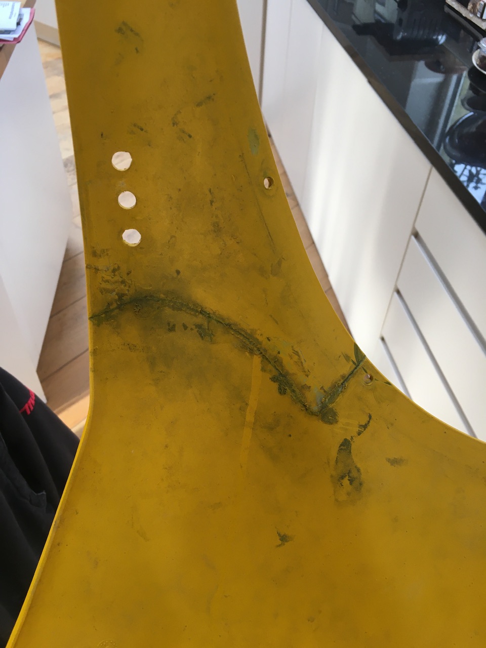

  2. Q Bond and a hot staple gun. I Cut a V along the fracture on the front once the parts were stapled and glued together then filled the V with filler, sanded smooth and resprayed.
  3. Wow, now that's what I call a good job. What bonding product did you use?

  5. What is the difference between a staple gun; a hot gun and a hot staple gun please?
  6. Would such a repair be suitable and robust enough for a broken tab?

    Staples were on the inside so not visible from the outside, they provide strength and minimise flex as superglue joints get brittle.
    The hot staple I’m referring to is a product such as this.
    https://amzn.eu/d/7bNaHR9
    The ‘staple’ is heated, pushed into the plastic, but not all the way through, twisted slightly under the surface of the plastic and forms a permanent splint.
    Most definitely. I use them all the time on broken fairing tabs.
