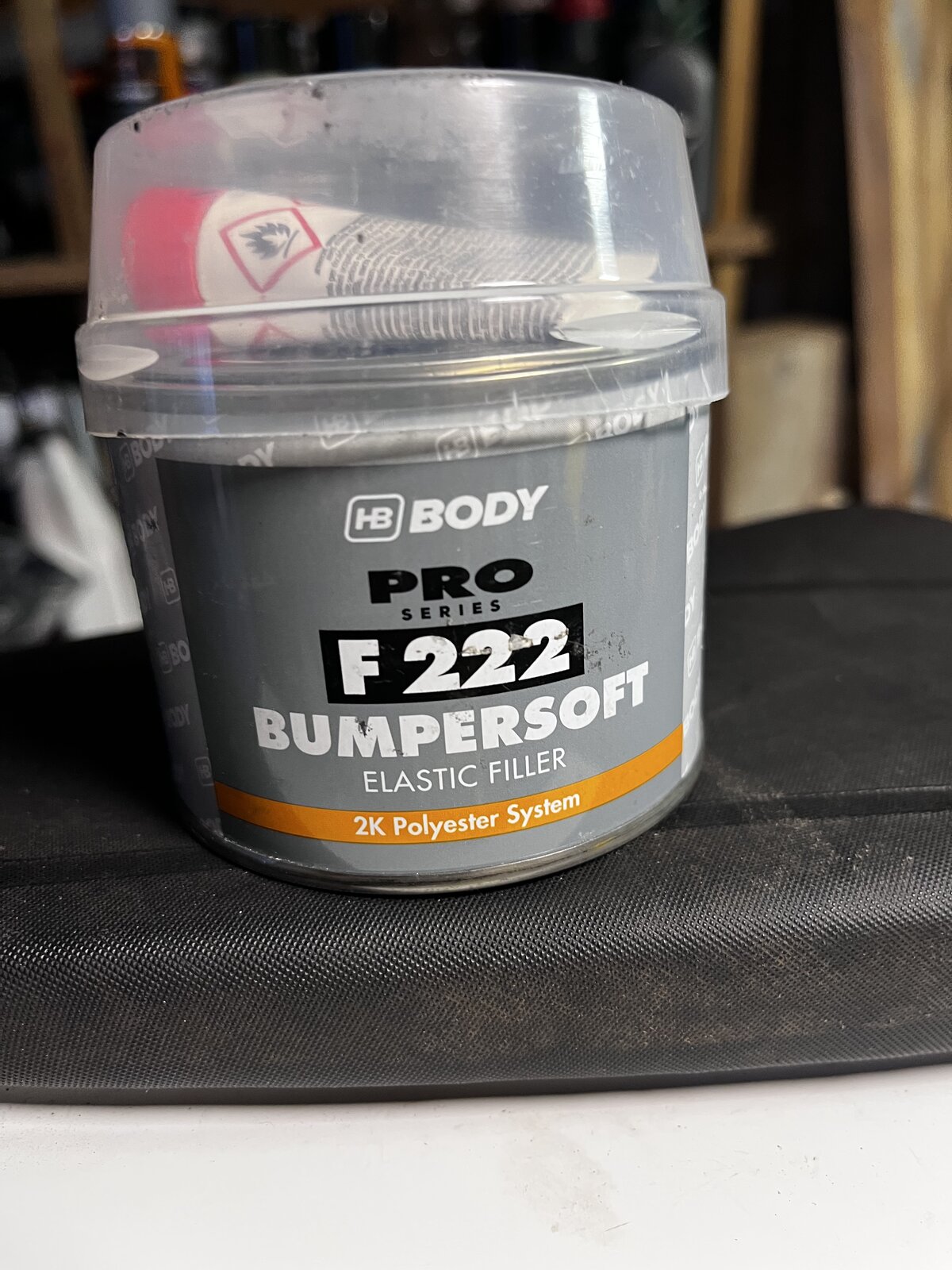

  1. I get the impression the bodywork is ABS? I painted plenty of steel stuff back in the day, but the only plastic I've ever painted was the fairing repair on the early-90s BMW (using GRP, and paint supplied by the BMW dealer).
    So can anyone tell me what filler and paint (and shade of red) I should use? Essentially we're talking scoring. The work doesn't look hard, but I wouldn't want to make the original paint craze or bubble.
  2. If you have any cracks in it then you can plastic weld abs. For the filler you want something suitable for plastics with a bit of flex to it, I used to use one called plastic padding but I’m not sure it’s still available.

  4. Plastic Padding! My Dad used to have that when I was at school ! Brilliant, if you can use that. If it's still available.

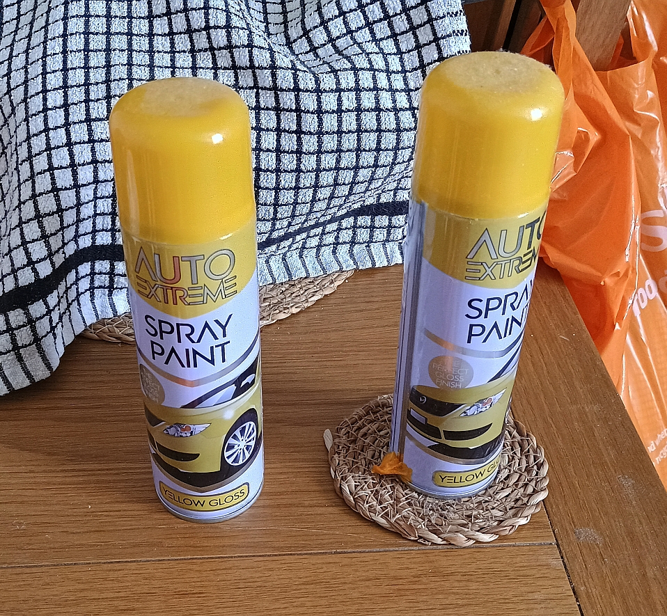

    Anyway, here's a first for me:
    The yellow I bought online for spraying a Strat, 2 or 3 years ago. Just sat in the house, untouched, all that time. I thought I'd dig them out and wondered what jellylike thing I was touching. See the can on the right's been leaking?
