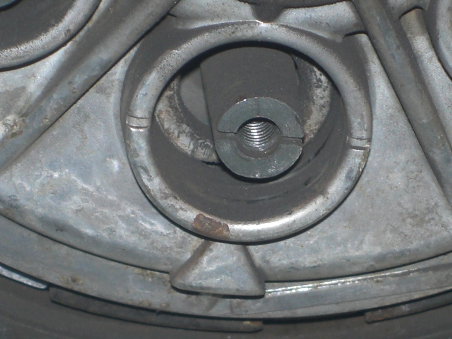

  7. in that case, 2 things:- did you align your pressure plate with your drum? - see picture below - notched spring post aligns with triangle/arrow on pressure plate.
    also, have you got std clutch cover and have you removed the standard rubber "gasket"?
  8. Yes pressure plate arrow is lined up with notched spring post & I have the standard rubber gasket and clutch cover. The gasket is damaged and does not have the collets
