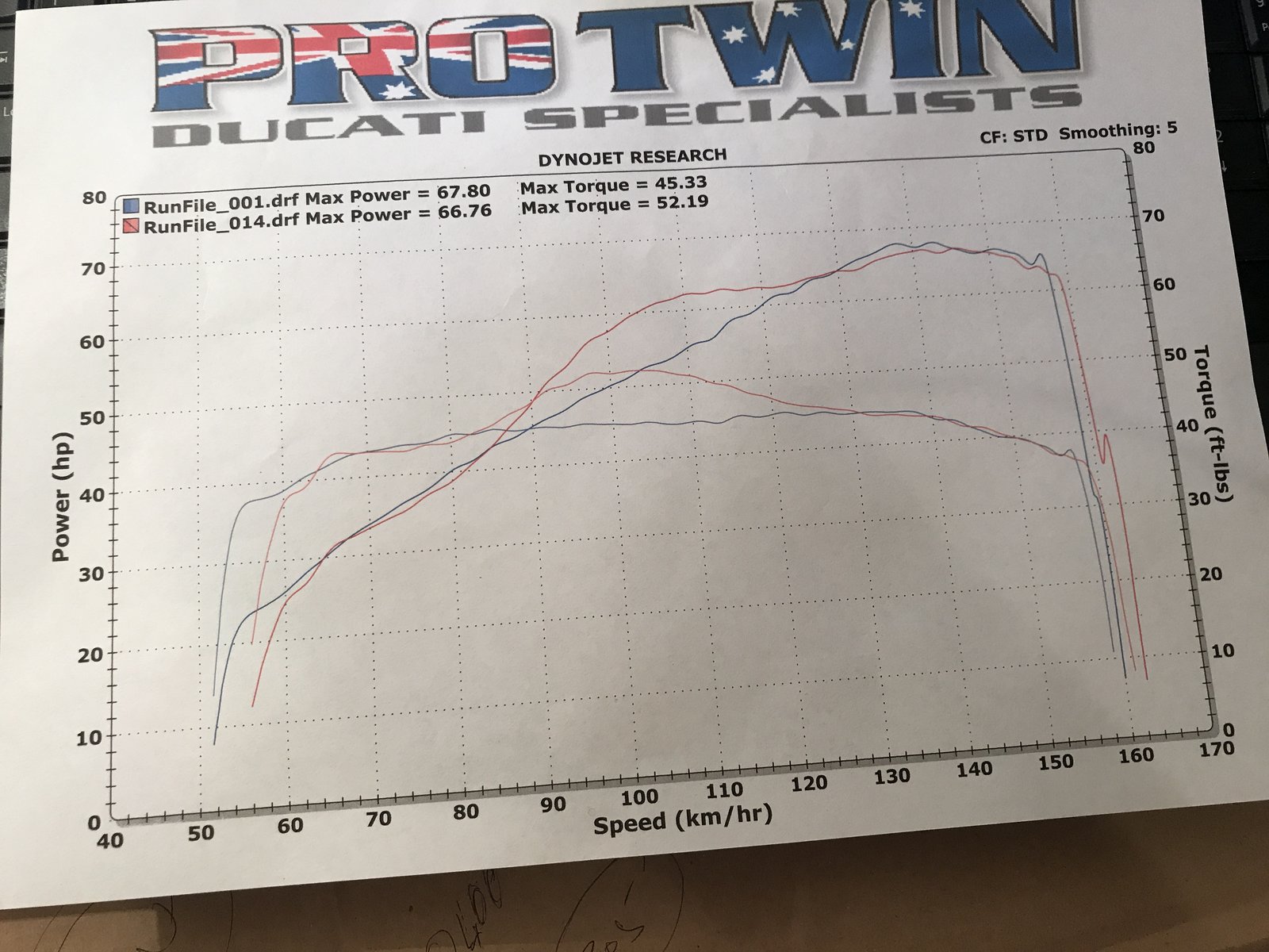

Another way; Total remap of scrambler ECU; no add-on control, requires an ignition remap as well, Kit comes from Todd Paterson at Bunbary Ducati. the midrange is significantly "filled in" ant the top end is not sacificed. Red is Modified Curve. The modified bike is even more punchy, wheel stands easier; squirts better around city roads. Scrambler
different airbox, and very different throttle-body bell mouths search ; Todd Paterson Bunbarry Ducati

No other way to get these results, these engines are not going to produce more reves Hp=plan horsepower=bmep X lenght of stroke X piston area X number of strokes (revs) the problem is the 2 valve head, and port angles there is no way to improve its flow above 7500/8000rpm without expensive surgery, (re-angle ports, squish bands, combustion shape, valve angles) so this is amazing because it seems to increase the bandwidth of "on the cam"
no Todd had problems altering the ignition map; So has collaborated with ? Jason Klashorst to remap the Ducati ECU but has to purchase a "key": to allow access to the Ducati maps in the Oem ECU and modify the ignition curve Todd need to do this; because he wouldnt allow release of the Kit untill he was sure the best possible map was able to be provided. He was unable to be sure the Rexxer provided the best possible outcomes; after the remap of the standard hardware was accomplished it was thought the OEM remap worked better. Contact Todd +61 897217470and find out if I got it right What an amazing punchy 805cc scrambler, difference like night and day, hardly lost any hp on top, if it had been tuned for topend, I dont think it would possibly even held the standard midrange, this way the bike is transformed to ride, and the reasons why it is so much fun to ride, have just increased. Todds number? am I allow to publish it here?
