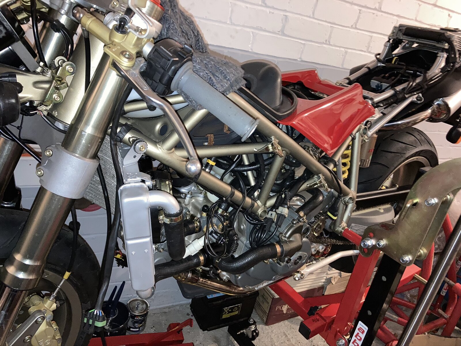

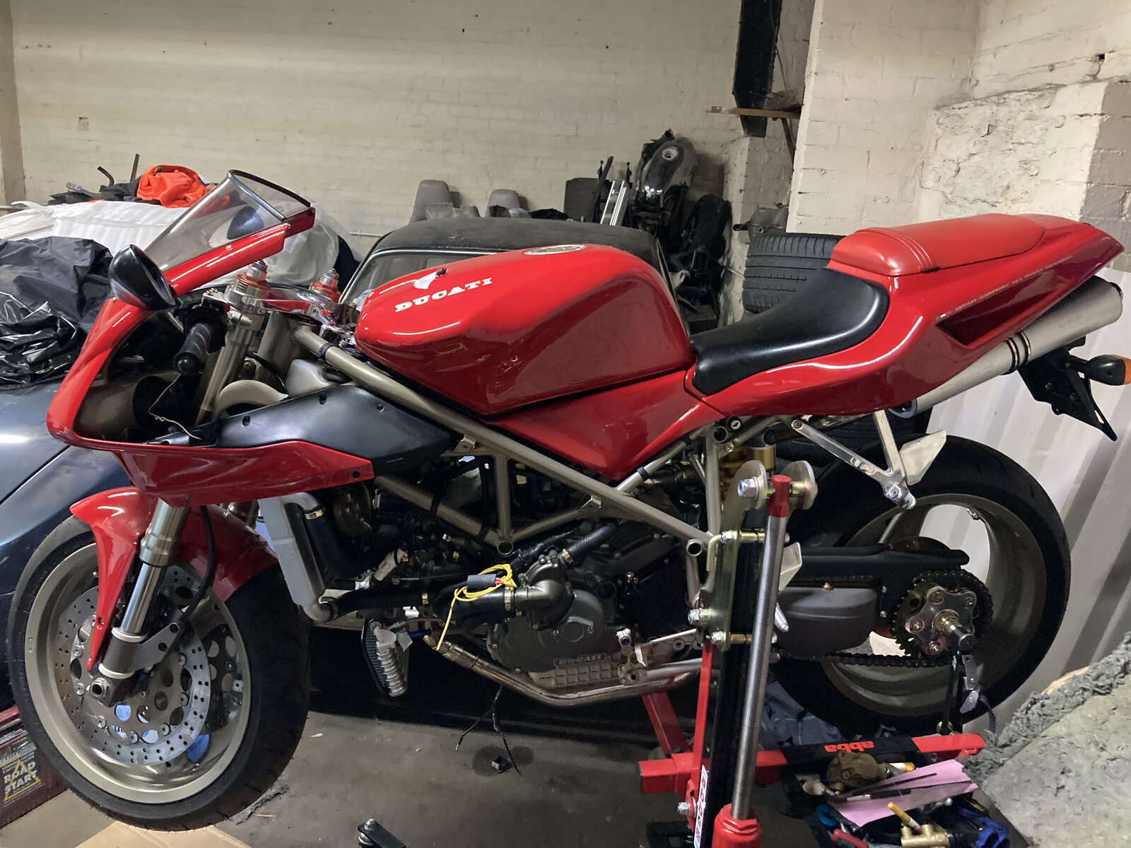

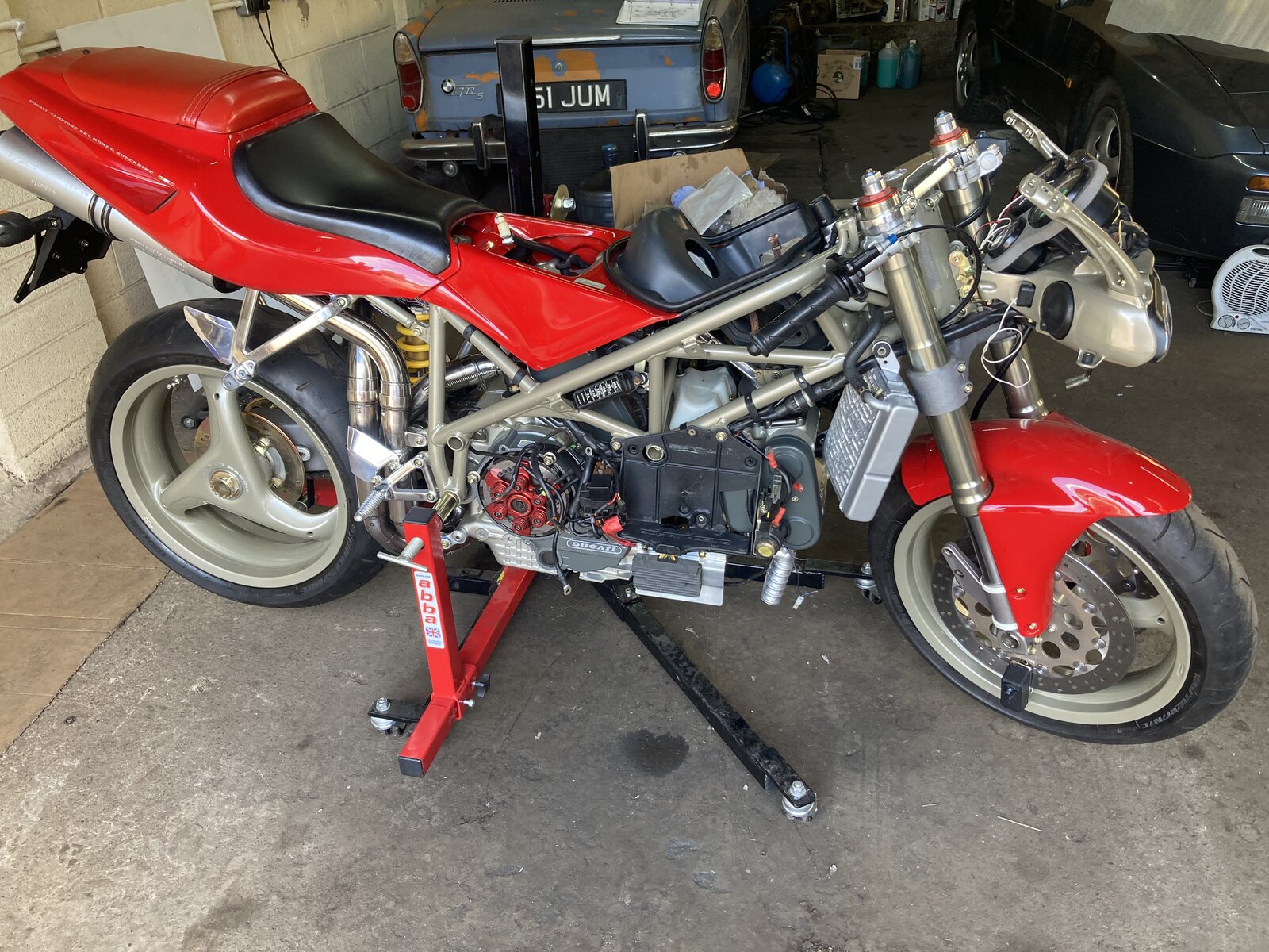

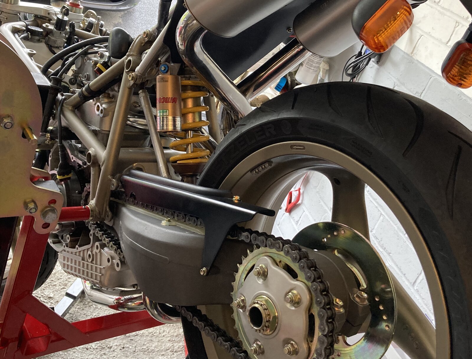

  3. To strip everything off the frame is a massive job. The problem is whilst it’s in bits you may as well change this bearing, those bolts, plate this bracket, paint that engine cover, polish them pipes and before you know it your £3k in and still doing it. I know I’ve still got 3 on the go!! If it’s just paint in an aerosol and your gonna take time to mask off what you can get at, I’d use Mal at bike colours in Morecambe. Most helpful and a good painter in his previous life. All posted promptly and correct colours. Shop available on eBay.
    goodluck whichever way you choose to go. Don’t know any platers local to yourself sorry.

  4. You need gold zinc but finish can vary plater to plater. It’s all about the prep!
  5. Ah, so its gold ZINC. Righto. Thanks peeps.
    Chris, yours look very nice. Mine is non standard (I do have all the old parts though), I genuinely don't need to do anything other than frame. I don't want a pristine bike. I'll ride it and ruin it. Its just some odds and sods may need replating. My engine is strong and needs no work.

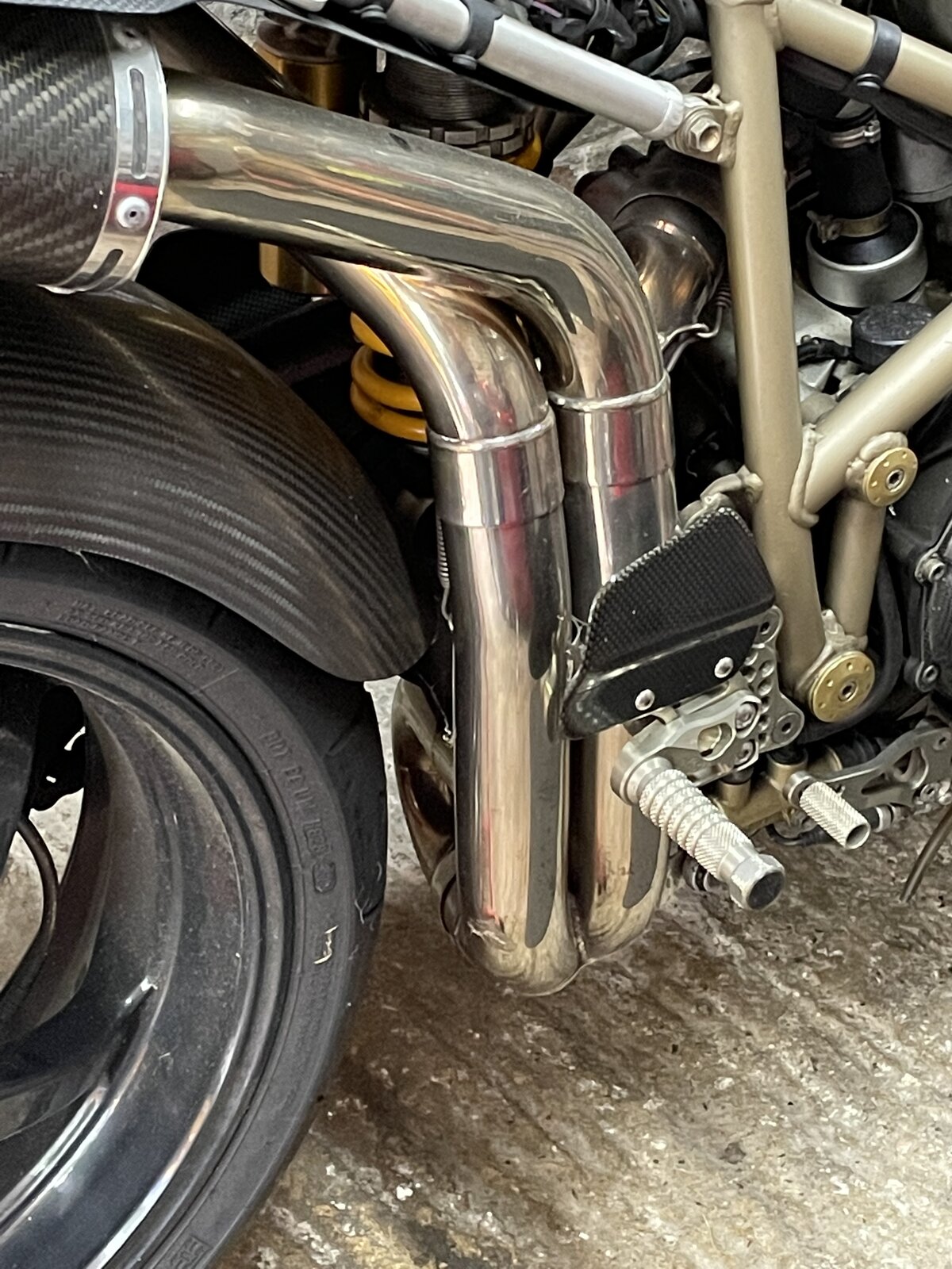

  7. Can anyone identify these mid pipes as they didn't have a heat shield bracket. Which isn't that bad tbh, esp compared to 1198 which grilled my calf and 1299 which boils my crackers.
  8. I don’t know the link pipe but it looks 50mm plus. If bigger than 50mm you need to space the footrests out which might be the case as your pegs are non standard. You can get heat shields that are mounted on a jubilee clip with a stud on and tend to mount on the bend of the slip on.

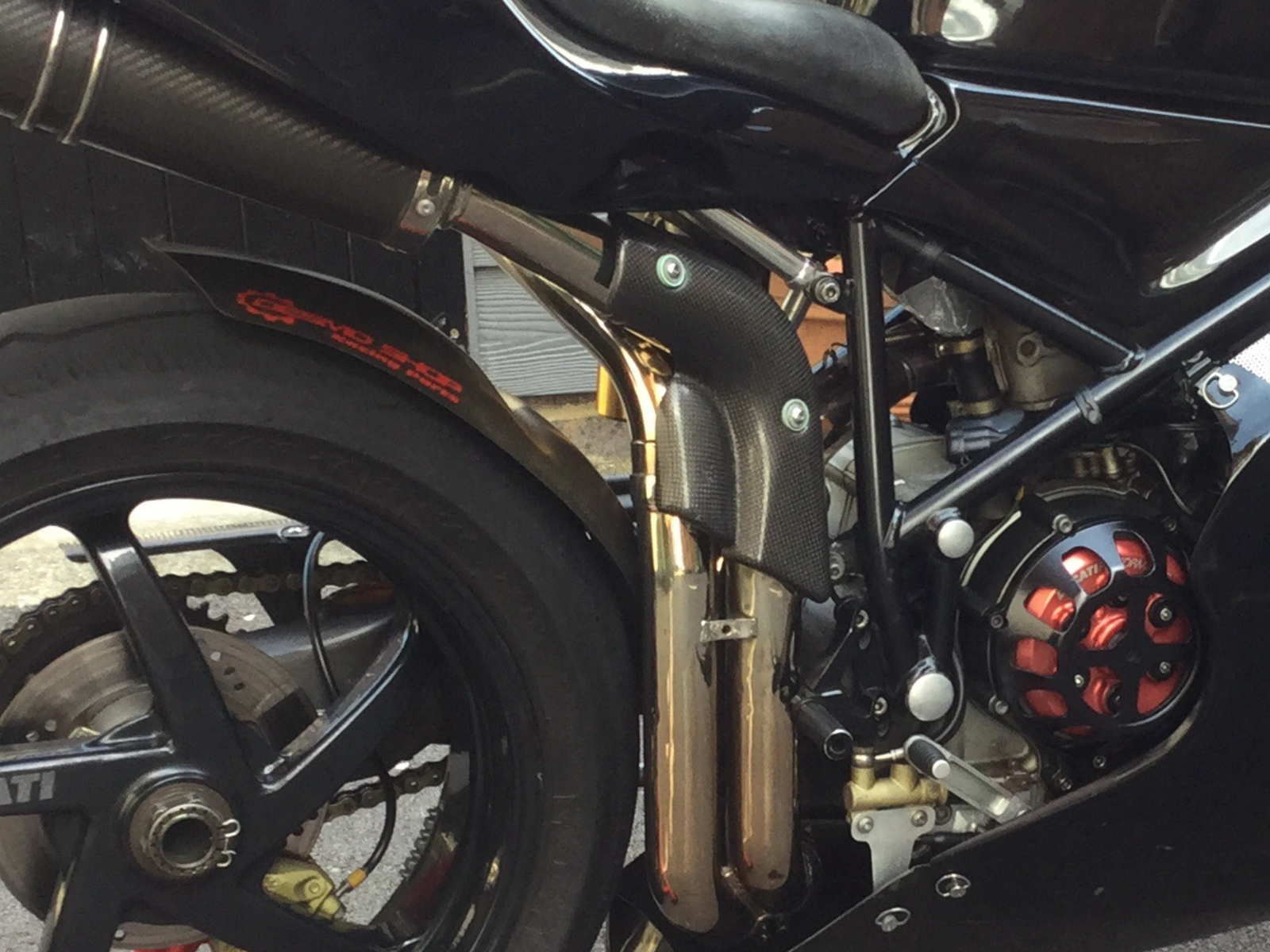

  9. Are they the same as these I had on my old heap?
    I had one of the clamps on a jubilee clip as mentioned.
    I paid a chap 60 quid to polish my pipes as I knew it would be a fakking pollaver!
  10. What size are your headers ? Andy
  11. They're 50mm OD.
  12. Then it is similar to a full 996 50mm system I sold a few years ago and that used the the jubilee style clamp for the heat shield. Not sure if I can find it but I might have a spare which you are welcome to. Andy
  13. I may have bought it from you Andy. I can't remember where I got it. It was unpolished though. Thats very kind of you but I like it without tbh. I like the line of the pipes.
