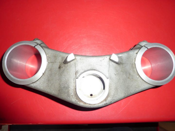

    Does any one have any pointers for drilling out the bottom yoke to allow the use of a under yoke paddock stand?
    anybody attempted it?
    Paul
  2. Not done it because I swapped mine for an Ohlins yoke that is already drilled however after looking at the original yoke I see no reason why you couldn't drill it. Would be best to remove from the bike for a neat job.
    Just don't use the drain hole as a guide, because it's not central.
  3. drill in the centre of the blind hole, it shouldn't weaken the yoke at all
