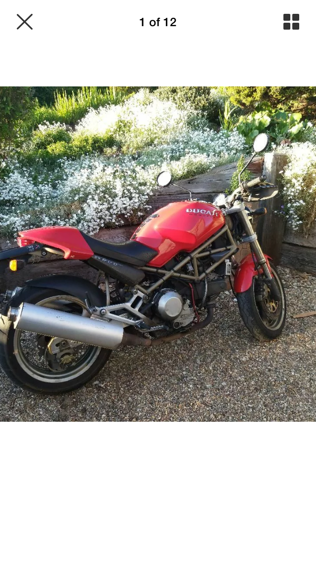

  1. Hi all I’m buying a cheap (I think) old M900 in the morning, N reg , I’ve already got a 900ss carby so I think I know what to look out for engine wise but are there any particular foibles ref the Monster that I should look for before parting with my hard earned cash???, it’s high mileage 39k, has had recent belts, wheel bearings, starter motor and clutch plates, but it needs a lot of cosmetic TLC, but as I said is there anything peculiar to M900’s that I should check out?, thanks Mark, here’s a photo
  2. Pretty much bullet proof, my 93 has 37k miles but I have done piston rings and valve guide seals, other than that all good

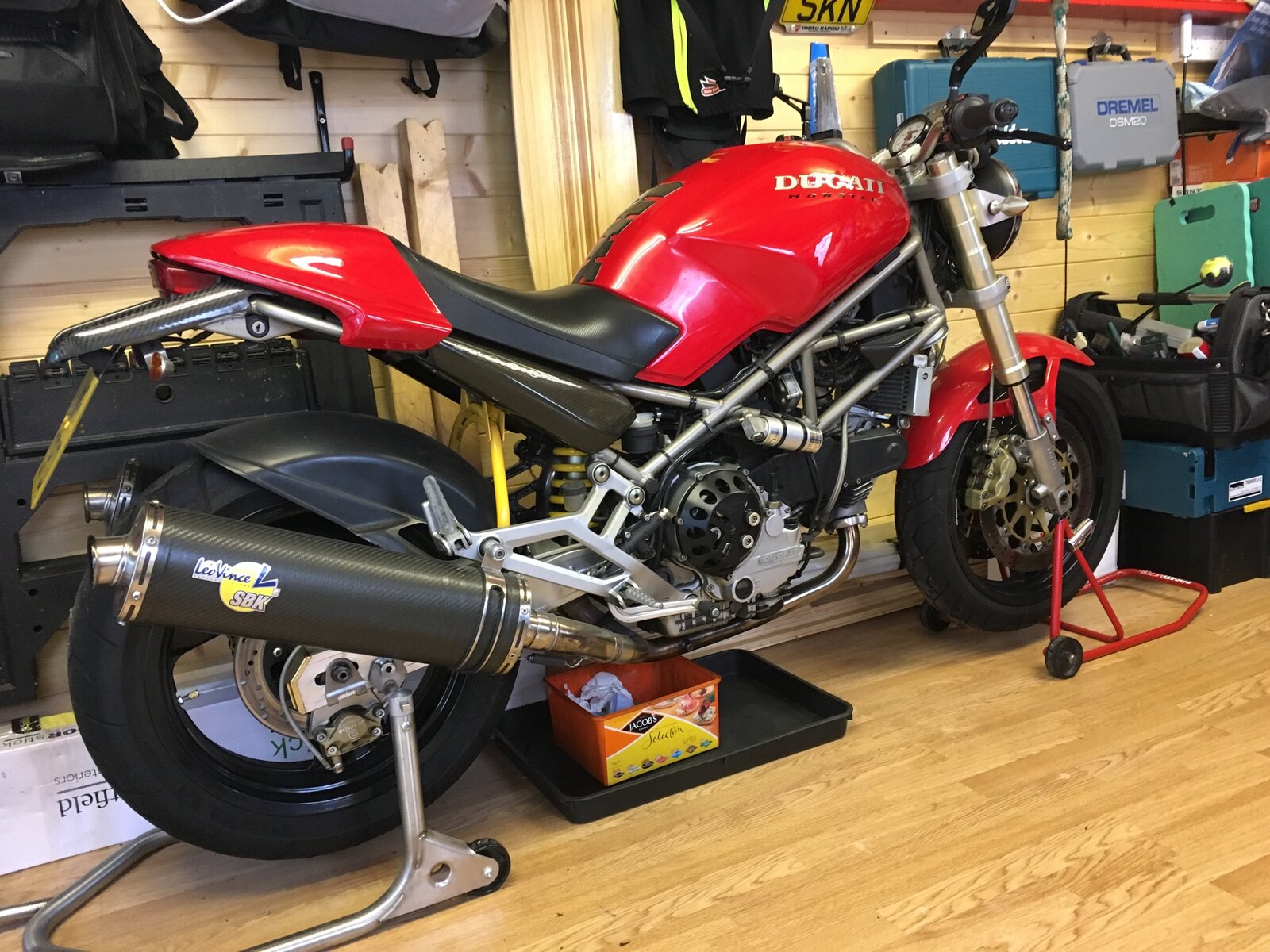

  4. Quick additional thought - regulator rectifiers are a bit iffy on older bikes but plenty of options to fix if it goes t*ts up
    Here’s mine
  5. Cheers Ped, yours looks great btw, the wheels on mine (if I buy) look rough in the photos and seeing the black wheels on yours makes me think I might go that way, although I have a couple of tins of gold Foliatec wheel paint in the garage so I might try that first, anyway off to York in an hour or so to have a look.
  6. Clean and presentable,are you sure it's not a british bike with that container underneath;)hope you get many enjoyable miles this summer:upyeah:
  7. Drip tray storage only!
  8. Thanks for the reminder as i need some cheese crackers over this coming week:yum:upyeah:

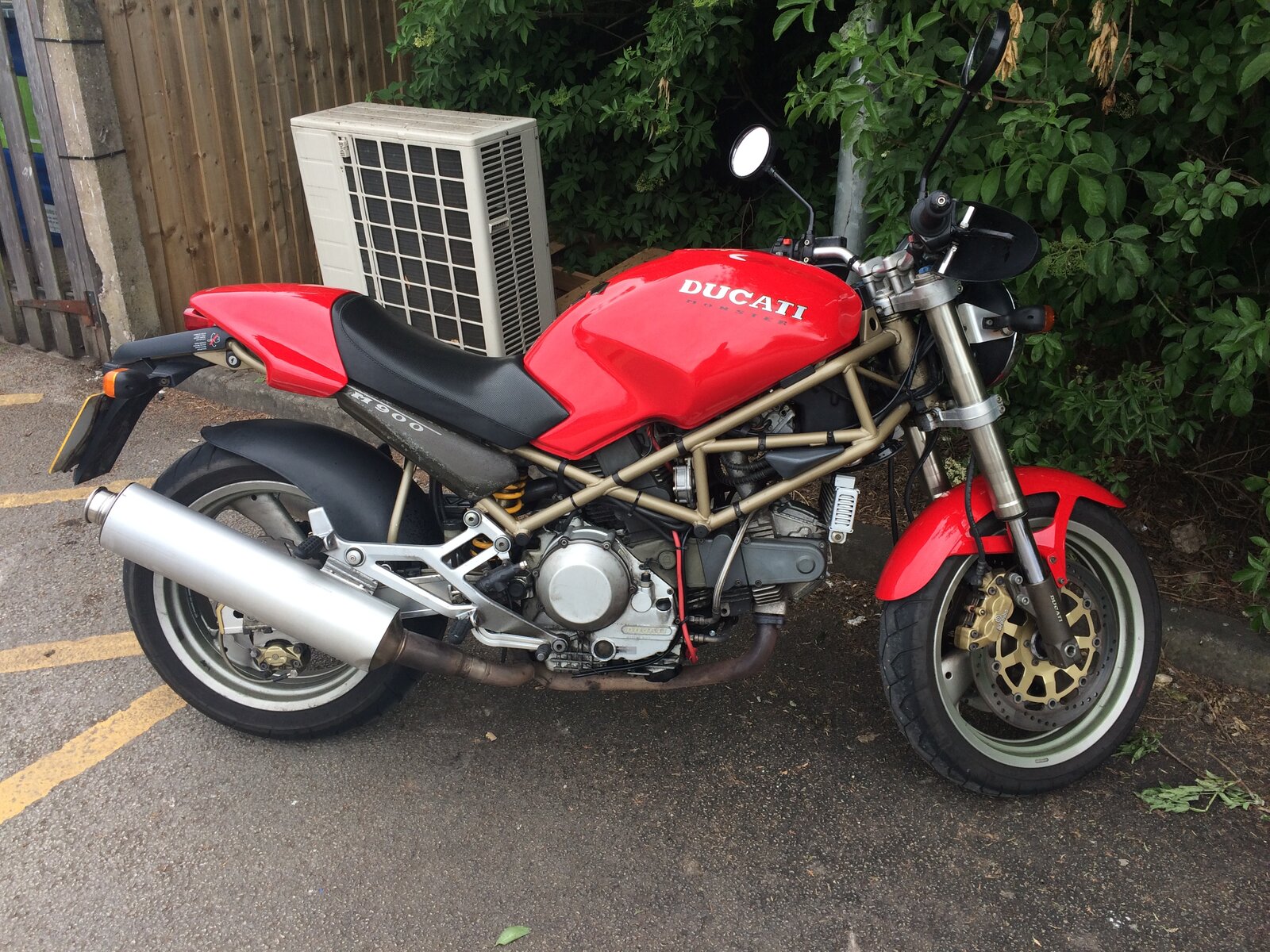

  10. 72D9444E-ACCD-4277-9FEE-6FE0EA437881.jpeg Bought it, it seems ok but I’ve only done 8 miles and pulled in for a coffee, the only issue so far is front brake judder, could be a warped disc, stuck bobbins or contaminated from the quick clean I just gave it, I’ll have a better look tomorrow when I’m not tired but in general so far so good, (loads of cosmetics to do as well), any thought on the front brakes welcome, cheers Mark.
  11. Nice one! Where’s the bin?
  12. They look like aftermarket discs to me, I’d start there
    Other than that looks ok to me
  13. I’d start with cleaning up the brake pads and disks.
    If you can get the front wheel off the ground it would be worthwhile spinning the wheel to check for runout: disk and wheel rim, plus check the wheel bearings run free and the steering head bearings aren’t dry.
  14. Thanks all, I’ll start with cleaning the discs and pads properly , then get it on the stands and get the DTI on it, does anyone know what the largest acceptable runout is?

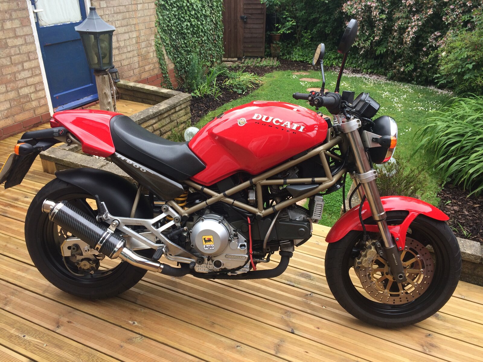

    Thanks Chris, I’ve been tarting it up a bit, lots still to do but here it is as it stands
  19. Nice exhaust mod. Who made that shiny new one? Its got much better proportions than the original. Now with black wheels too. And cleaned up. You are on it - though the Agip sticker could be a little straighter! LOL
    PS
    Harpic should get most of the crap off your down pipes. Google it on youtube.
