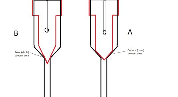

  7. The nipples seal with a metal to metal seal at the internal end , the threads are not the seal, you do not put tape on the threads.
    The fluid can leak when bleeding , this doesn't matter when bleeding the old fashioned way, as long as they don't leak when you tighten them down.
  8. agree it is the seat where the nipple seals not the threads
    would not worry about fluid around threads when nipple is open
    only when the nipple is tight as it would not be seating properly and that could be a problem
    as said not a problem if bleeding the old way ie applying pressure on the system from the master cylinder
    if bleeding by suction from the bleed nipple itself it can suck air in and be a pain
    friend bought an expensive (well by my thoughts )vaccume bleed pump and had loads of hassle thinking he had air leaks in the system when it was sucking in air around the threads
    diagram below shows the nipple seating and sealing
    on the one on the right
  9. You do not say whether you are using new/replacement nipples, but I had this issue when I bought new nipples, for the reason explained above - the chamfered angle of the new nipples was very slightly different to the originals and for that reason, they did not seal properly
  10. But B is correct isn't it? That's how AP callipers work anyway on a diagram I posted on here a while back.

  15. see what you mean on the Lockheed diagram
    thought A would have more of a sealing face ?
    but anyway I only put up the diagram to show it was not the threads that seal
    learn something new everyday :upyeah:
  16. Two mating tapered surfaces are harder to machine for sealing faces, a smaller cone into a larger hole forms a seal even if there are slight manufacturing inaccuracies as it forms the seal as it tightens and takes out any high spots :smileys:
