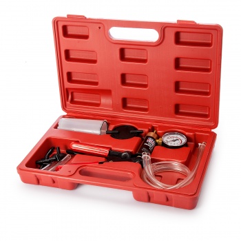

  1. hello, just about to buy a brake and clutch bleeding kit has anyone used the Sealey Vacuum Tester and Brake Bleeding Kit or could anyone recommend one for a 748 as so many mixed reviews thanks all in advance
  2. Piece of clear tube, jam jar and a large syringe (to empty reservoirs) works every time.

  3. Yeah that's what I used to use when I had help, but on my own doing this so thought I might try and get some kit to make it easier
  4. I had one of those. Broke after a couple of uses and didn't find it that much better than doing it manually. Now I just use the tubing from the kit to do it manually.
  5. Might do the old method then need to get hold of the right size tubing and a syringe then and save the bunce
