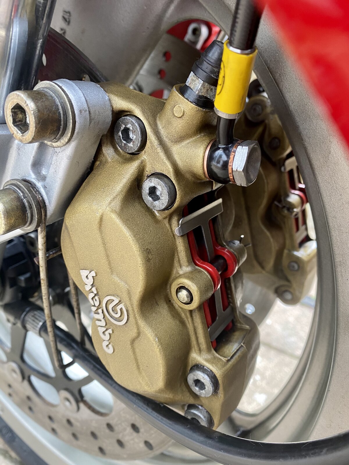

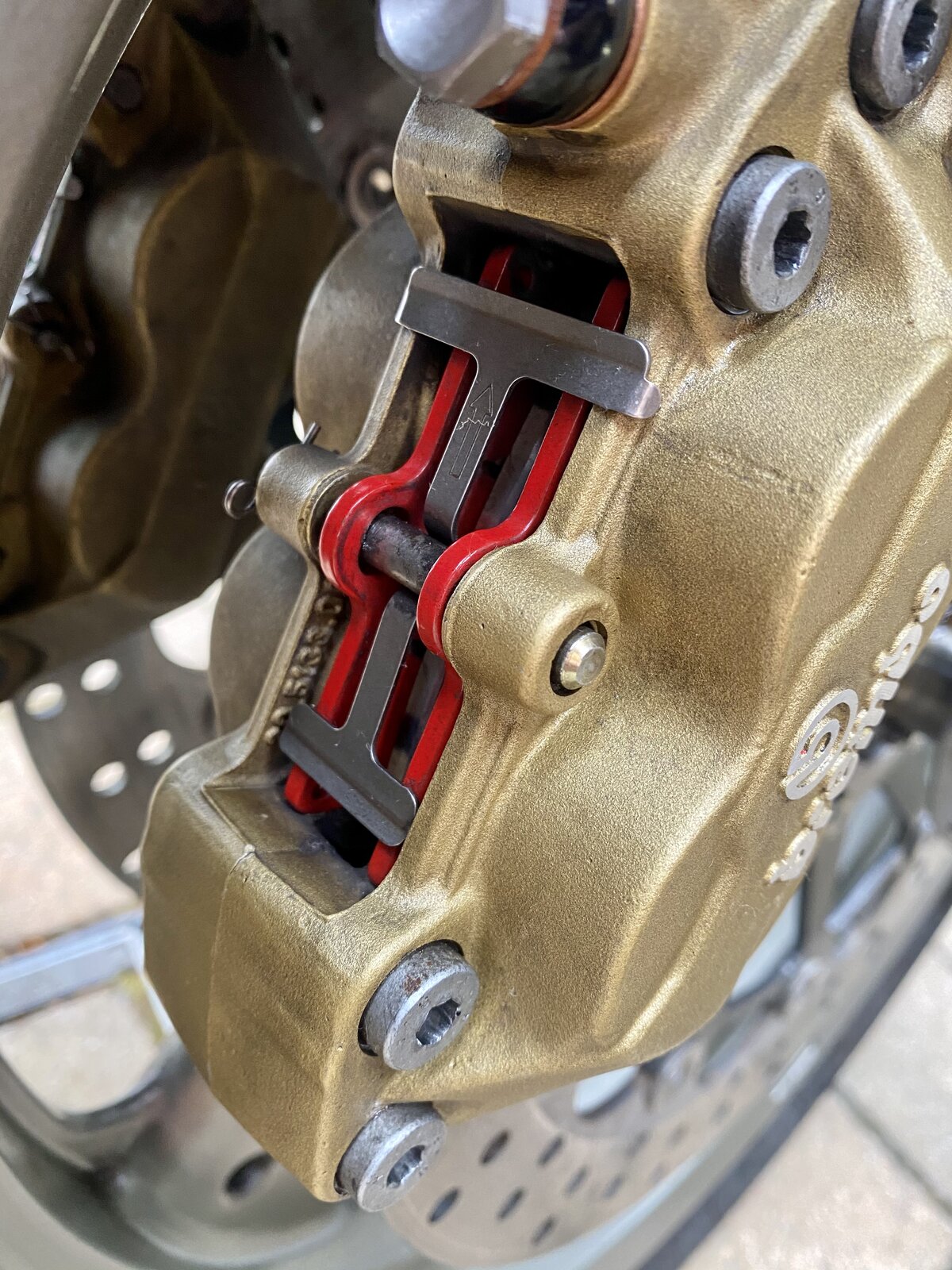

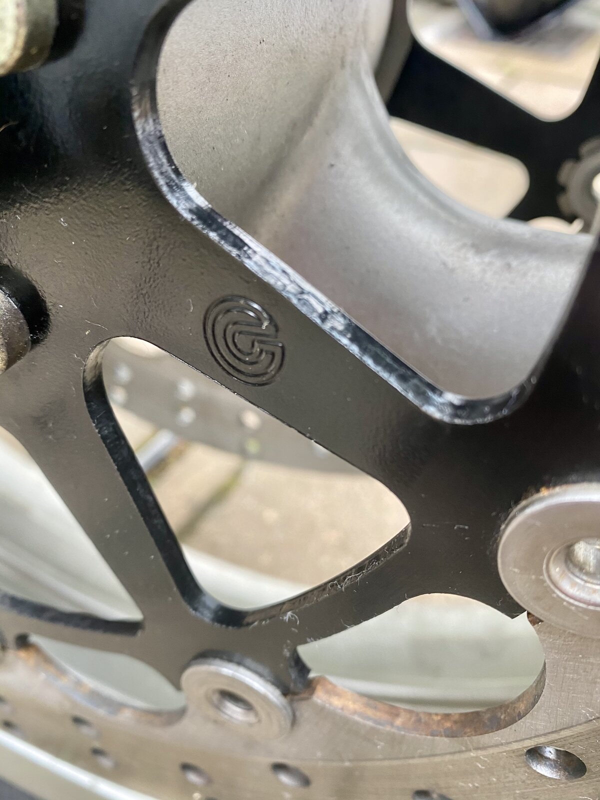

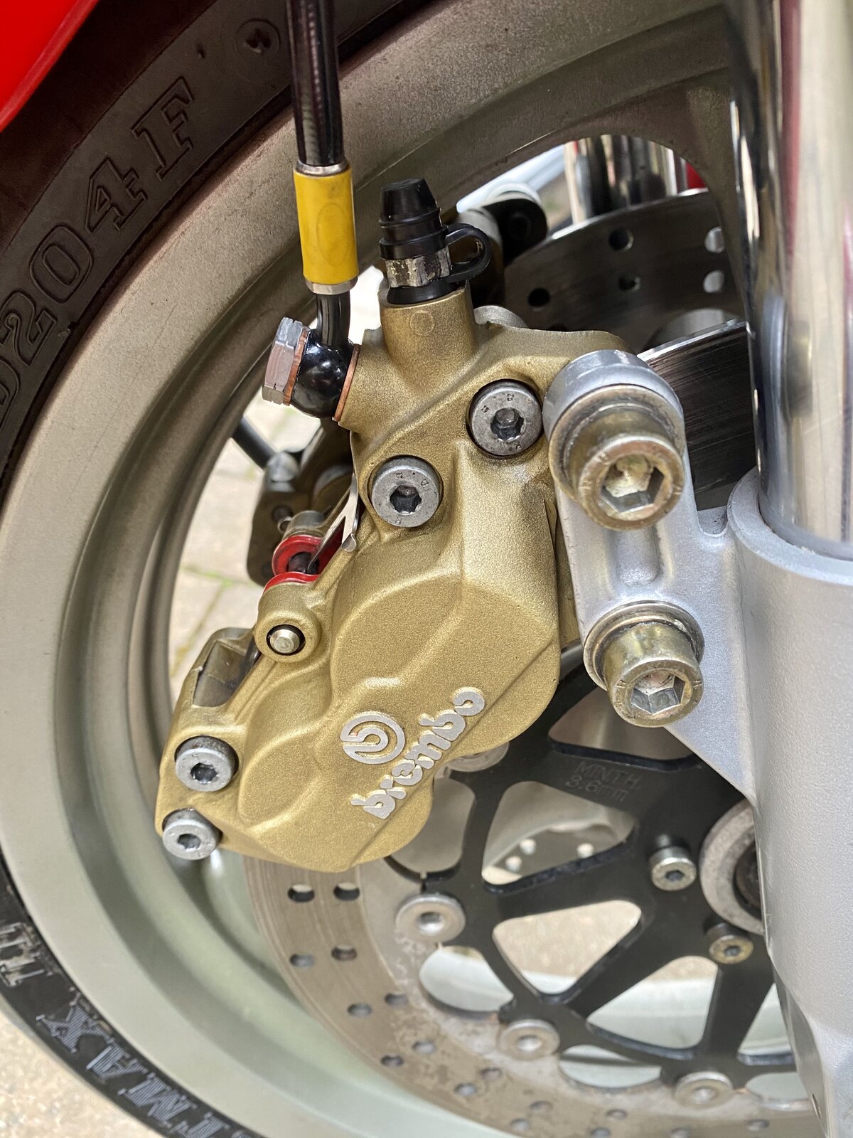

    It seems to me it should be an MOT advisory but it tends to get overlooked for some reason.

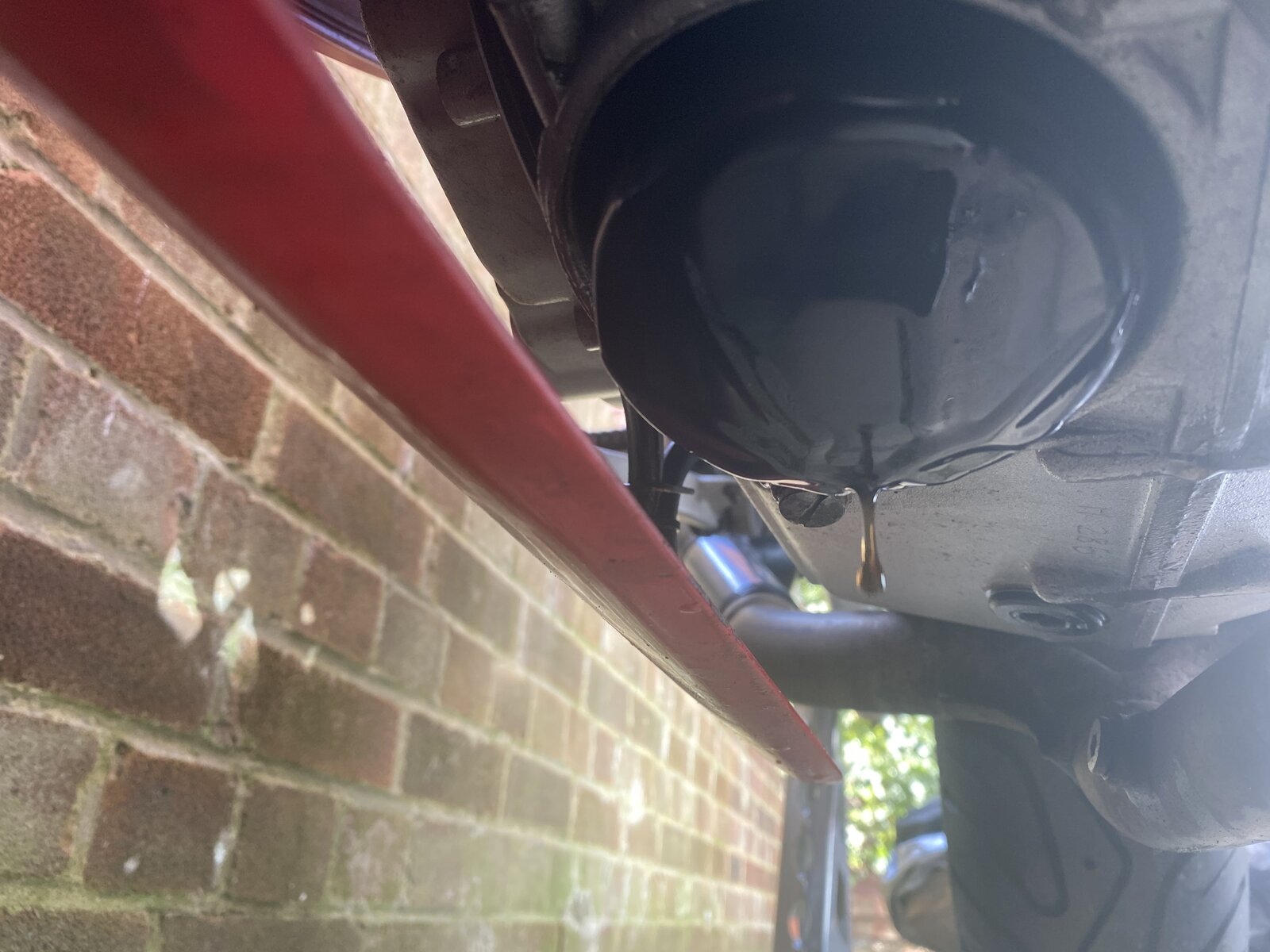

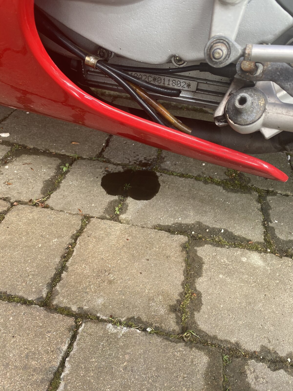

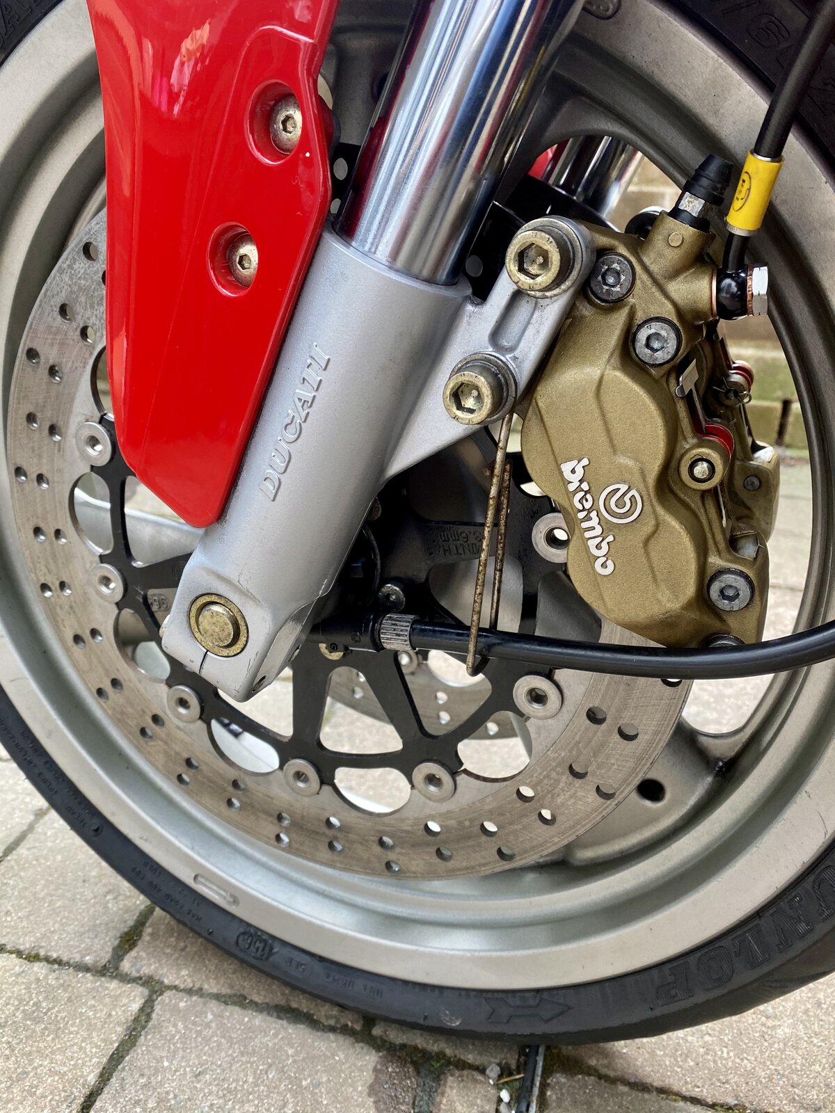

  9. @Sev the fun continues! My bike finally arrived back from the garage that was doing all the brake work. While it was there, I got them to do an oil and filter change too.
    Next problem starts! The bike fired up absolutely fine but the oils started dripping from around the oil filter! I’m hoping I just need to nip it up a bit tighter? Not that I have a tool to do it!!!
  10. ...or take it straight back to the crew that did the work, as you've paid for that filter to be tightened like that!!

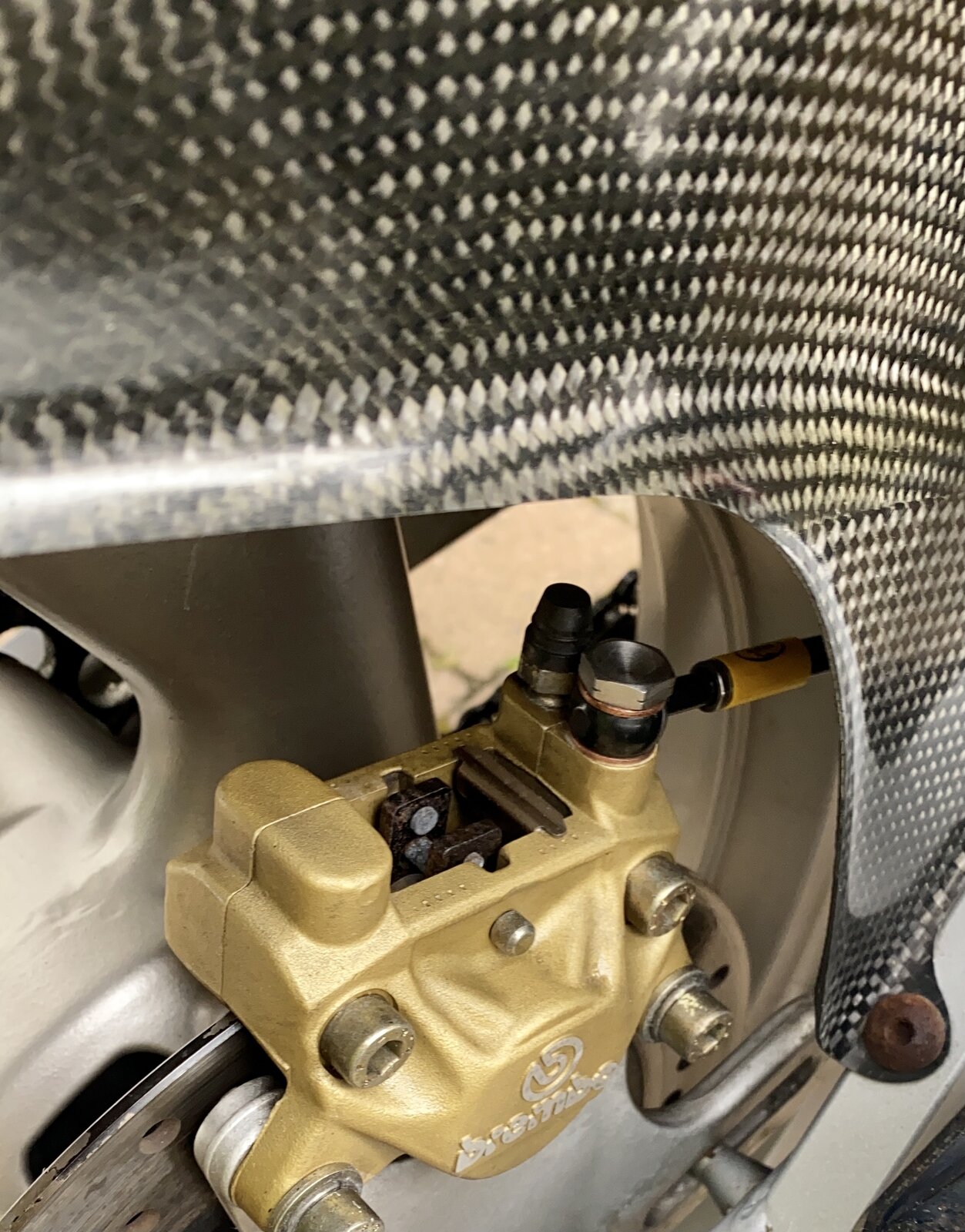

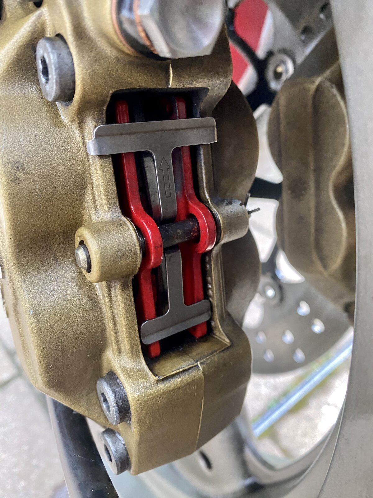

  20. Thanks for your help guys, you’ve been really helpful for someone who struggles with the simplest of mechanical things! Here are some pictures of the brake work that was done. New Brembo discs, pads and HEL braided lines...
