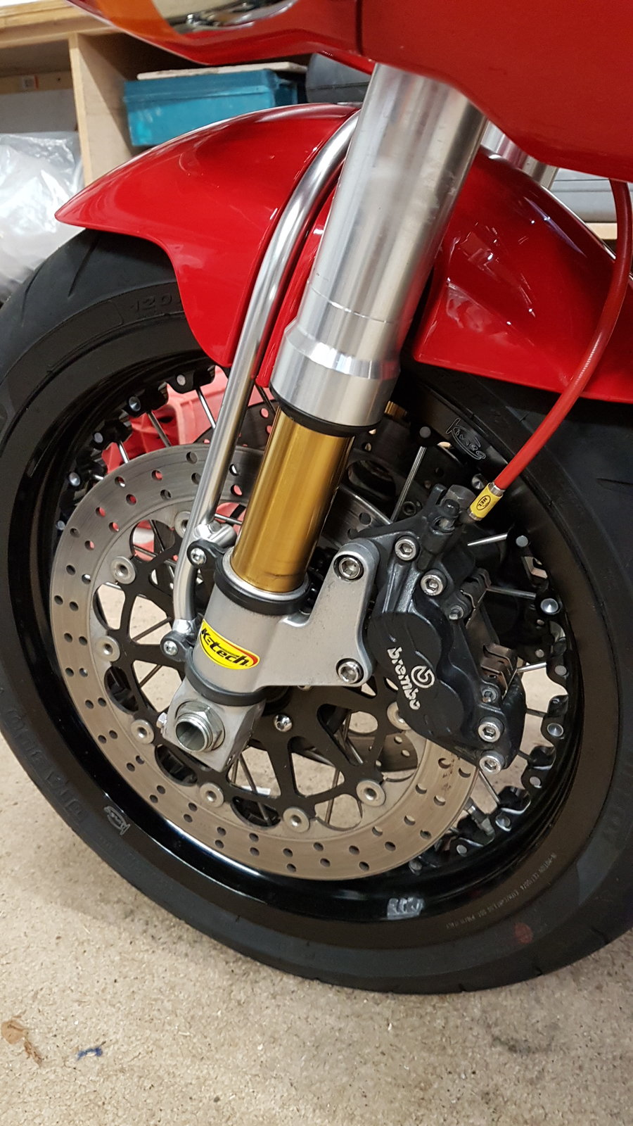

  3. I fitted new brakes and used the existing master cylinder and everything good. 20170817_190958.jpg

  9. I had to carry out some cnc work on my calipers to clear the spokes on the kineo wheels.

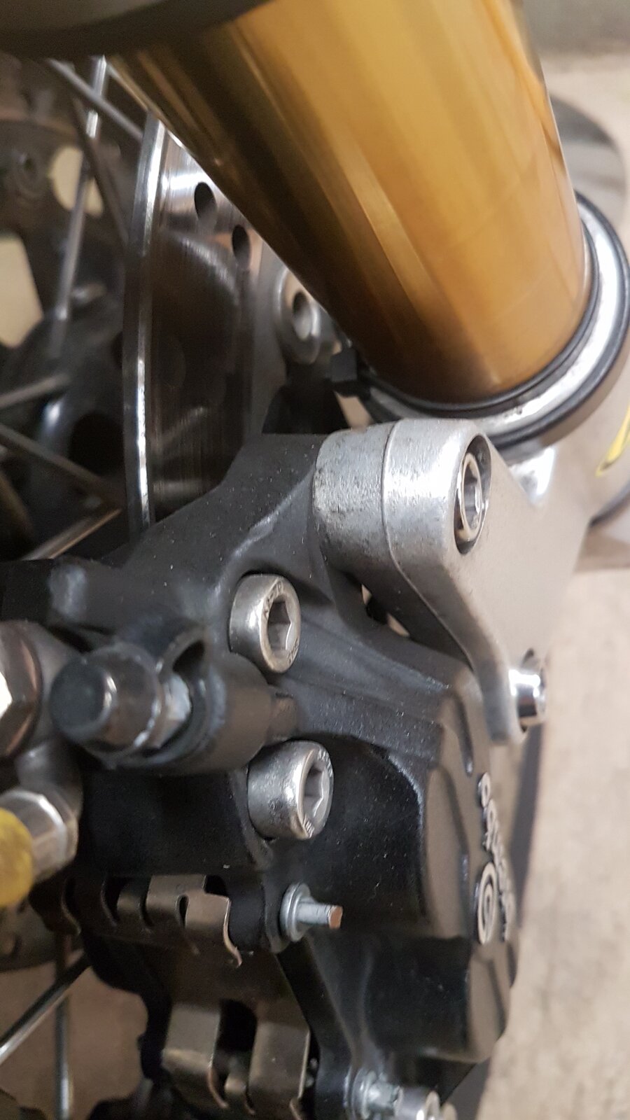

  13. To be honest im not sure, the cnc work i carried out wasnt to extreme, i will post a coupke of pictures when im near my bike.
  14. Its hard to see but the cnc work if i remember was carried out on the mounting face to allow the caliper to centre on the disk and as a result clears the spokes ( only just though ). 20191116_164821.jpg
    #15 idrinkbeer, Nov 16, 2019
  15. Out of interest was the material taken off the caliper or the fork lower?
  16. It was taken off the caliper using cnc and a skilled operator then sent away for servicing and repainting.
