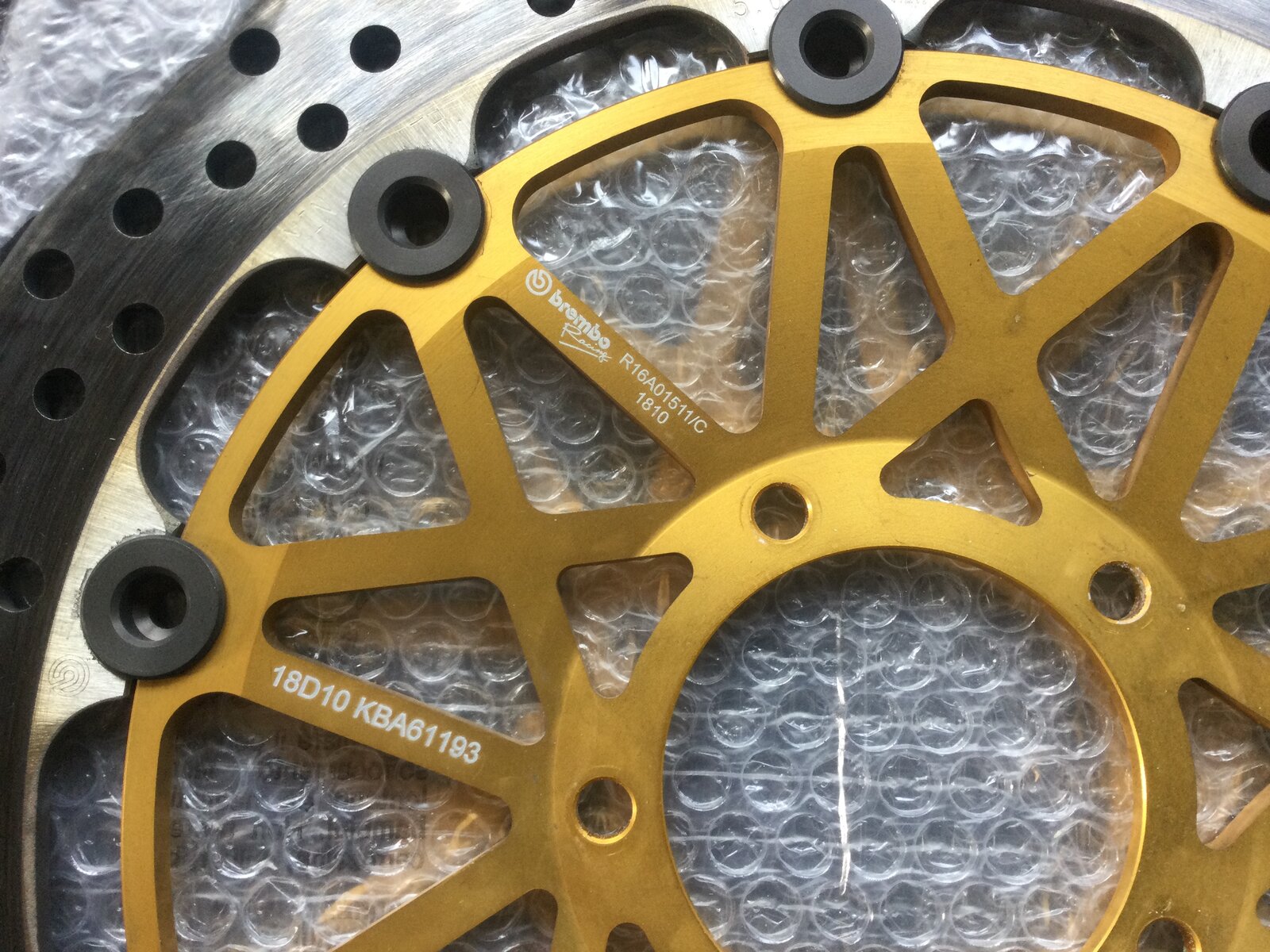

  6. Here’s the markings on my ones which are P/No 208973711:
    Looking at the eBay ones, they also have KBA61193 on them.
    As said, if they fit 1098 and are 320mm DIA, I am 99.9999% sure they will fit 749.
