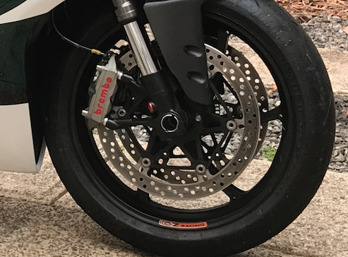

  1. I have M4 calipers on my 899 with 330mm disks, brembo pads, hel lines and the abs is disabled. It just doesn't seem to have stopping power that I had on my 1098 with this setup, It's pretty good and better than standard but thought it should be better.
    Any thoughts on maybe a MC change to give them more power? Or is this the correct way to go.
  2. Ought to be ok as is.
    What pads you using?
    Fluid?
    19mm M/C upgrade is a popular choice.
  3. Thanks mate, I have another spare set of 330 disks and have ordered a Brembo 19x20 racing master from Ducati Omaha that I'll stick on. Has had a little pulsing though the lever for a while now so see how these changes go.
  4. Pulsing would suggest disc issues.
