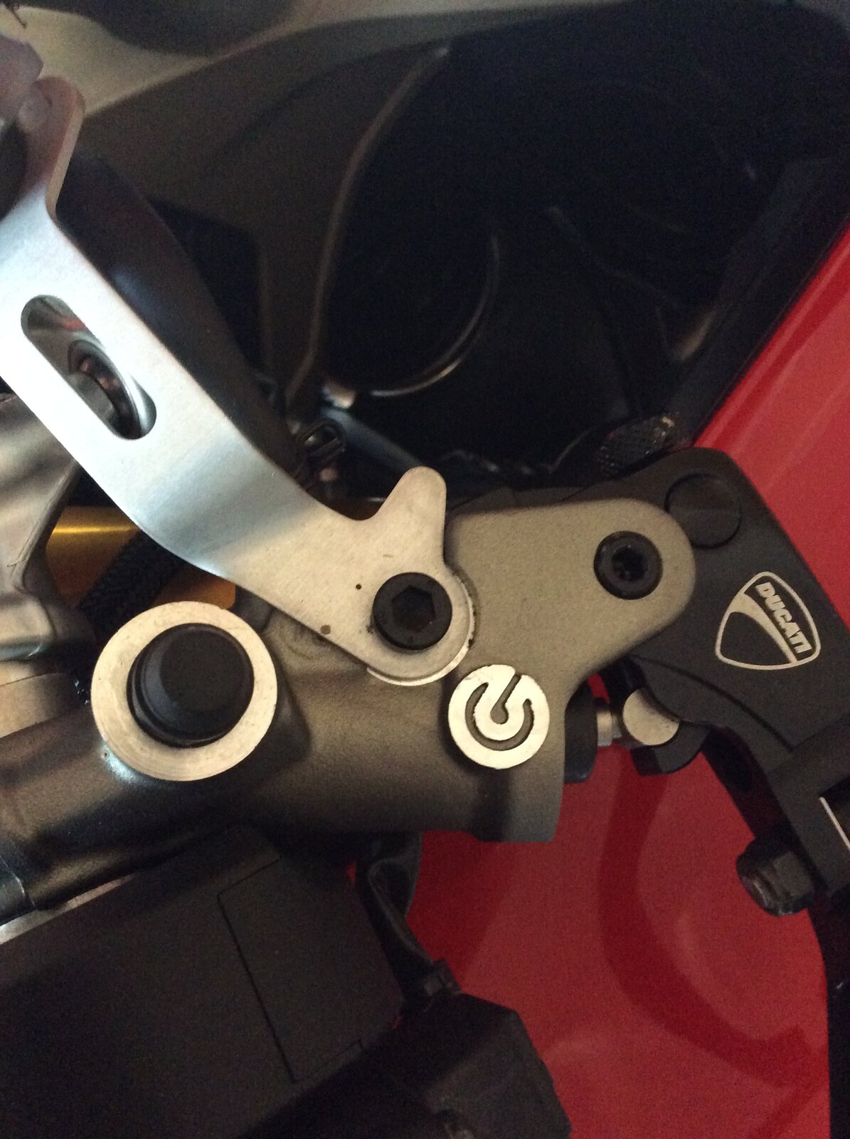

  2. From the picture of the 19RCS Corsa Corta here, http://moto.brembo.com/en/detail/110C74010, the body of the master cylinder does not appear to have a threaded hole for the reservoir support bracket used by the OE master cylinder,
    Andy

  11. More than likely, just pointed you at HPS to show you what it looked like. As andyb suggests, you could make something yourself or modify an existing bracket. The issue for me, is where to mount the bracket, a problem I have had on two incarnations of one of my track bikes. Andy

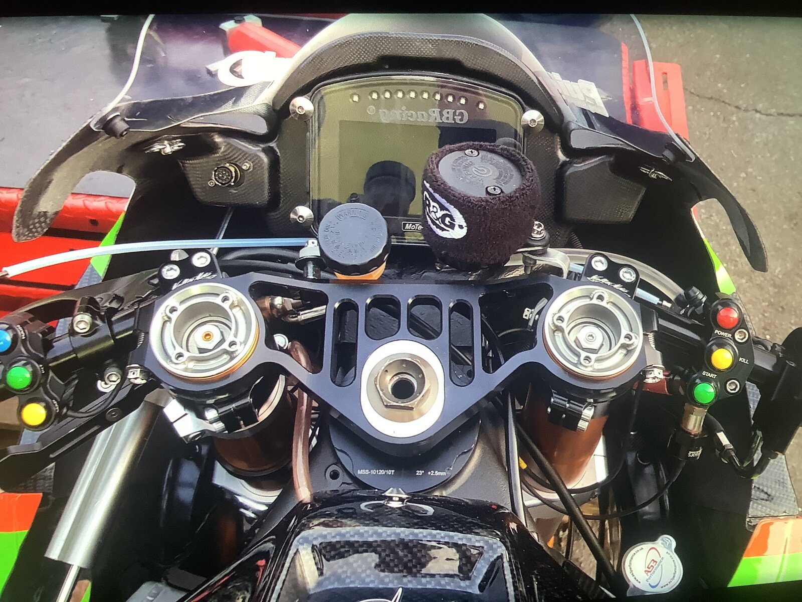

  13. Recently fitted the same unit but on another manufactures bike, Same callipers thought with same piston OD as the V4. Definitely more lever feel and modulation, but that could also be down to better brake line configuration and higher quality fluid. Make your own bracket, Or personally I would drill and tap the top yoke and keep it way neater. Just making sure you keep the level res pot above the MC...
