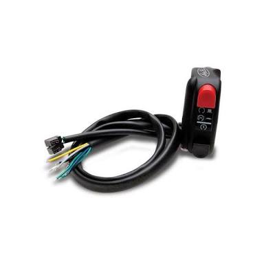

  12. ANY switch housing will work on any bike. Look at the honda/Aprilia housings, I think they are rather fancy looking and also a much thinner profile than the duc unit
    Pic because I’m nice...
    this one is by motion pro.
    Domino
    Corse dynamics

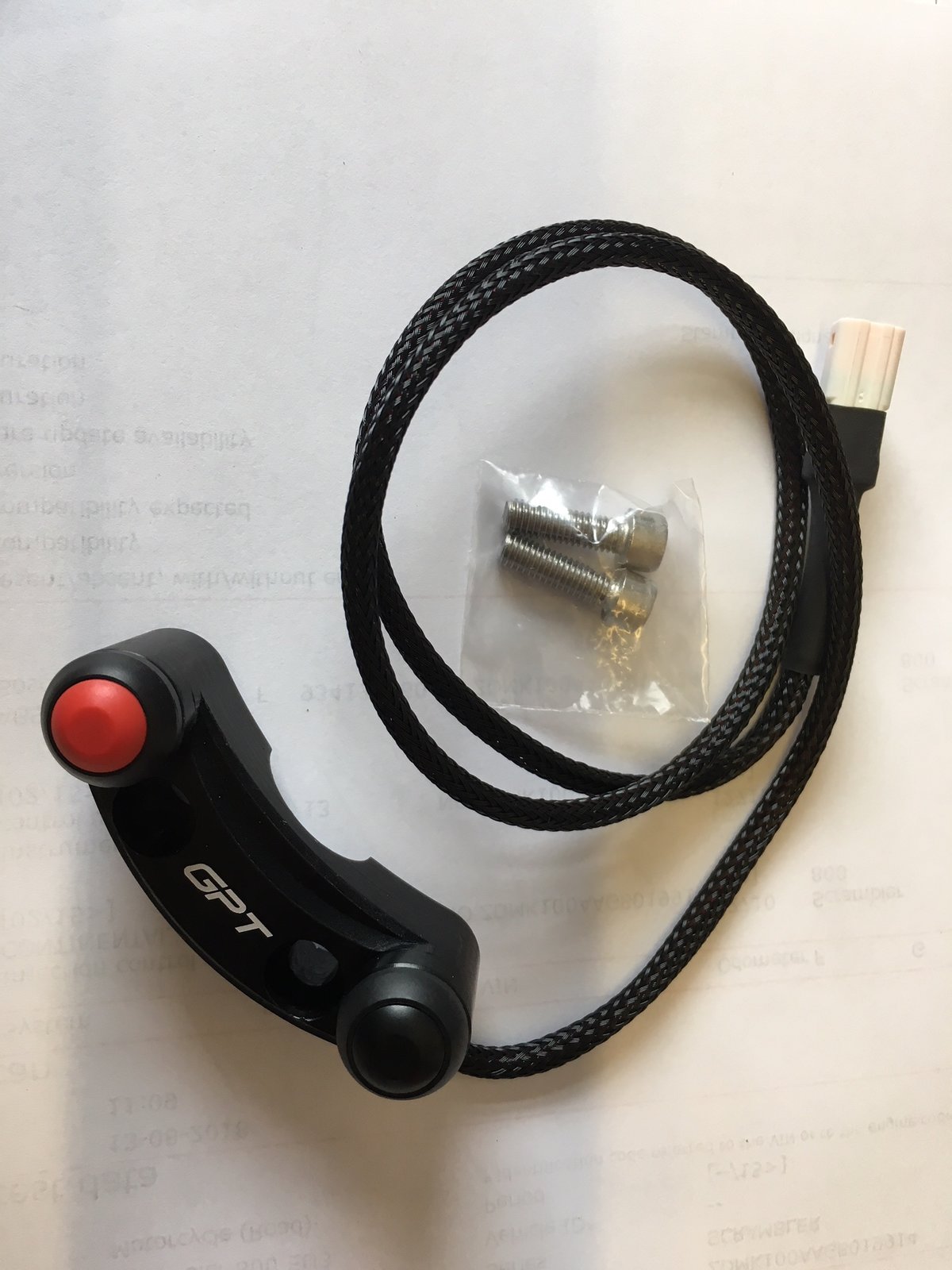

  13. These are the ones I have. Billet alloy, prewired and replaces m/cyl clamp. Red is the latching run/kill switch and black the push start. £80 inc. I don't have my bike at the workshop, but i'll get a pic of it fitted if you want one :)
  14. @nelly, are you stocking these and would it fit the 848/1098/1198 family ? Cheers, Andy
  15. Full on factory look that :upyeah:
  16. @Android853sp, yep. Got a few in but they don't fit 1098/848, or at least they aren't prewired for them. Sorry. There is universal option but it would need wiring to the multiplug.
    The ones I have are for Panigale, MTS12 (gen1 & 2), SF848/1098, HYM, M821/1200. They use the small white connector as in the photo.
