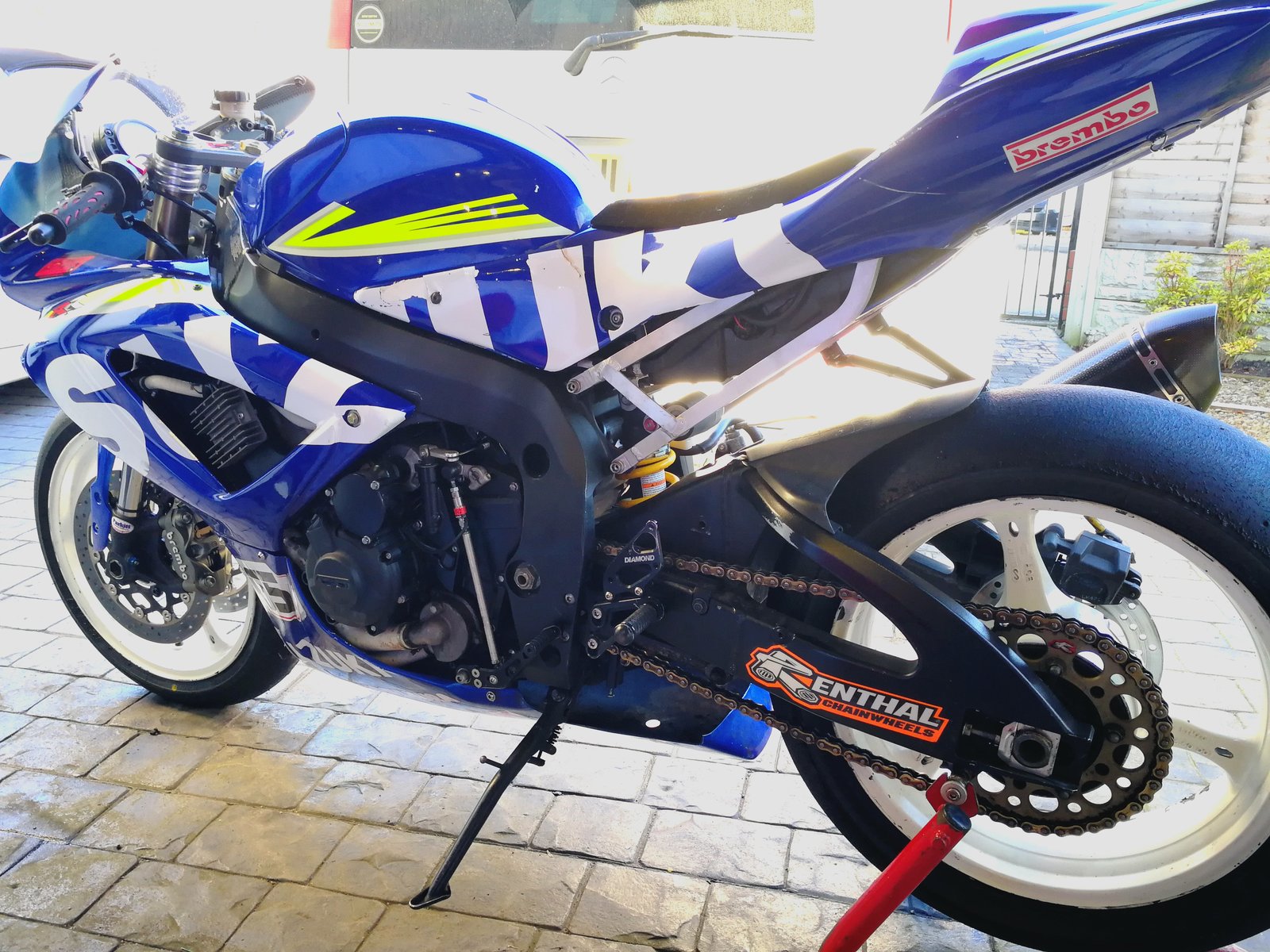

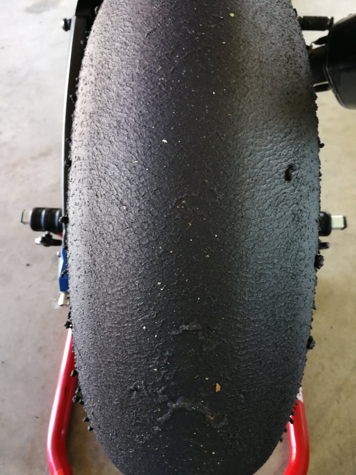

  5. The vo2 is a great tyre!
    I used a few sets last year on my GSXR750 K7 track-bike which has a 5.5'' rear wheel without a problem with the 200. And because its a tall profile, the bike falls into corners lovely. I personally preferred the medium to a soft front as gives more feedback/feel. The mediums did about 4 track-days without any fall-off in performance too, just noticed the makers had gone!
