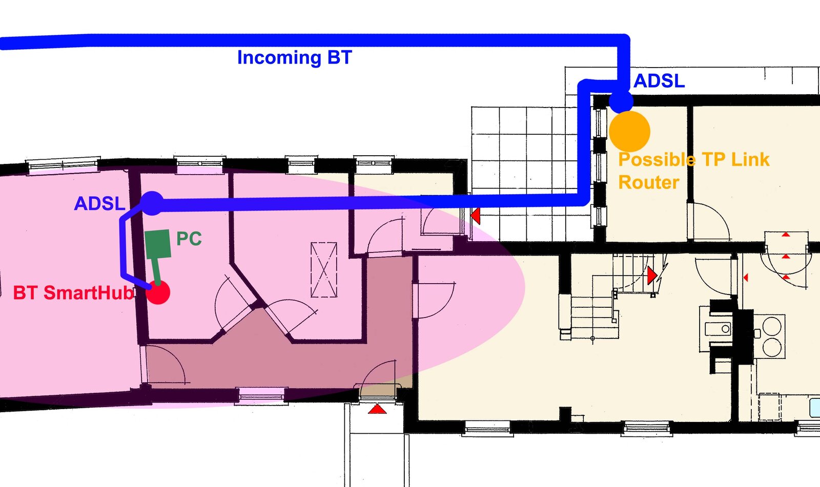

    My incoming telephone line splits before it enters the house which means I have in effect a choice of either socket both of which are ADSL in different locations.
    I have a BT Smart Hub hooked up one one socket which gives me computer internet and wifi.
    The wifi signal is not good in one part of the house and even a BT disc extender doesn't help.....too many thick walls.
    But in the poor signal area is the other ADSL socket.
    I have a TP Link wifi router spare.
    If I connect that to the ADSL socket in the poor location (just the phone line, without ethernet cable) will that give me wifi or will it interfere with the BT Smart Hub signal?
    If so, will it be two wifi networks or will the TP Link one need to recognise the Smart Hub network?
    Thanks, AL

  3. Cheers Alan.
    I can't link the two routers with an ethernet cable.....it would need to be about 12 metres long and run outside.
    I was just thinking I may end up with two wifi networks one called say, A and the other called say, B.
    That way, my Android phone could connect automatically to the strongest signal....it would also mean the TP Link router signal would be strong enough to reach my workshop.
    I don't get any other wifi here other than what I create with a router.
    AL

  11. Thanks all (and you Loz)......let me investigate what you people have said.
    Do Powerline adapters work when the relevant electric sockets are distributed on different ring mains?
    What I have is shown below......the pink area shows roughly the wifi coverage....

  16. Looking at that diagram it’s highly likely that your BT master socket is the first one as it enters the house and the one you are using is an extension.
    I would test the broadband speed in both locations and plug the BT router into the fastest - test using a cable not via WiFi.
