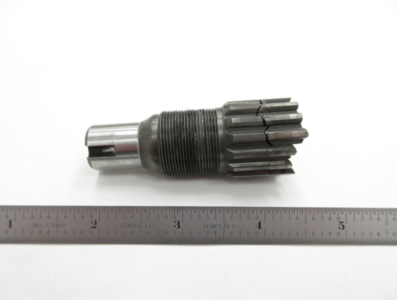

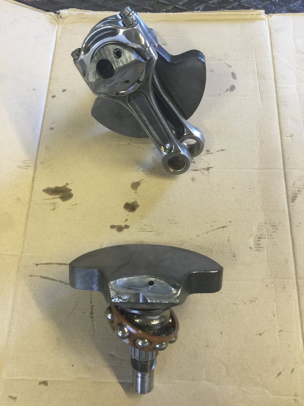

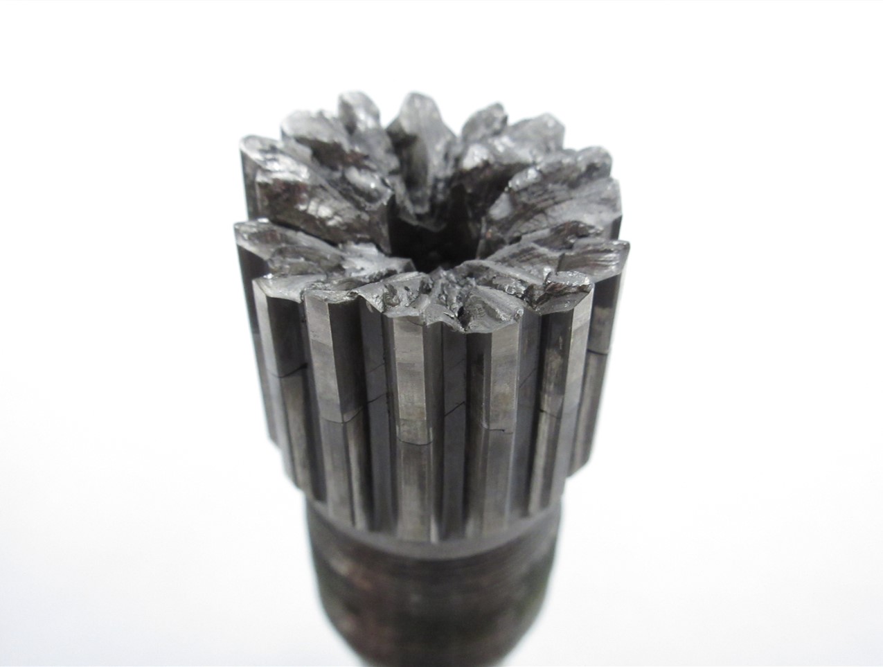

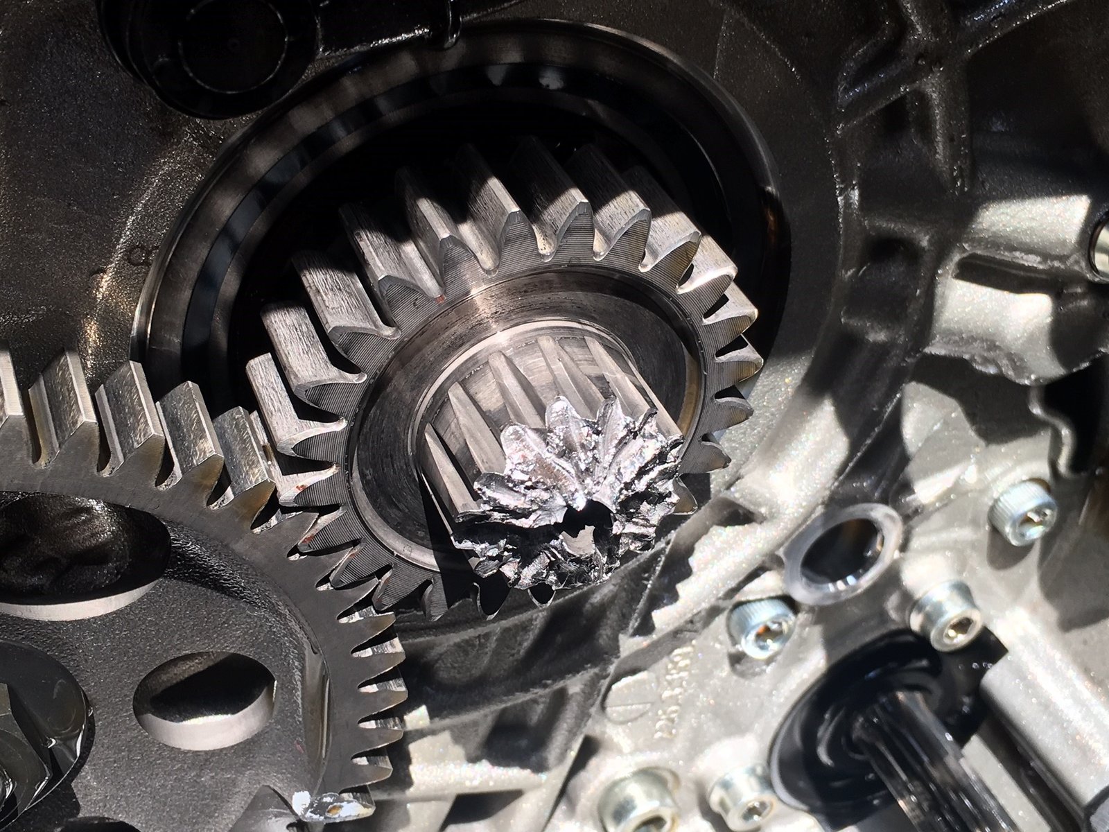

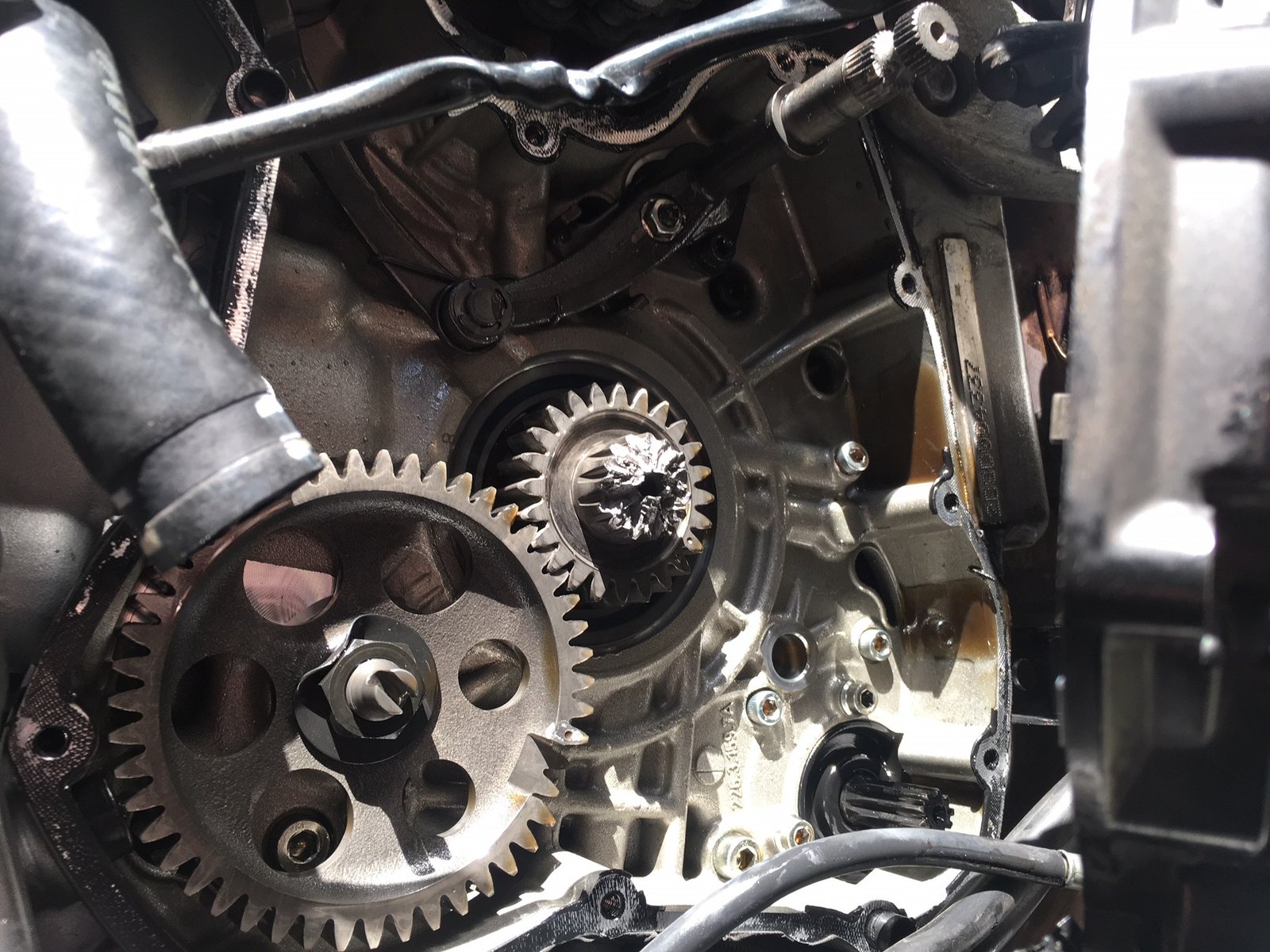

    Was just wondering if anyone else here had experienced a broken crankshaft like I did. I've heard stories and seen a few others online but was curious if anyone here has had a similar experience.
    Mine is a 2013 that i bought new, changed oil twice as often as required, and it failed with 11,700 miles (18,800km).
    My dealer quoted me $8800 USD which is only a little less than the bike would be worth. Ducati agreed to pay for a small portion of the parts required in order to rebuild but i'm still going to be out a ton of money for something that likely failed due to a material defect... When i asked DucatiNA customer service what happens if i could prove it was a material defect (I work for a failure analysis lab at a major aerospace company) they actually told me that this might be part of the reason they came up on their offer... Also explained that this offer was better than most for this type of scenario. I'm assuming they mean when a bike is basically totaled, value vs cost wise, due to a material defect.

  6. John your crank failure looks like the main bearings giving up too, in the picture it shows tremendous wear on the bearing ring, was this the same for the other side?
  7. Op looks based in states, consumer laws may differ :upyeah:
  8. Mine were the same. They couldn’t determine exactly which went first but they basically said either way it was manufacturing fault and they even went as far in the independent report as to cite the main bearing failures as a not uncommon occurrence amongst Ducati.
    It was either accelerated bearing wear due to contamination and excess movement from the broken shaft, or the excess movement from a knackered bearing broke the shaft. They thought the former as the shaft should be able to stand up to a bearing, at least while the engine is rideable.

    I am going to change the big end shells, but now I have seen these pictures I am tempted to change the mains as well :confused:
    I would be interested to hear what your bikes were running like when you took them to the dealers. I assume they were both running, just noisy ?
    Mine was running OK, but was smoking a bit due to scored bore.
    I know of one other (twin spark) that needed new mains at 27k
  11. Hi all - I'm appauled by these pictures. I've owned countless bikes and I'm a real stickler for service intervals and not abusing the engine. Never had an engine problem with some bikes getting over 100,000 miles on them. If a Ducati can't manage 30,000 miles without a crankshaft then I'm worried !! Sorry
  12. I can't believe that Ducati are running ball bearings for the mains in a 150 hp motor. I just assumed all modern bikes ran roller bearings or shells.

  14. Topbox, many bikes have caged ball race mains and not rollers. They tend to use rollers for the gearbox shaft (as the Multistrada does).
