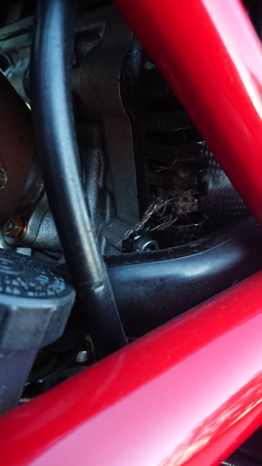

  1. Was overtaking a car and changing up a gear when lost power, then noticed the oil light on, pulled up and noticed what looked like cotton on the engine... Then noticed threads coming out of the belt cover.... F#@king HELL.... Very disappointed as they were done at a maindealer in March 2017 750 miles ago....rang a few times asking for the service manager, and emailed him politely asking if they wanted to investigate and have a look since they havent been on that long, and that I work in the motor trade, and would like to know if this happened to a car one of my techs had worked on. ..... Still awaiting a reply (a week now).

  2. Not good. Have you opened and had a look?
    I'd check the tensioner has been rotated the correct way.
    I'd be on the phone daily too.
  3. As above, have you had the cover off for a look? If it broke, your bike would be in bits...maybe something has got in there, caused an obstruction and split the belt? Could be lucky escape.

  13. Picture attached

    Hope that isn’t a crack in the casing, just above the Allen bolt.

    Picture is tough to see, but could it be debris from the outside attached to the cover? Personally, I’d have the cover off, you could record it’s remov, ASAP so I could see what could be the issue. Better than sending it back and they remove and find all is good :)
