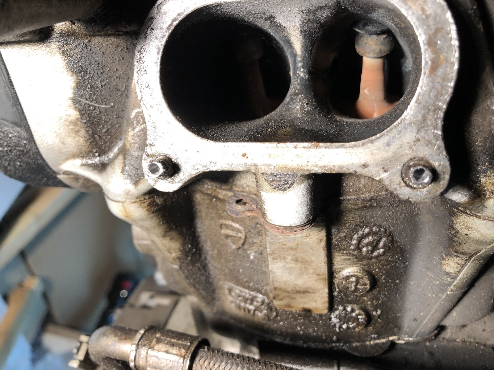

  7. I know this is an old thread, but it’s one that’s perennial. I’ve a 2016 Mutley 1200 S. At just 2 years old I won an arrow decat pipe on fleebay & tried fitting it at the weekend. I can’t believe how bad a lot of the fixings are. It’s like they are made of toffee. Despite being my daily commute I never put it away wet. It’s also been sprayed with ACF50 annualy. Anyway a bit of heat & lots of lube most of them came out unscathed, until I had to remove the front header. Stripping 2 of the 3 studs in the process. Several evenings later after Mapp gas & extractors failed to budge either, I drilled a 5mm hole about 18mm deep as close to the centre as I could. Ive managed to tap a new M6 thread down each stud but have run off centre a little on both. The thread is sound & is able to take a bolt up to torque. Ive ordered some titanium studs & nuts in the hope they don’t corrode as bad. I’m hoping I’m not too far off Centre otherwise my header won’t go back on. Just hope the pipes worth all this stress

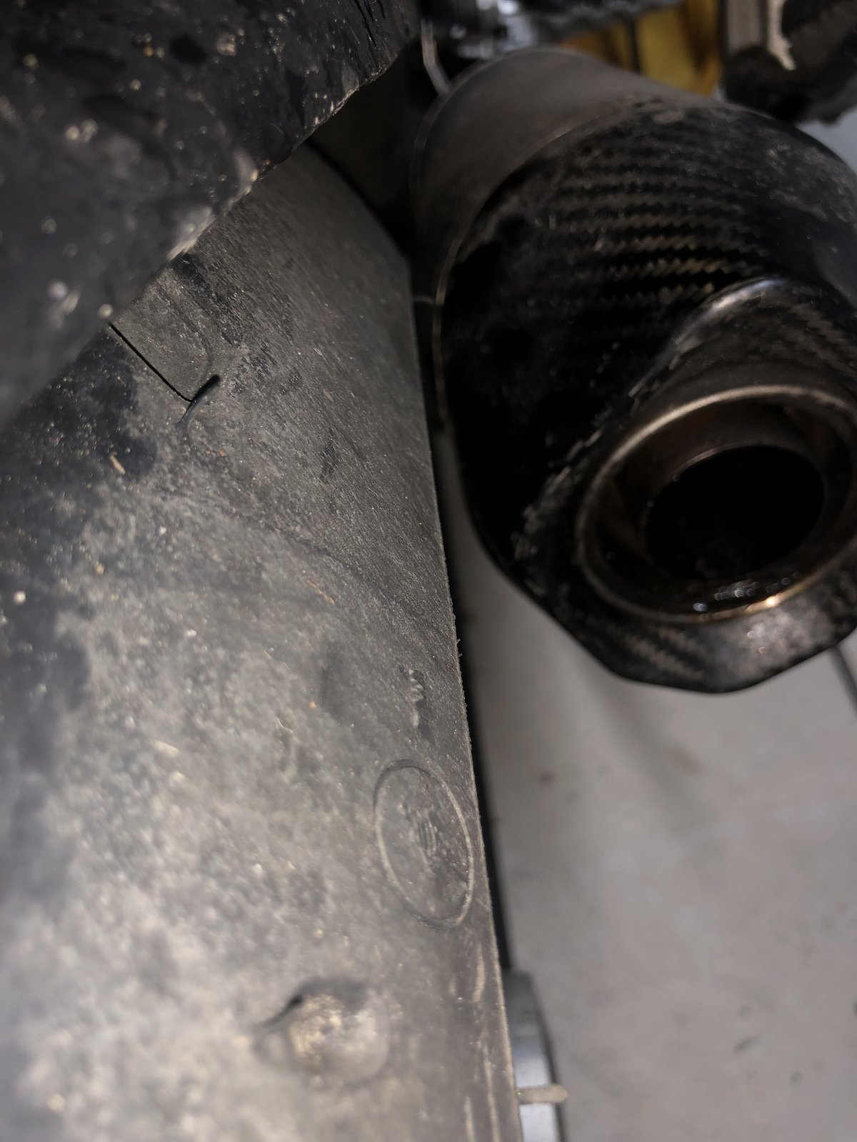

  13. Well I've just got back from a short test drive & am well suited. Titanium nuts & studs in place & holding up well. I did have to bore out the exhaust flange holes a tad due to my inaccurate drilling, but all torqued down & no leaks. The pipe sounds real nice so it'll be off to work tomorrow with a big smile on my face. The only slight gripe I have with the fitment is that the end can is quite close to the rear wheel & swinging arm. there's only around 5mm clearance & I'm wondering if this is ok or have other folk on here packed it out somehow. I don't know how much these pilot road 5's grow at speed (width wise). Any ideas gratefully received :).

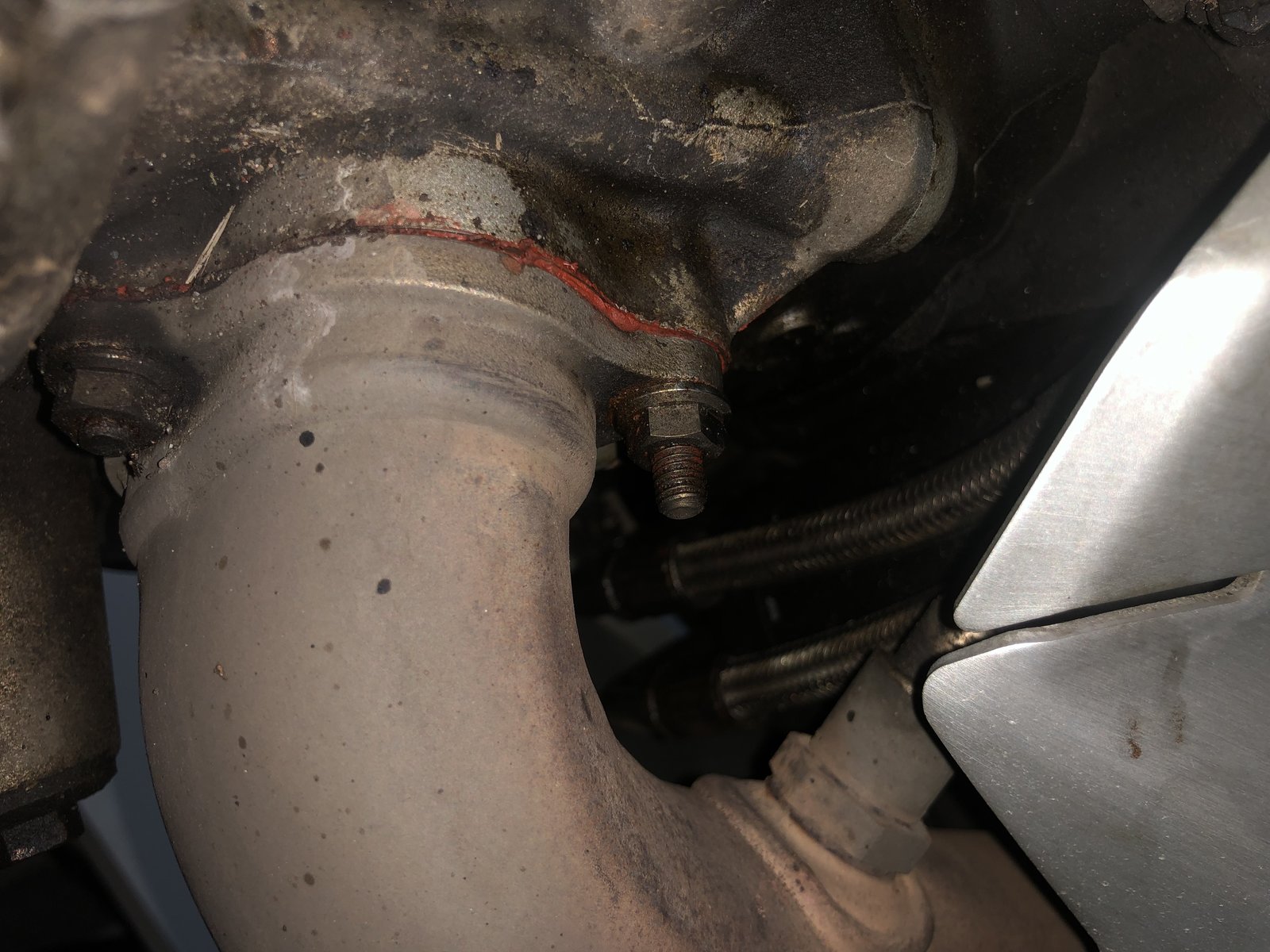

  14. Bit embarrassed about how mucky it all is, but I've just been out to test it & the heavens opened on me :(. Used a bit of red hermetite to make sure were sealed. You can see the small clearance from the tyre. The swing arm looks even tighter.
