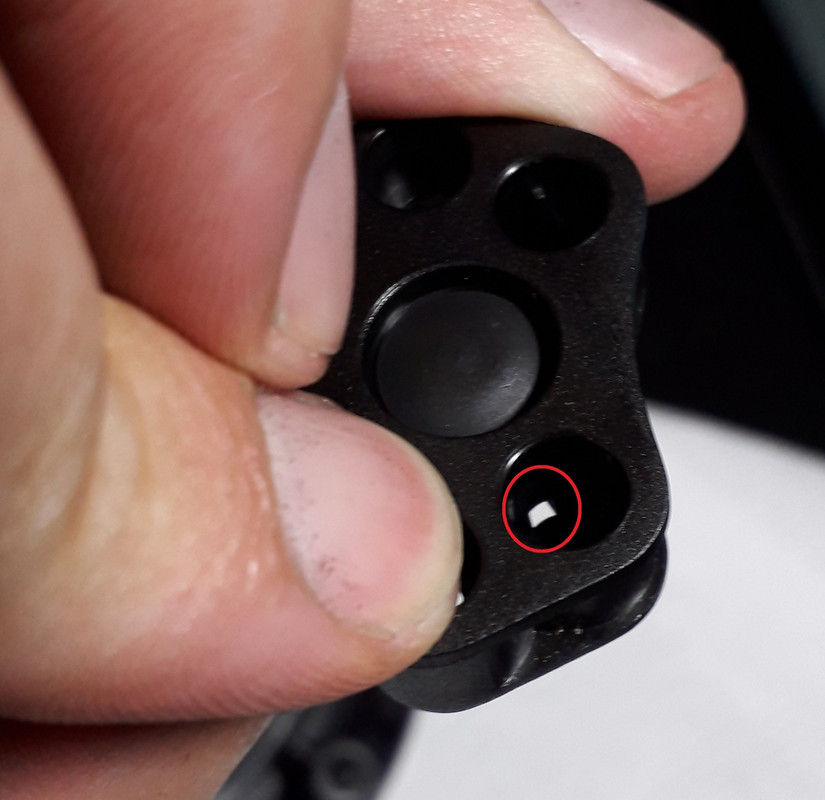

  1. Pictures first
    [​IMG][​IMG]
    Than I opened it, but I dont remember if this is the right place of the tiny thing going on in there as well
    Its not my fucking day.
    It happened as I was preparing the tank cover for wrapping, the gascap somehow went lose and in the process of trying to pry it back in the hole, I broke that part.
    Now I know how you fit the cap back in the whole, but meanwhile I'm stuck with a broken hose connection to wich I dont know what the function is.
    Must be important since it has a small ball, a spring and another cylinder piece....
    And on this exploded view the gascap only comes as one fucking unit of +200 euro's
    https://shop.oemducati.com/en/products/multistrada/2015-1/multistrada-1200-s-1/fuel-tank--13
    I couldnt find the piece seperately....
    Am I fucked and obliged to buy a whole new gascap unit?
    Keyless I dont trust and if I would buy the key version, how can I still use my key? the lock mechanisme can be swapped out?
    thx

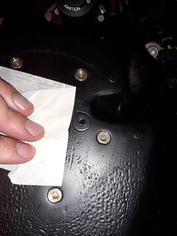

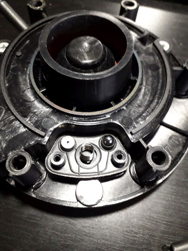

    There small whole in the actual gas tank that lines up with another small whole in the gas cap.
    Both seen here.

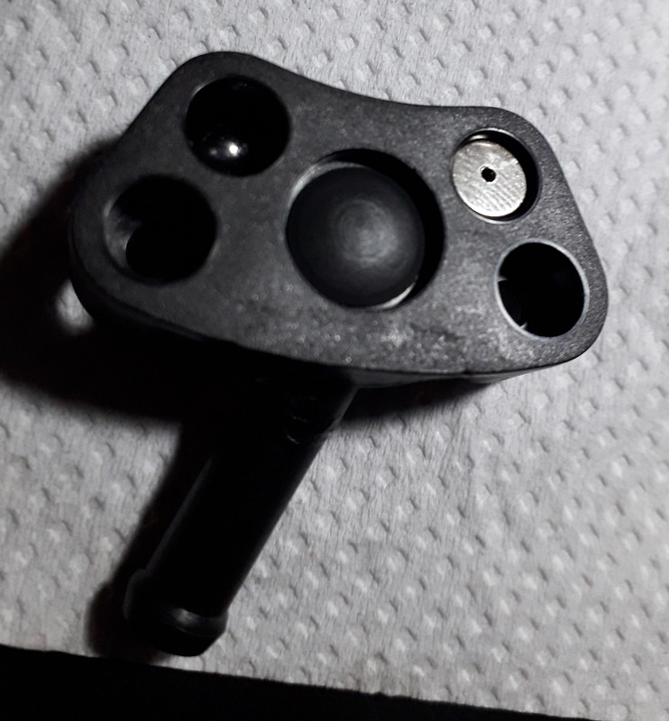

    The fumes first go pass a ball
    The ball fits in a space with some tabs that make the ball sit center
    The opposite space, therein goes the spring and the metal circular piece with a whole in the middle
    after the fumes passed the metal ball, they go underneath into a kind of hallway

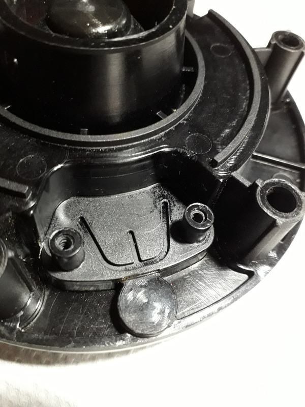

    As you can see there are 2 paths.
    First leads to a void it seems, and I guess when this is full, it goes to the last one, wich leads to the space with the metal circular piece with a whole.
    That space also has a whole on the other side, seen here
    That whole looks like this on the outside
    Wich is where our tube is located....
    The whole space is coverd up with the rubber piece that seals the gascap with the hole in the gastank

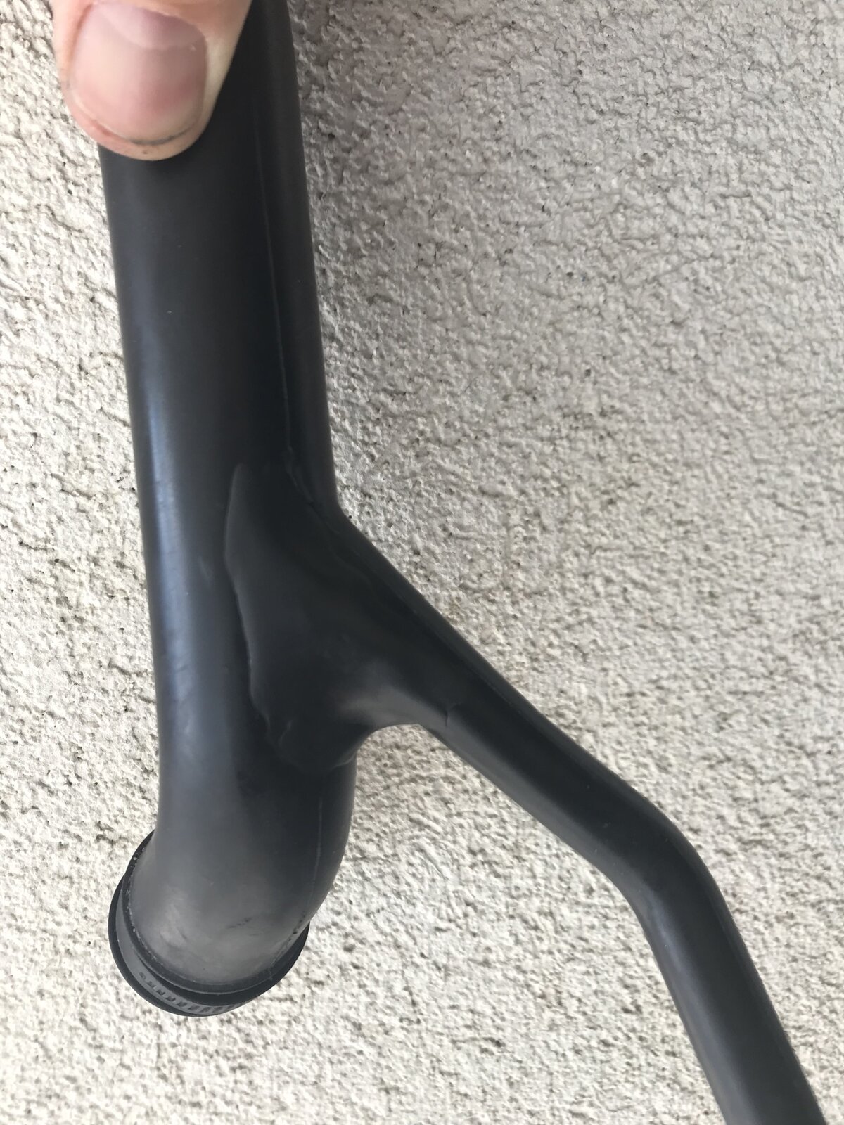

  15. quick update, fixable, I used a combination of sugru and superglue
  16. You sure wo
    Wow, nearly 3 years to fix it! You sure work slow.

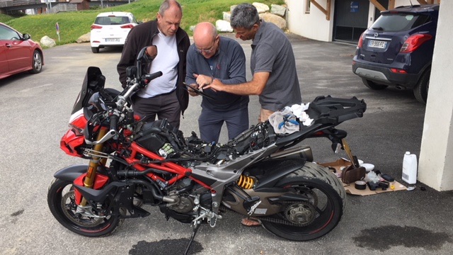

  17. Great stuff Sugru, we used it to repair the Y shaped hose on a coolant leaking Multi in an alpine hotel car park before the EMM a few years ago.
  18. Or you could see it like this: fixed it, and gave an update 3 years after the fix how well it held up...
