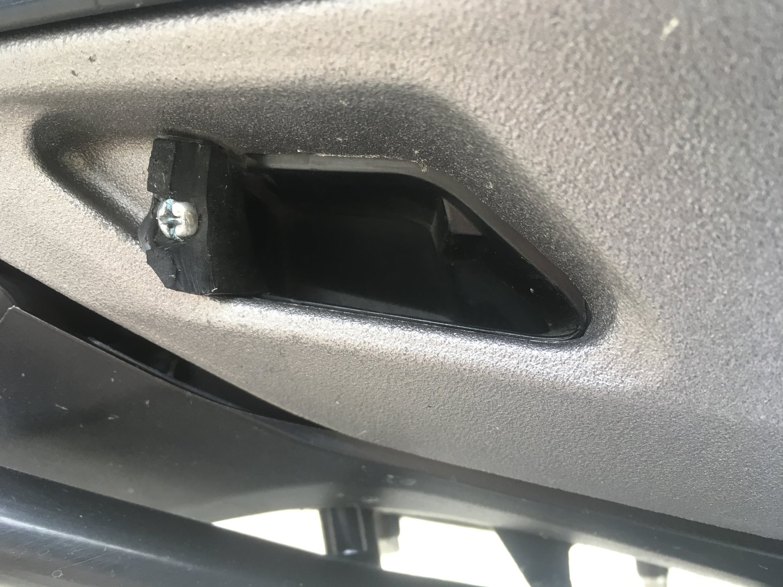

  15. When I bought my DVT with no panniers, the lugs had already been broken off unbeknown to me. When I put brand new panniers on, I was not diligent enough to realise the problem as they break off so clean it is not obvious. Anyway, one pannier cartwheeling in my mirrors later I found out all about it. I repaired it with some very dense rubber, very carefully shaped and held in place with one small self tapper carefully applied and some black silicon to take up the gaps and support the whole plot. Since then I have done no trips, so can't tell you how well it all works but will attach a pic.
