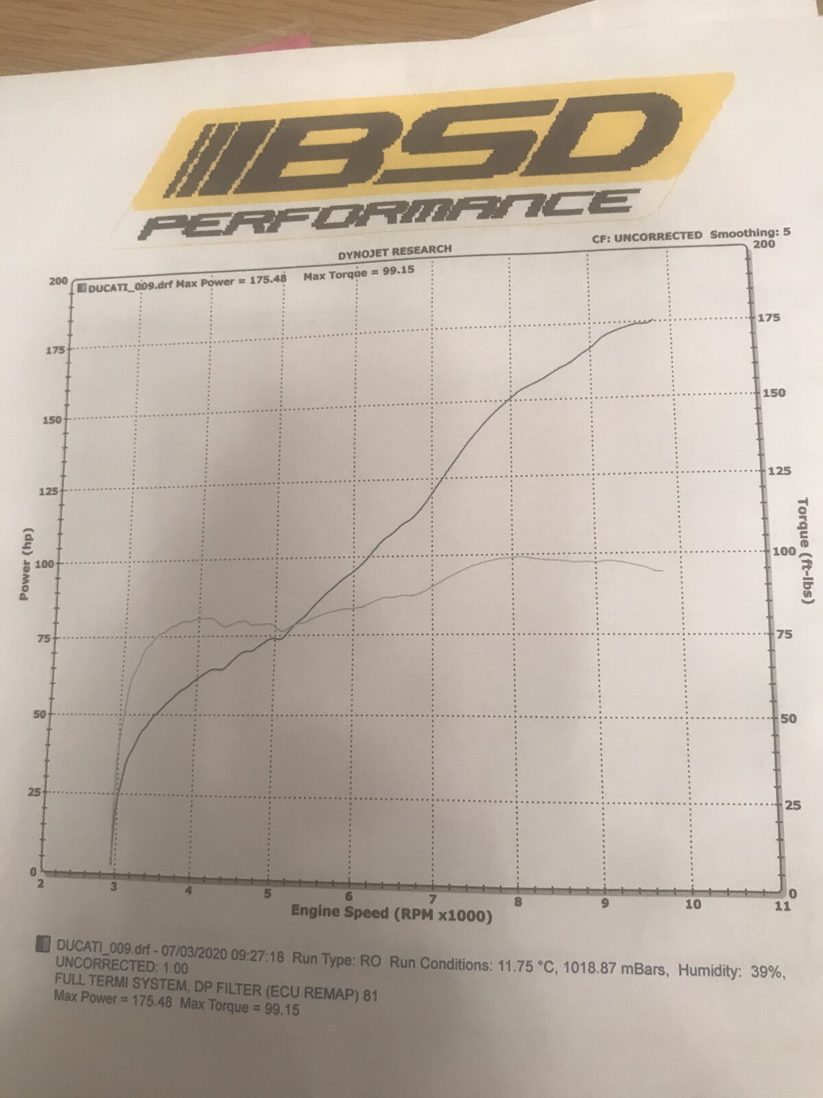

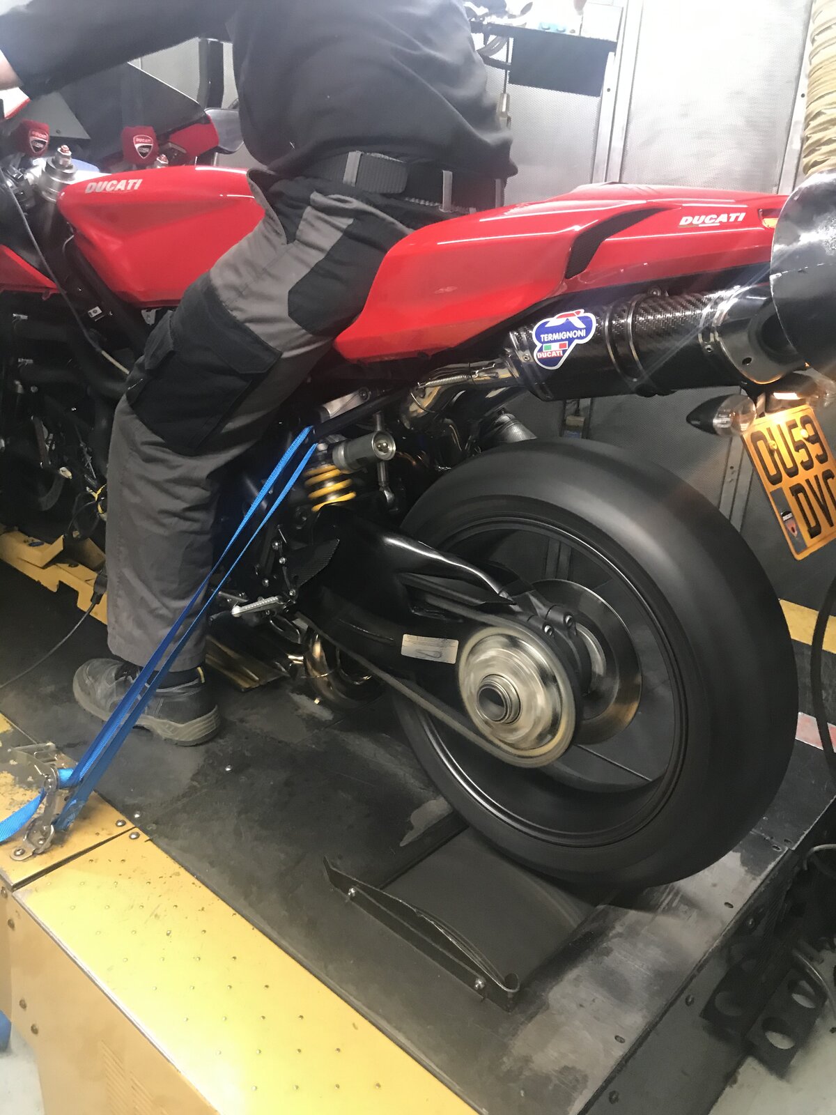

  10. I had my 1198 remapped with full 70mm system termi slashcut on by bsd last weekend they also changed my belts at the same time they got 175 bhp and smoothed throttle response out turned of all emissions and top speed limiter off fantastic results great guys I can’t fault them
