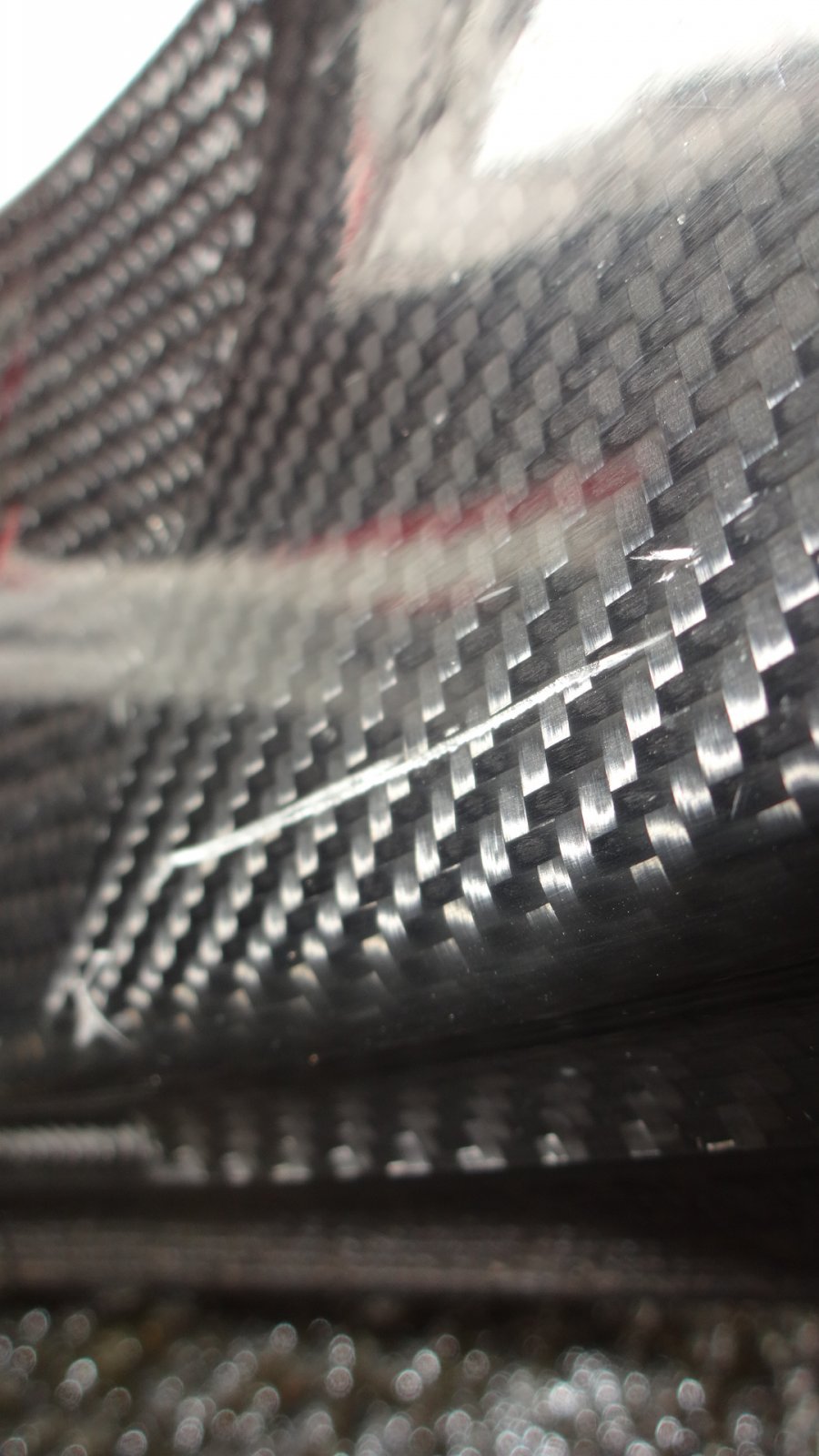

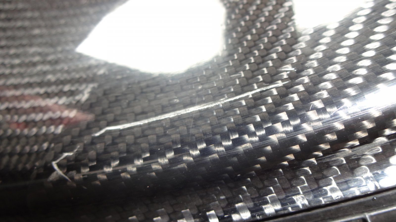

  1. As you can see I have managed to scratch my rear wheel. Any ideas on how to get rid of it whether its by my own hand or a recommended company ?
  2. That looks like its only the lacquer layer
    Try wiping it over with a drop of a clear, light oil, olive oil for example, that should make it invisible instantly
    Obviously that's just hiding it, though.
    There will doubtless be ways to spend hundreds of pounds, or many hours, but I can't help you there
    Good luck
  3. If its not too deep re lacquer with a fine paint brush just in the scratch If you can getting a small amount on one pack lacquer from a body shop or even clear nail varnish will do the trick
  4. There's a 'How to remove scratches from Carbon Fibre' section in today's MCN - de-grease, wipe with white spirit, followed by rubbing horizontally (?) with 240 grit and lots of water, wipe with white spirit, followed by 1000 grit and plenty of water, wipe with white spirit, dry, then clean spotlessly with tack cloth and finish with 3 coats of clear lacquer aerosol
  5. Fill the scratch in with lacquer, allow to dry and harden 48hrs and then cut it back with G3 (you can buy it from your local car paint factors) i had some scratches on the bst wheels i brought and this is how I sorted em and now there like new. I used 3m finesse to polish up.
