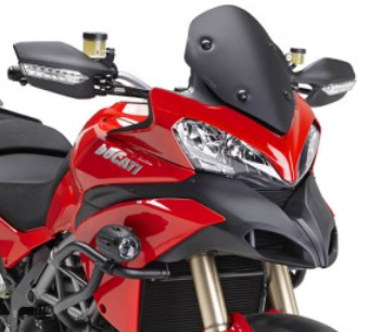

  7. You may need one of these:
    Givi Screen Ducati Multistrada 1200 2013+
