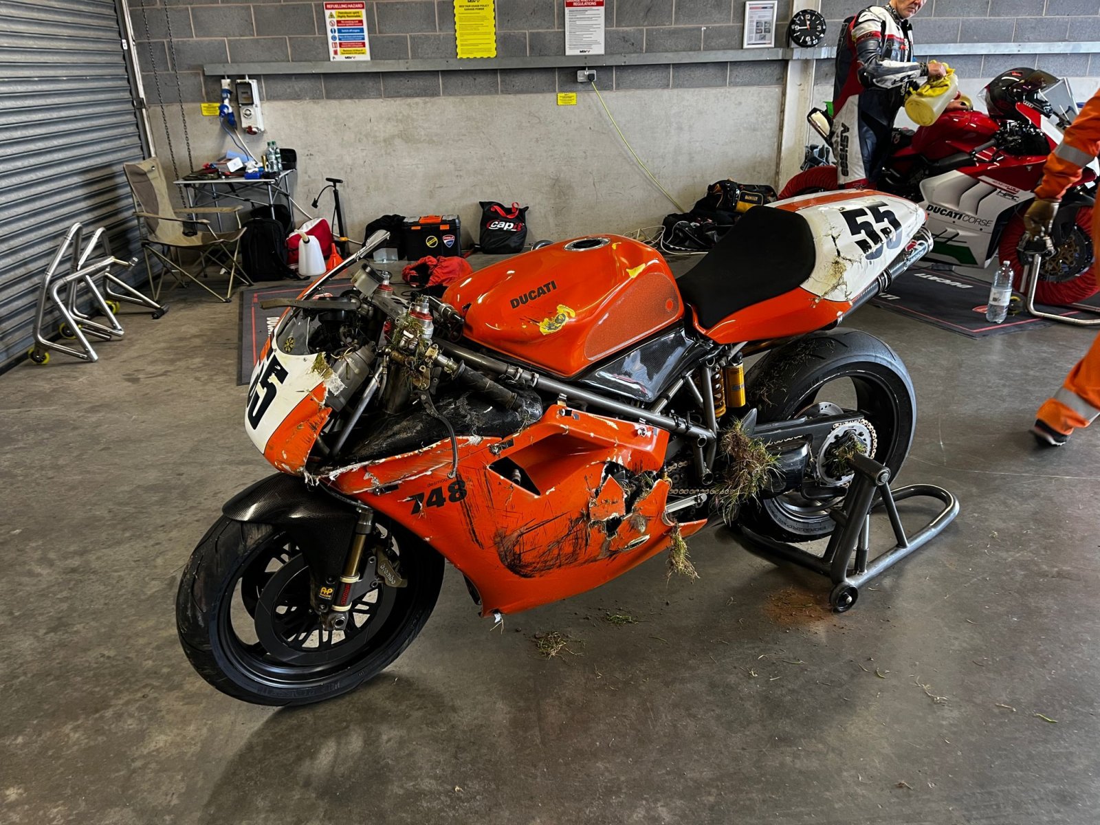

  2. The old bikes crash well, I never fitted crash bungs as the bikes slide on their side, i was always worried the bungs would catch and flip.
    Revs depend on rods, with rs rods mine go to 11k, but not for long.

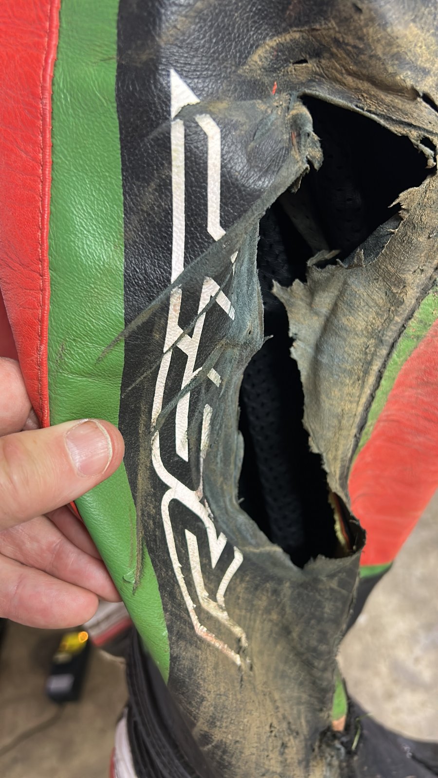

  3. They do crash well.
    Leathers did not so so well.
    This was my offering to the Craner Club membership committee last May.
