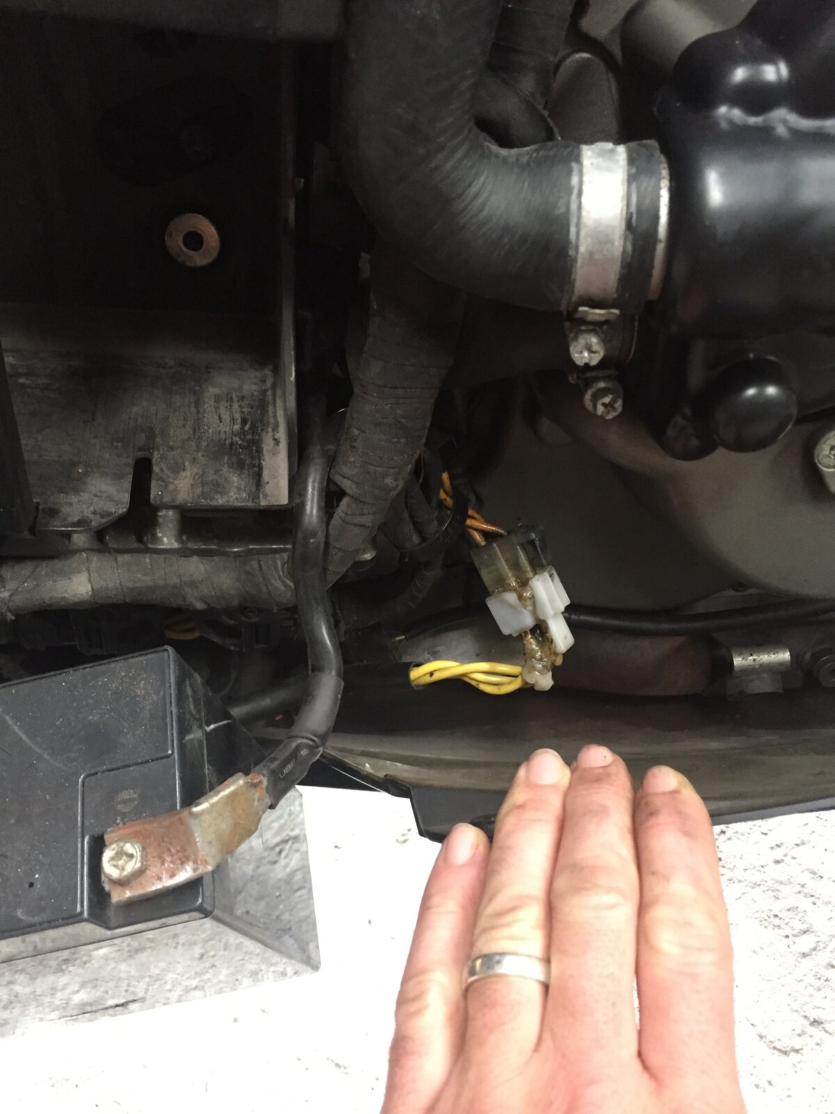

  1. 43CE9C20-28E8-4E3F-9559-54D96C799B93.jpeg 00345F74-0EA9-4EE2-B747-FF66AFBEE217.jpeg 79627C0D-6103-4359-BF77-41E9E8412EFE.jpeg Hey Guys
    Need a bit of advice please!
    I was out trying to fit a carbon surround for the ignition and dropped a spacer into the fairing so of course I had to remove the right hand side fairing to try find it. While searching I found a connector close to the battery which looks dangerous to me, I have no clue about wiring but I take it the bike is not safe to ride, so any advice is appreciated.
    Cheers

  3. Thanks for the reply, wow I hope it’s not as bad as you mentioned nearest decent Ducati Mechanic is 200 miles away. I’ll see if I can find any further damage but I have no experience with wiring looms so it’s gonna get messy or expensive by the sounds of it. o_O

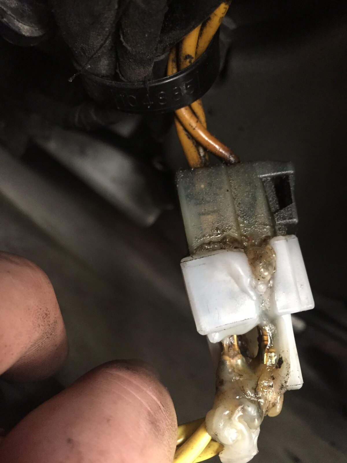

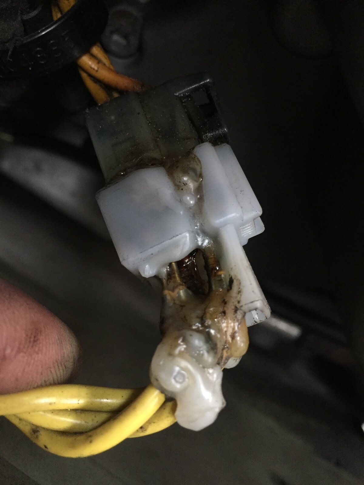

  4. That's the alternator output connector. Could be an indication of reg/rec failing.
    • Agree Agree x 4
  5. Not an unusual occurrence with an older Ducati. The 3 yellow wires are the output from the generator. That connector will be the regulator/rectifier connection which commonly, if the reg/rec fails, melts. Plenty of posts on here for the way forward. Search ‘shindengan’ and 1098R posted by Roberano. Andy

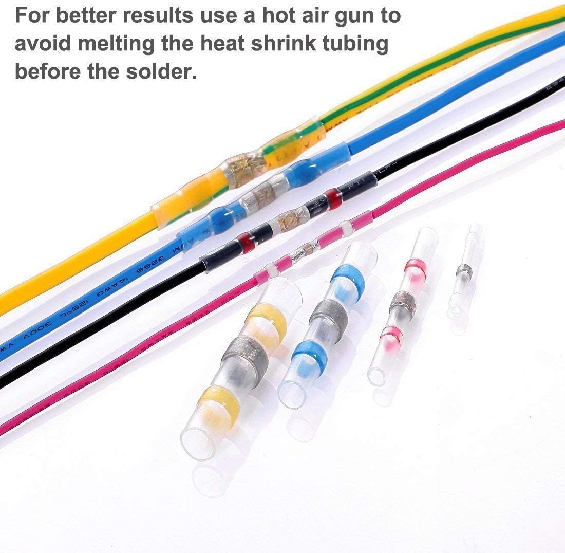

  8. #8 AirCon, Oct 9, 2020
  9. Oh I like them AC, as I've become old and decrepit my soldering skills have deteriorated, these will be a godsend! :upyeah:
  10. That's already been "repaired" once. The lighter plastic isn't original. Could have been a mismatched part to start with and that's not helped the connection. Always replace in pairs if you can't get the exact matching part.

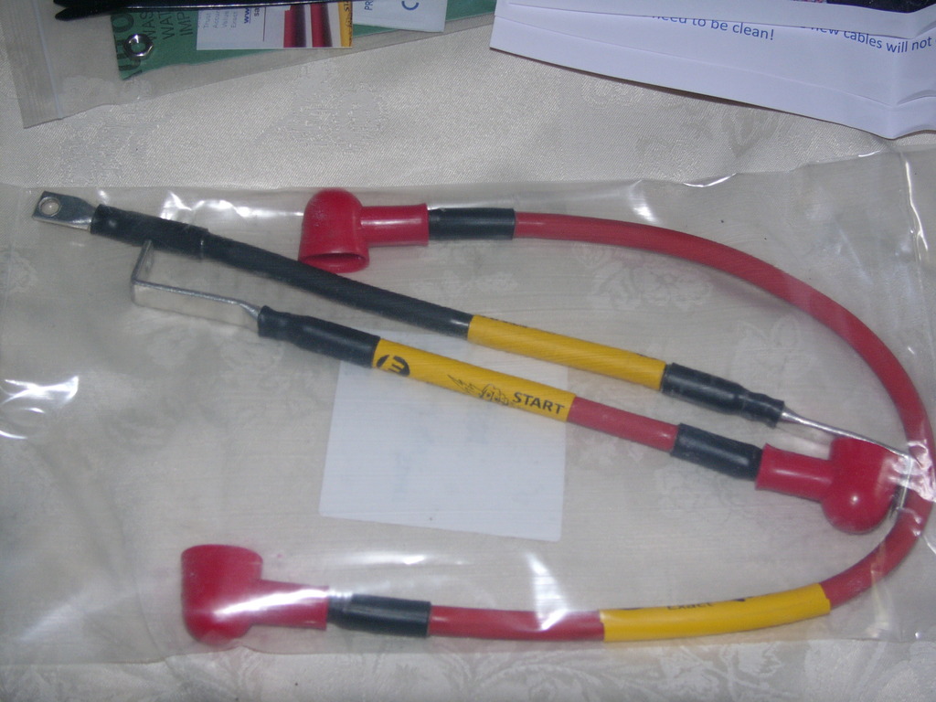

  11. yea it definitely looks like two odd connectors. I’ll purchase what Aircon suggested and the battery upgrade cables, I found this one on fleabay it’s what I need correct? Price looks right?
    https://www.ebay.com/itm/ES-04-Ducati-Hi-Cap-Electric-Upgrade-Cable-Kit-848-1098-1198-/112007535502
    Thanks again for all the help :upyeah:
