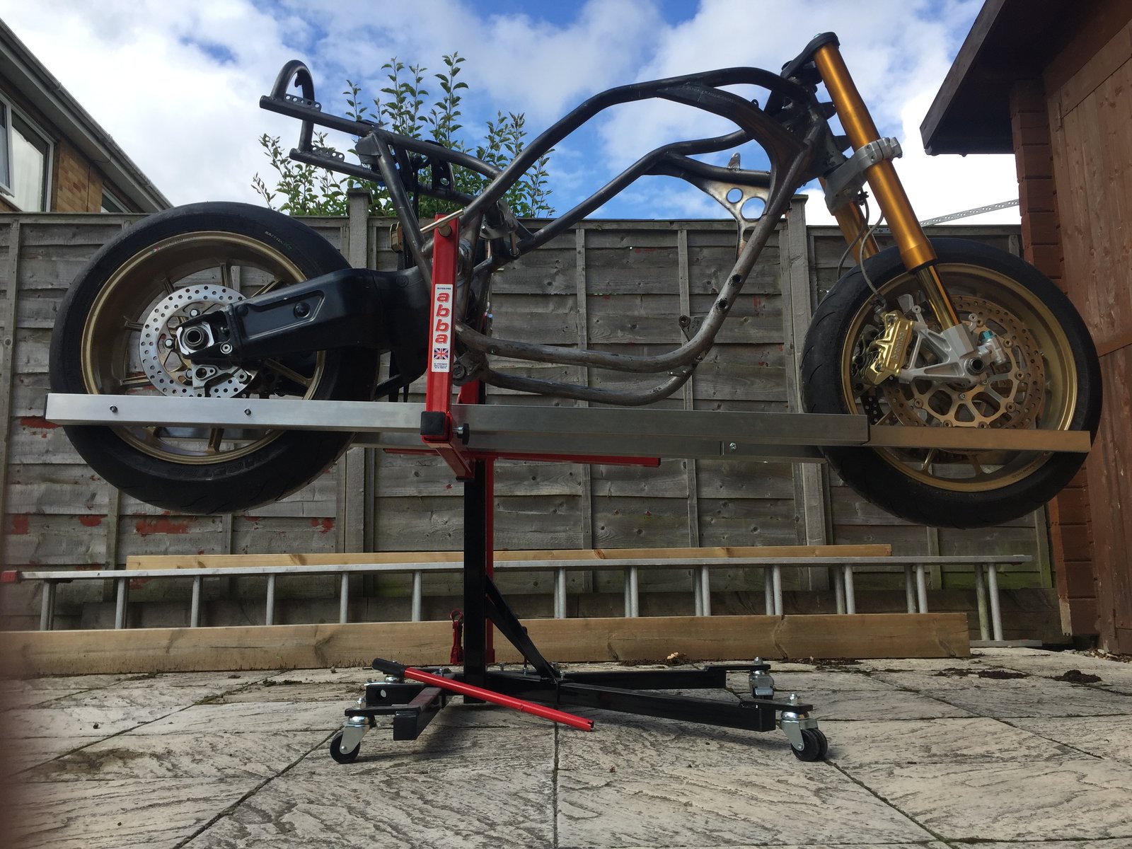

  8. Get the ABBA Sky lift. Very stable and works for exactly what you want.
  9. Get an abba-skylift; it allows for far more different positions & dissembling of the bike if needed.
  10. Is the Abba not a bit of a ball ache to set up each time you wanna lift the bike ??
  11. These stands are all copies of the 1Jac - the company split and the original designer / manufacturer stayed with UK manufacture with his design. Others took the design to China and all are copies - the Warrior Stand that Demon Tweaks sell is usually the cheapest of the Chinese copies. But if you want the best buy the Abba Skylift as intimated above - I have 2, one to display and one to build bikes... :)

  15. Abba stands have a couple of straight forward assembly videos on y/t.
  16. I just like the fact that you have just a stand on display :blush:
    is it a prototype? :D

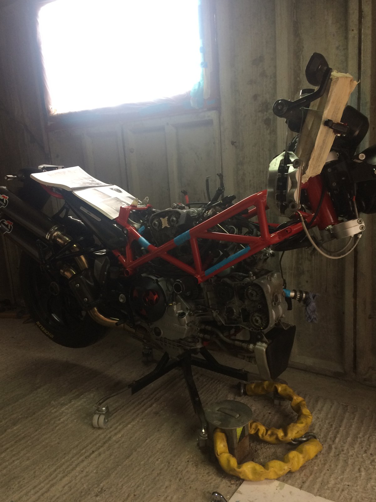

  18. No :) it has a common 999R on it :yum

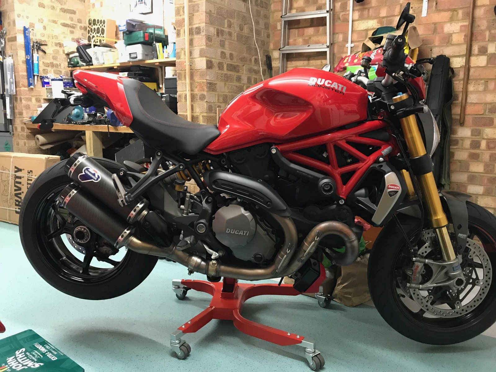

  19. I've used constands on a few bikes with no problems. I had to adjust it for the Monster as it wasn't picking the bike up high enough to get the front off the ground but stability hasn't been an issue. Bike sits on it when it's not in use so spends a lot of the winter months on it.
