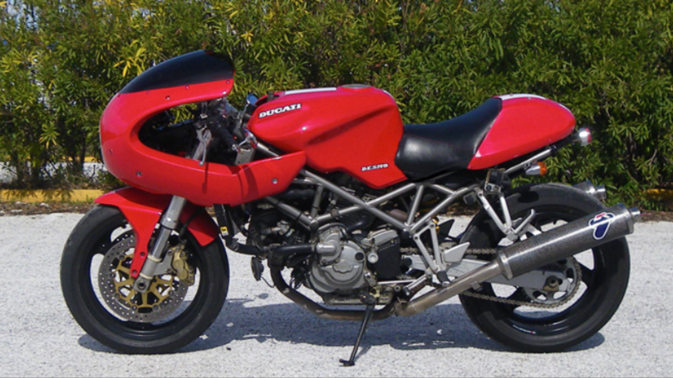

    I joined because I’m intending to buy an ST and fit the Tifoso kit fairings to it. Same as the top photo.

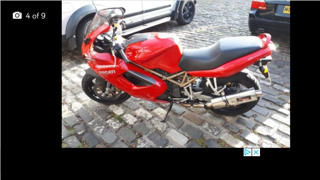

    I’ve found an ST2 that’s been dropped and has cosmetic damage. It’s a sensible price (about £1300), 2001 registered but has a gold frame so I’m thinking it’s a late 2000 bike with 25k miles.
    The seller bought it at auction with no history but it does appear to have been looked after from the photos.

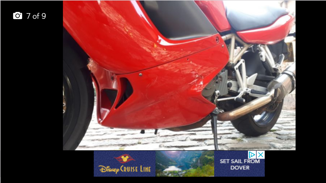

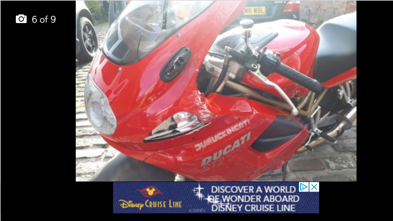

    Damage appears to be limited to the top fairing indicator area, some scratches on the belly pan and a fecked quill exhaust. I’m thinking low speed drop, and would be replacing all the parts anyway.

    Just my worthless opinion but the fairing on the first bike looks shit.

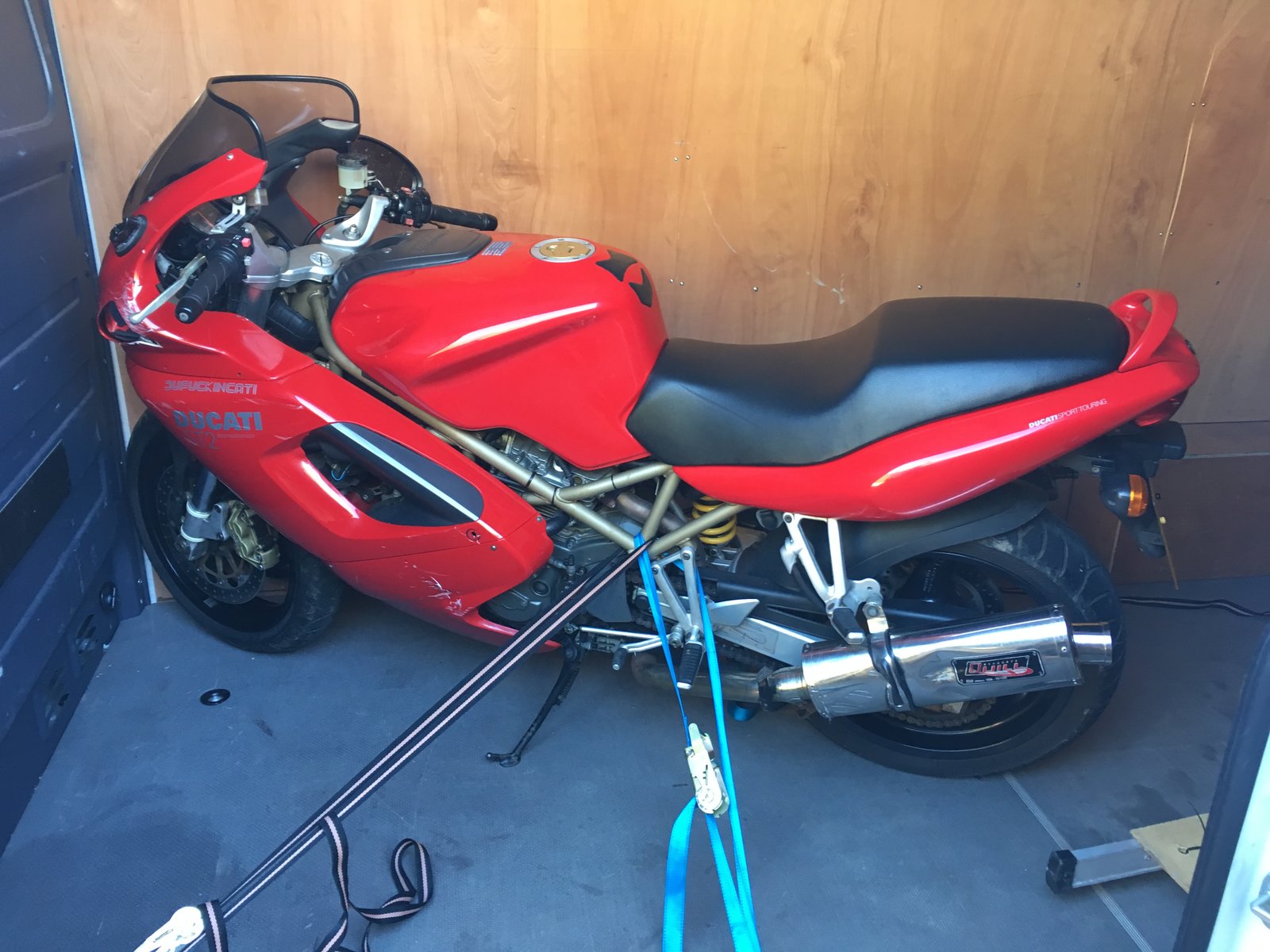

  16. So this happened today....
    Bad points.
    Fairings are somewhat fecked
    Bits of corrosion on the engine and some brackets
    Front master needs a seal kit or replacing
    Rev counter not registering (but I found a loose cable next to the generator)
    Starter is a bit slow but my mates 996 is similar
    Good points
    Runs well
    A quick (somewhat illegal) squirt around the block showed everything to be working well
    Wheels have been powdercoated
    Clutch slave is a sigma unit
    I don’t need the fairings, although the looks are growing on me...

  19. My advice to you and your mate - if your battery is in good order
    -Think about investing in a good set of starter cables and earth straps - @Exige sells them on here with great service and a good forum discount, but obviously home built is possible / other sources are available.
    Not just because it will transform the starting -
    Mine went from chugga chugga chuuuuuggggaaaaa to literally brush the starter button with my thumb and it’s running - same battery
    - but also because if you get unlucky during starting on a slow starter it can wreck the starter clutch, and then you are in for much more work and expense than just installing a few external cables.
    Jon
  20. I’ve been reading about the cables and potential pitfalls, Exige said he could probably come up with something once the battery is moved to the new location and I know the lengths required.
    One thing that struck me while stripping the fairings was how thin a lot of the wiring is compared to other bikes.
    I’ll be going through the loom and connectors to check for damage/corrosion as I put the bike back together. Saves a load of time standing sheepishly at the roadside!
