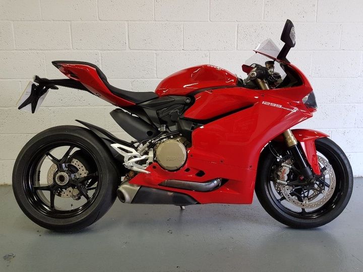

  1. Hi All
    I am probably going to buy a base model 1299 this weekend, are there any particular weak areas I should check before buying ? I have heard of a few problems with the dash screen cracking, do they eat chains and sprockets ?

  18. Thanks for all the replies, this is arriving on the 1st Dec :).
