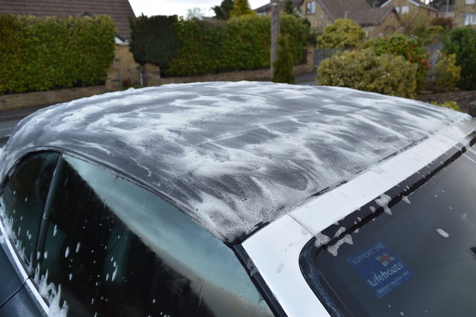

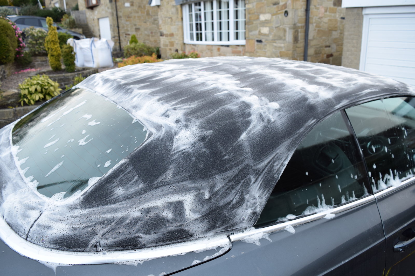

  13. Well I did it this morning , my hands were fecking freezing
    Used the autoglym as I got one from Halfords yesterday, did it twice as the foam was so green on the first wash/scrub. The results are great.
  14. No pain no gain....glad you've got the desired results...
  15. @rob lewis I’ll use your suggested stuff next time round it was just easier this weekend to get it from Halfords
