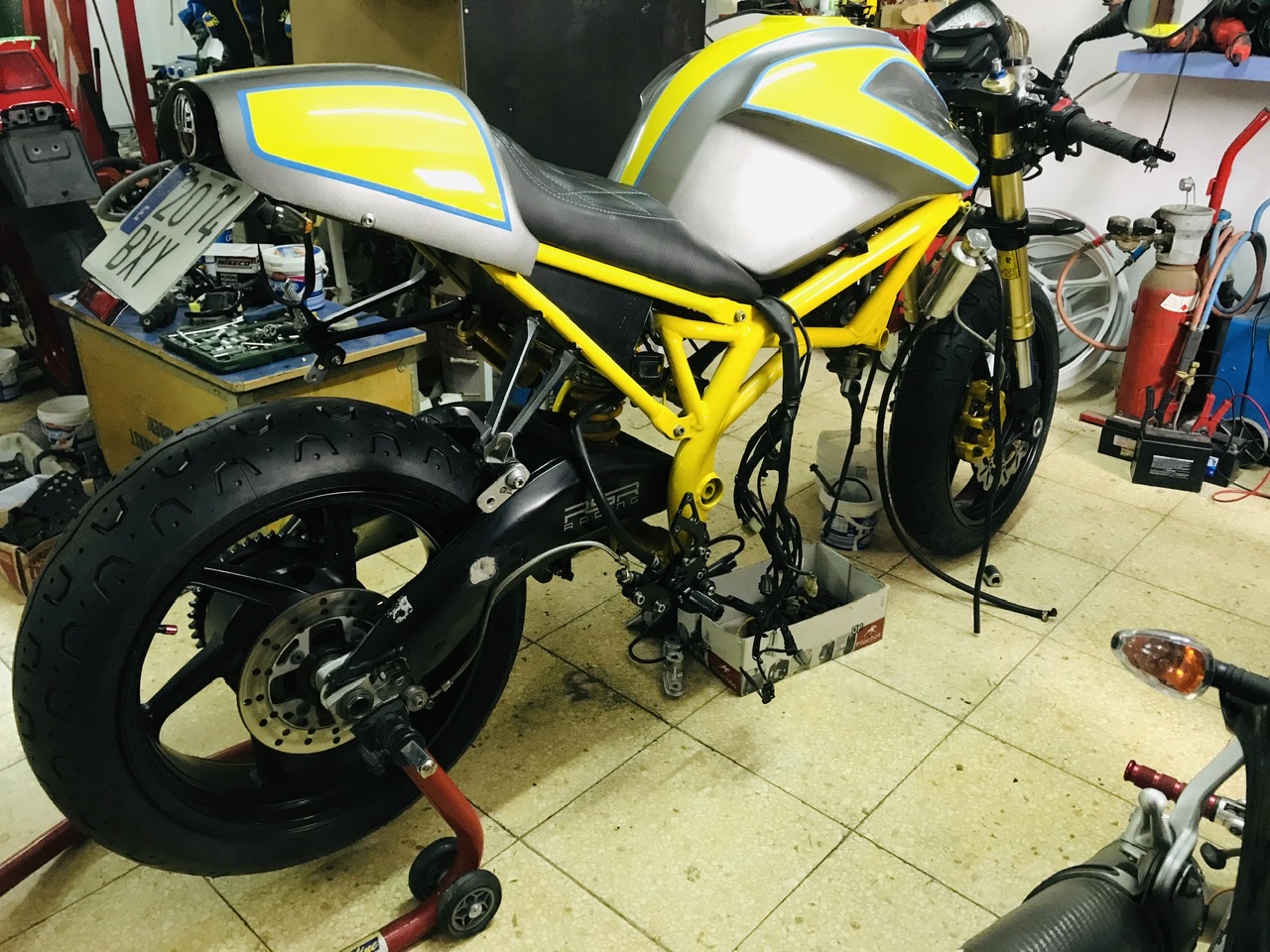

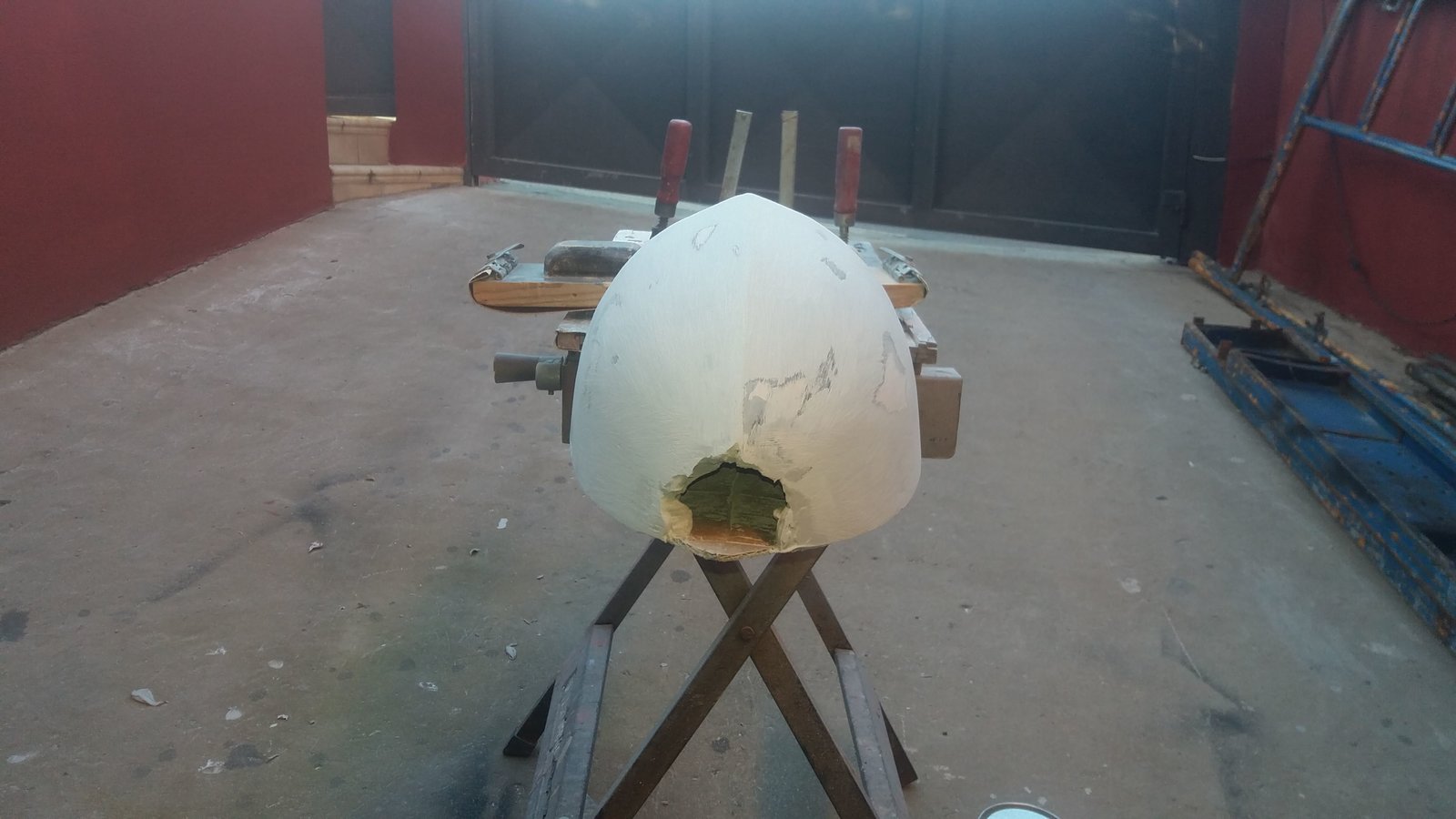

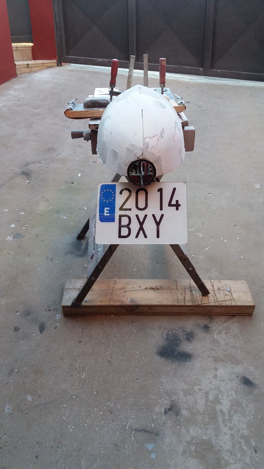

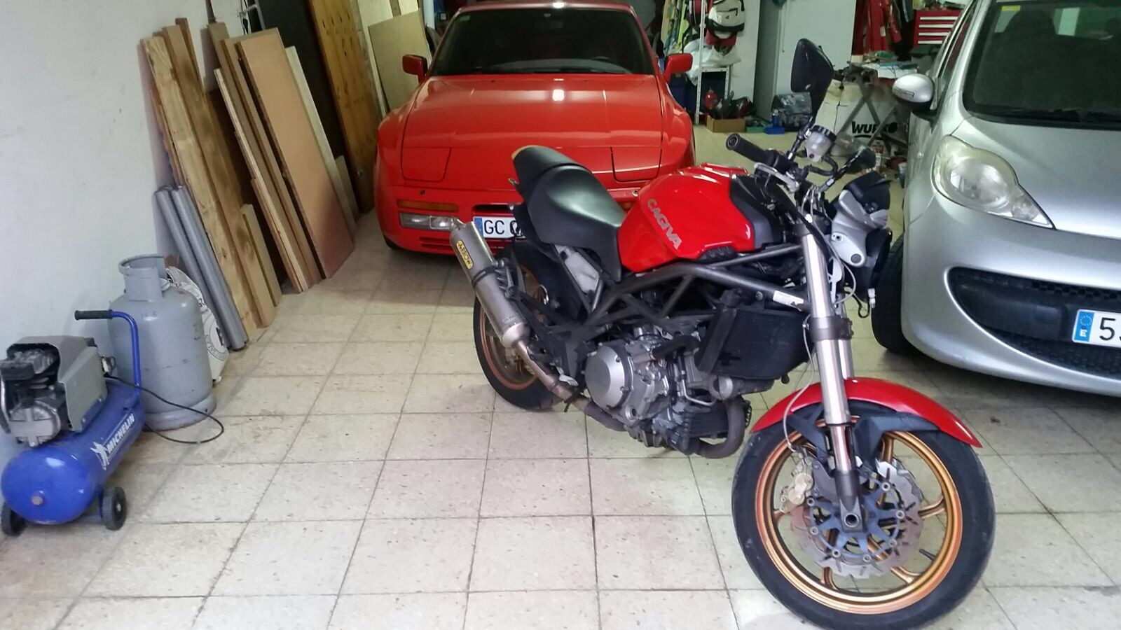

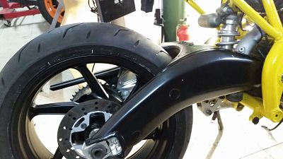

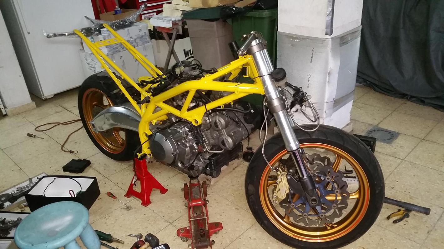

  1. I bought this bike crashed at the rear as car runt in to it.
    So the rear sub frame was bended and the management box was smashed.
    This parts have been changed at this moment:
    Front fork Gixer
    Swingarm Aprilia RSV
    Rear shocker R1
    Home made rear chassis
    Home made rear cone

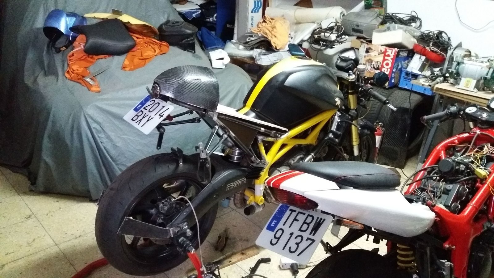

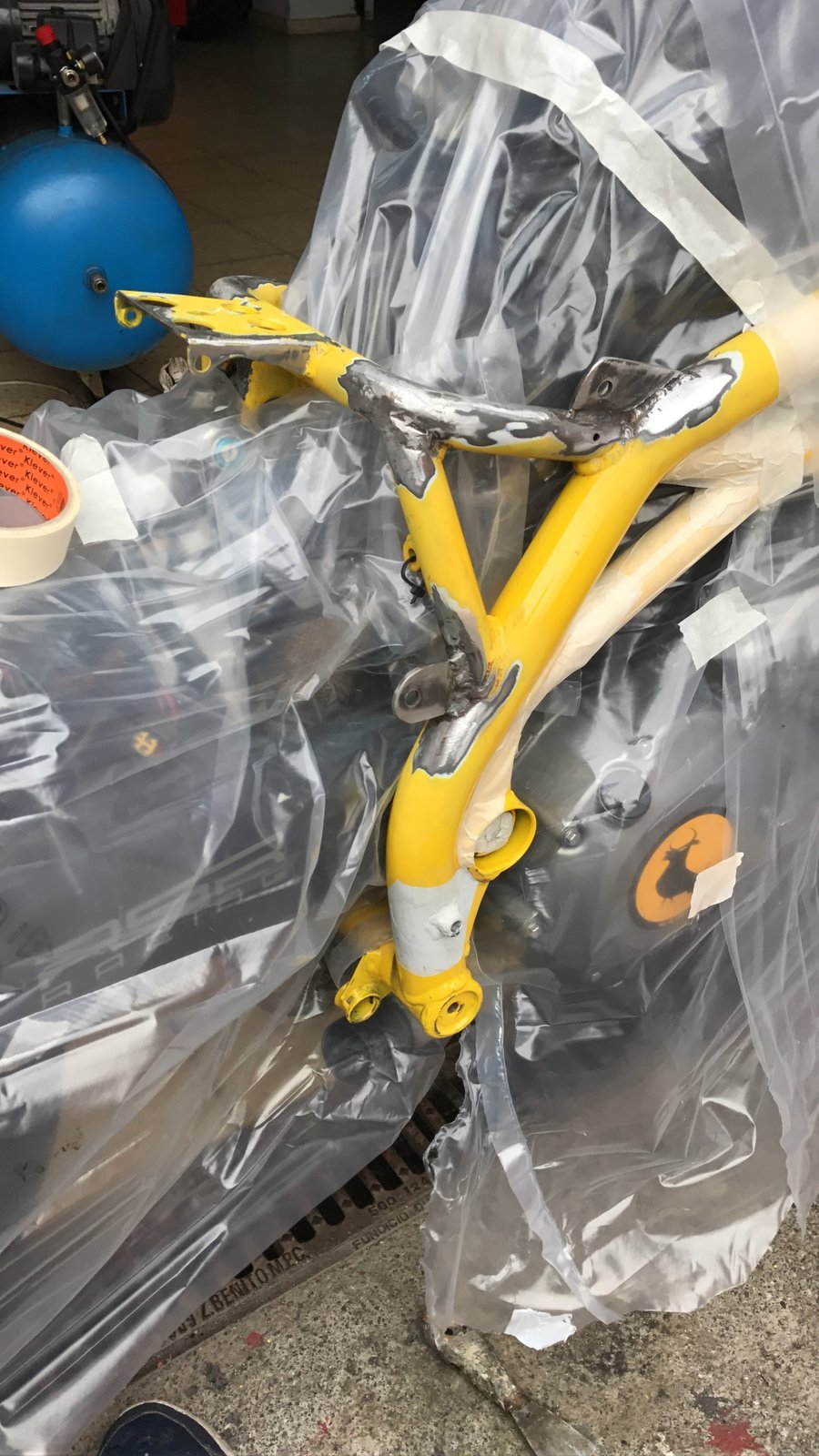

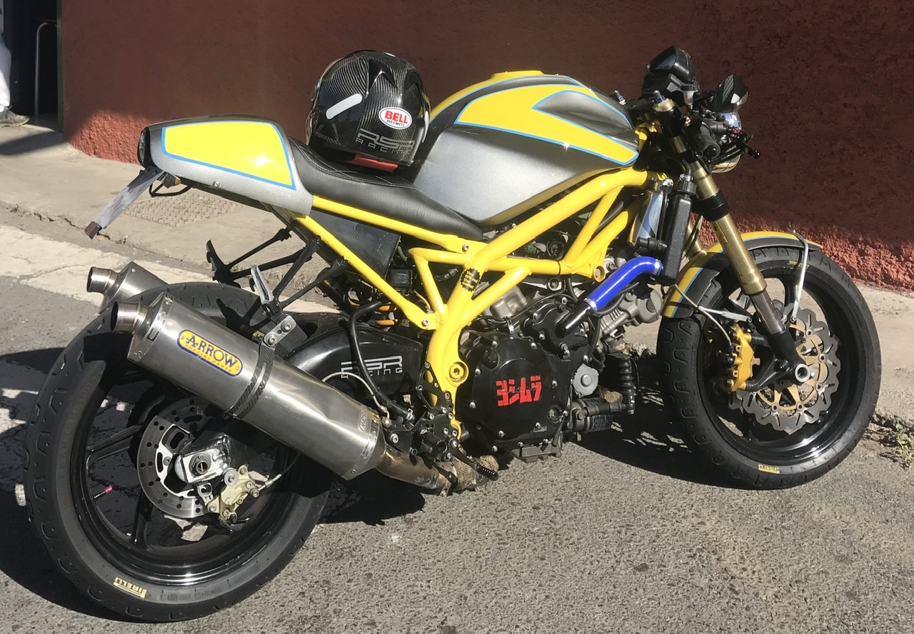

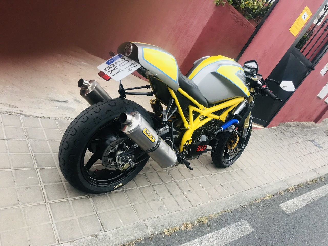

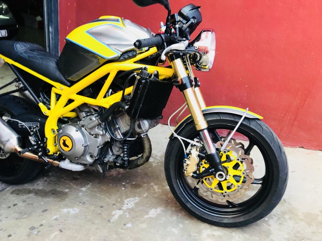

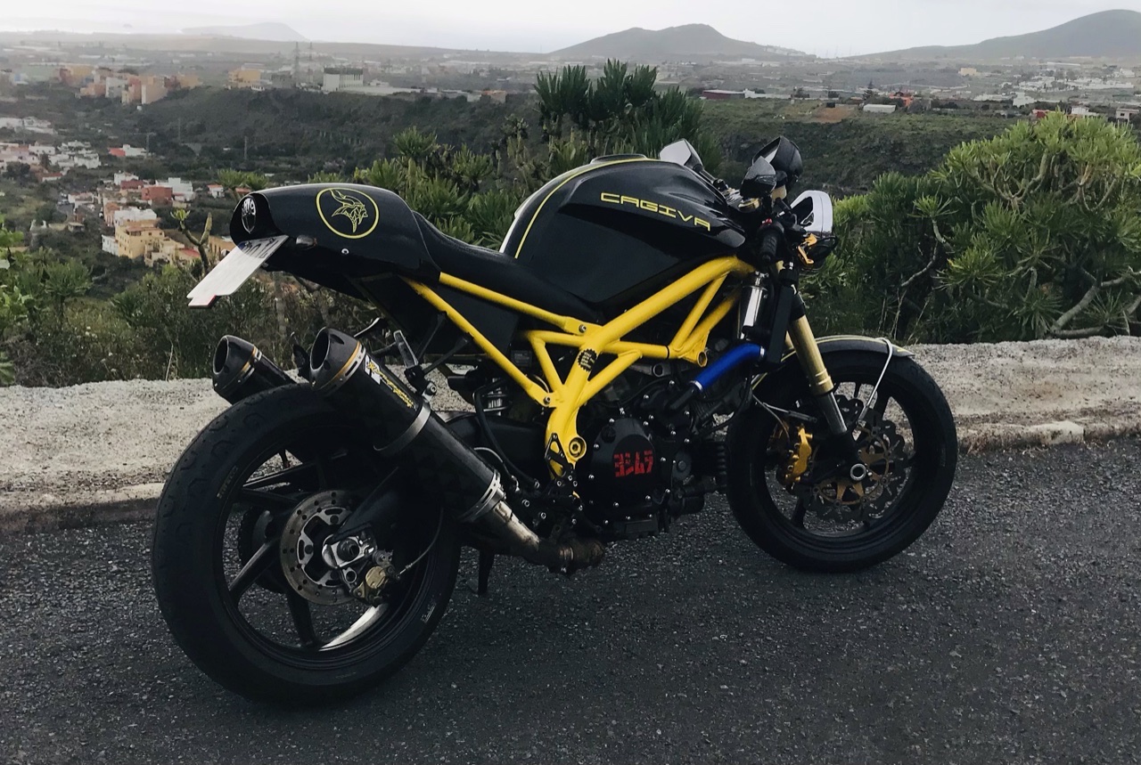

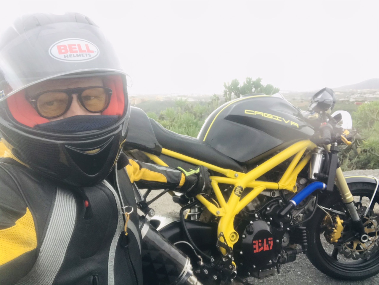

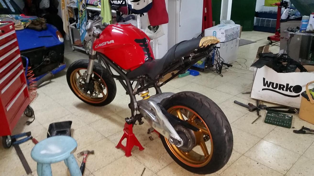

  4. A lot of things happened since last post I did about this bike..
    The bike was finished and I used it during some years hunting modern sport bikes at local mountain roads
    68184874-095F-48BD-97A5-A28D3AFB92D5.jpeg BD4D429E-E8EF-4B66-84C7-C0B10CD3A4F1.jpeg 8F91FEBF-F3B7-4A47-ABDB-1E94489679C9.jpeg 4B476D62-AE18-403D-A91C-B5A8A8E9E8AD.jpeg B81D1AC9-FEFC-41DF-9C8E-F1EDDBD68488.jpeg C3625BDC-F2B2-4906-B2B9-2989CFC44313.jpeg

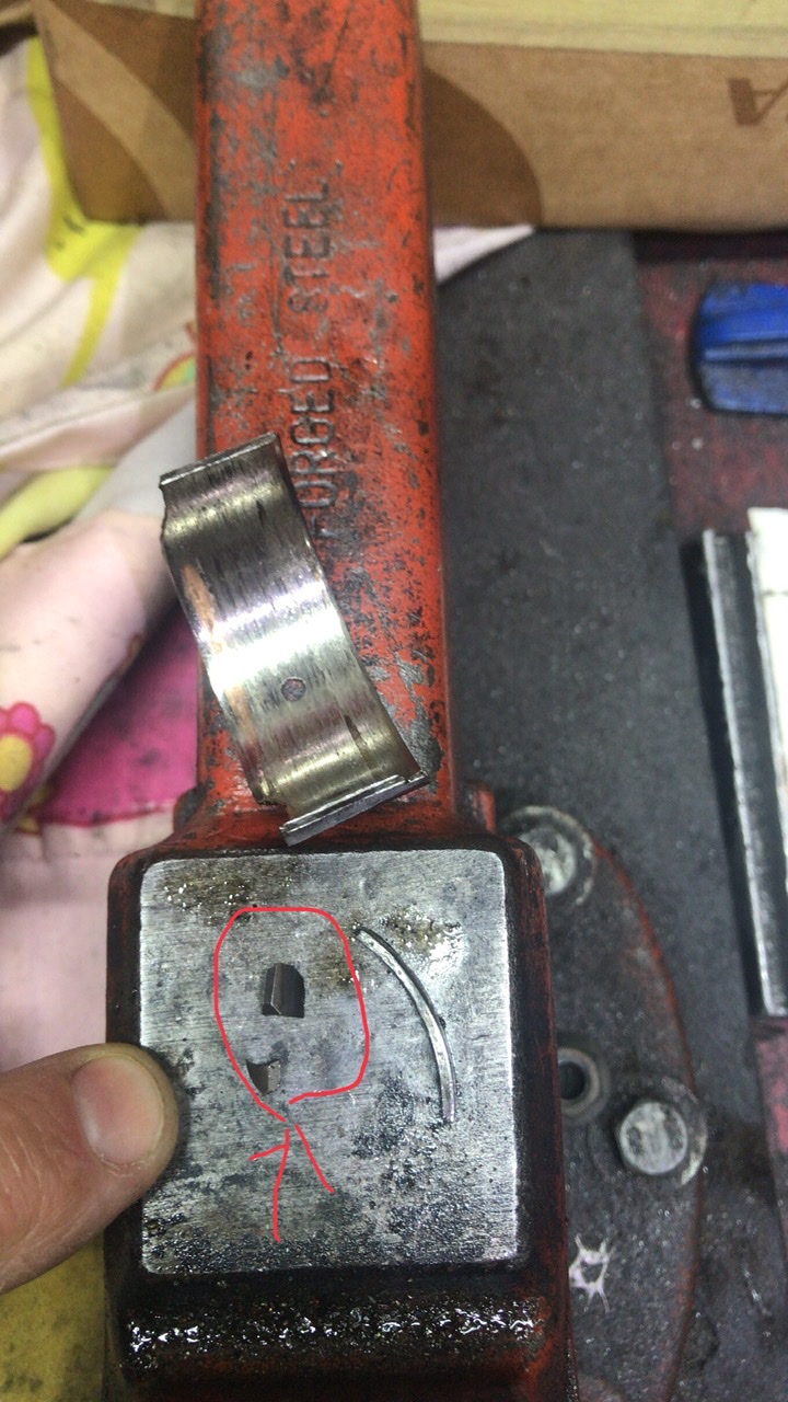

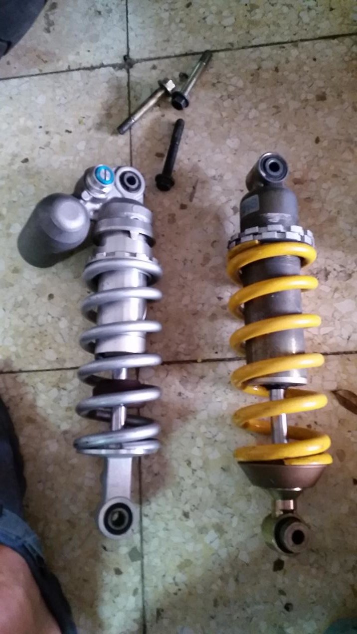

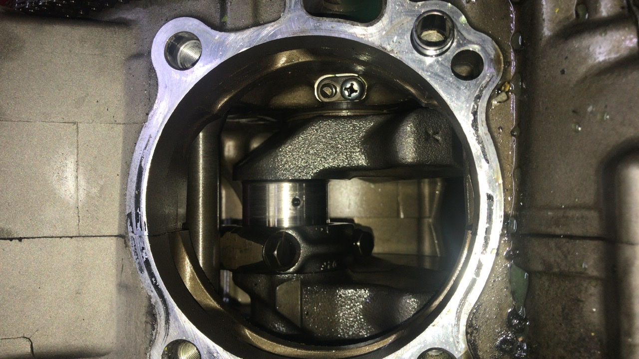

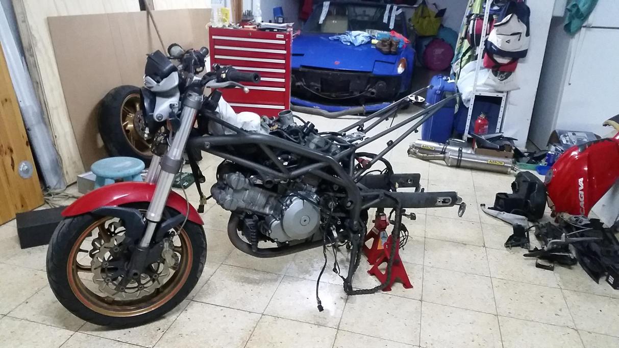

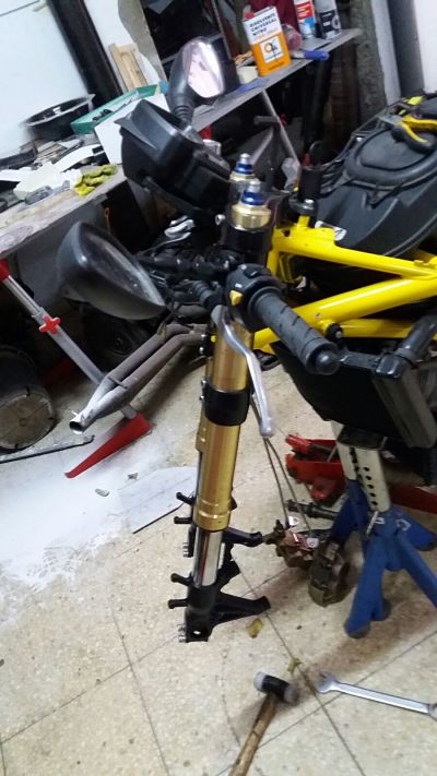

  6. After a lot of fun the crank bearing gave up, So as it has to be rebuilt I used a forged hi comp pistons and rods and a reprog of the dme D44AE1DE-B447-432F-903A-1B7A514A86C9.jpeg EDB78D68-ADF6-4D98-9C6D-F5904C8F4589.jpeg 3B2669DA-5715-4157-BB82-174BB7DB88F6.jpeg

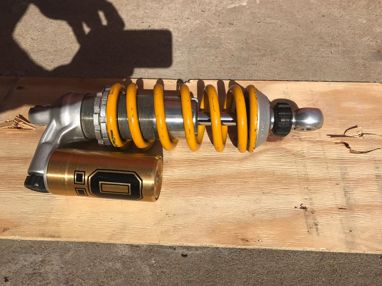

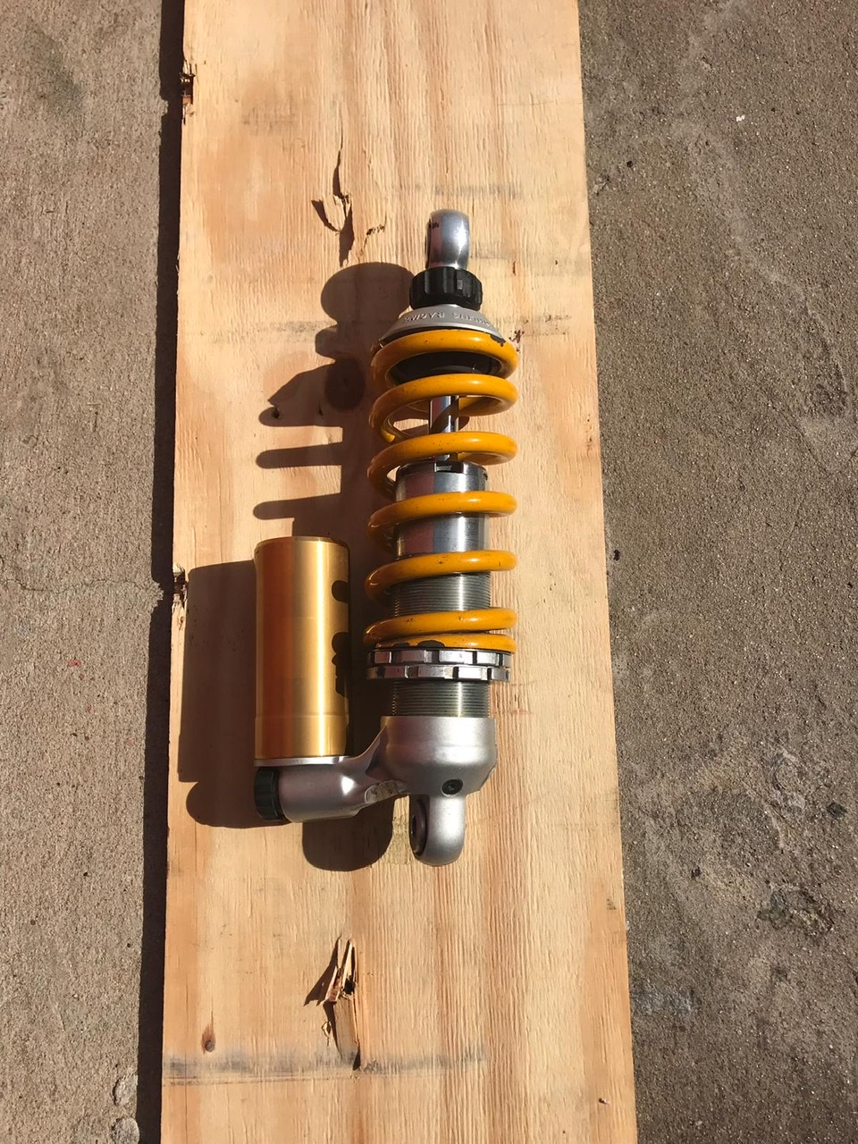

  7. It’s a lovely bike to ride and changing suspension it’s converts a beast EA0F8C44-48E2-432B-BC3B-BB14908EC9B4.jpeg BE9E3432-7C8E-4C23-81BE-97DF9D50559E.jpeg

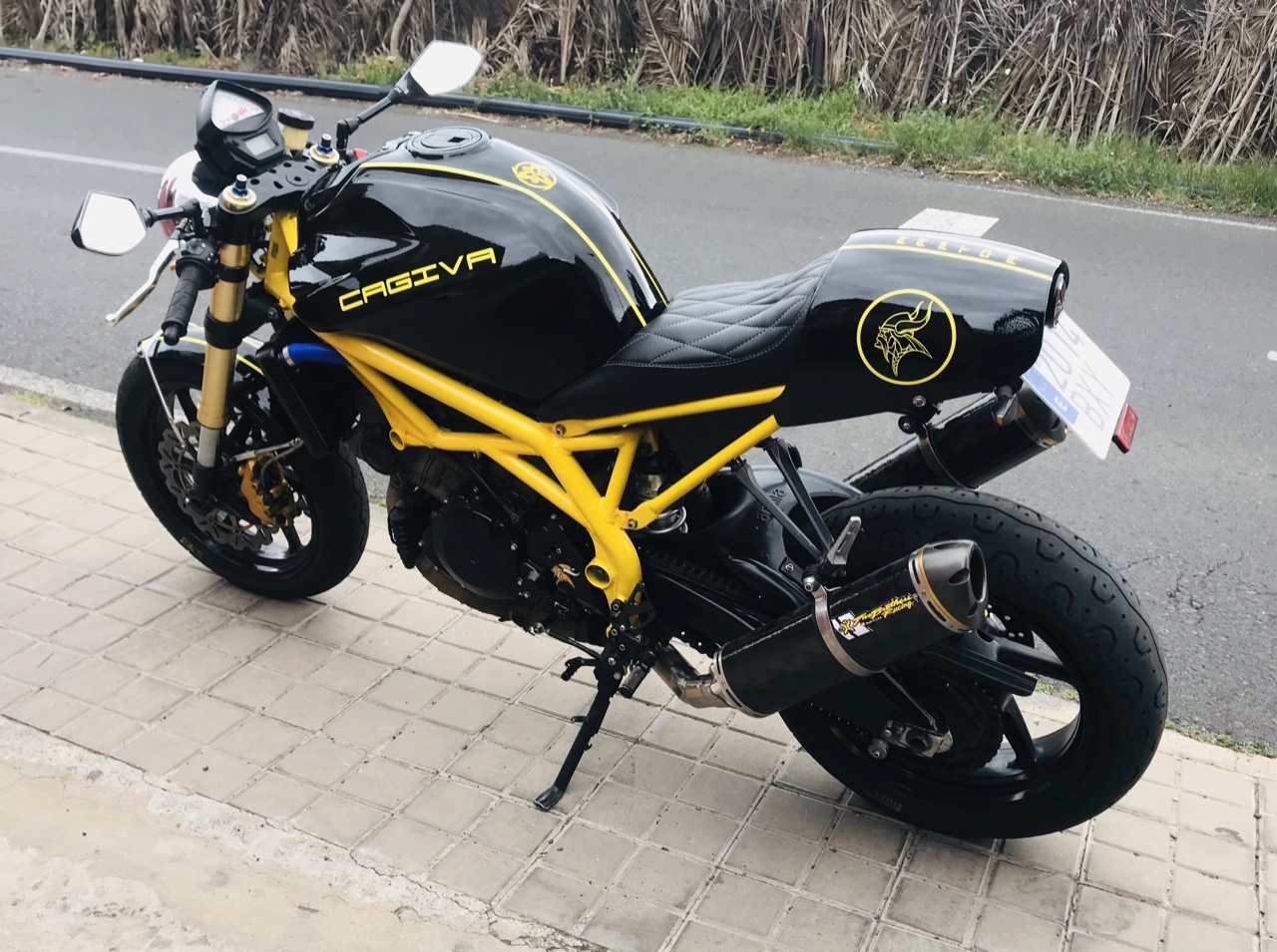

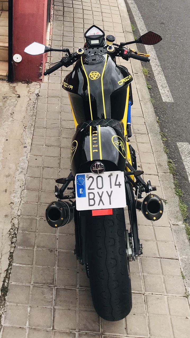

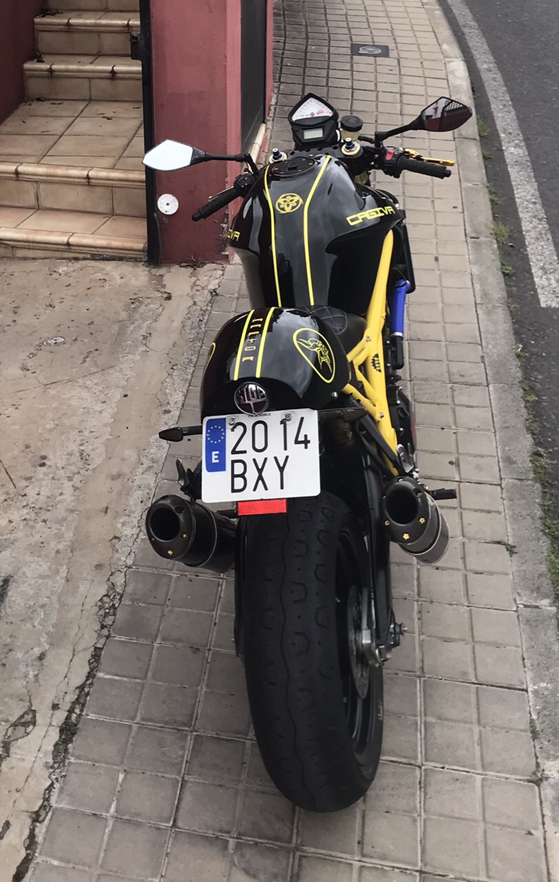

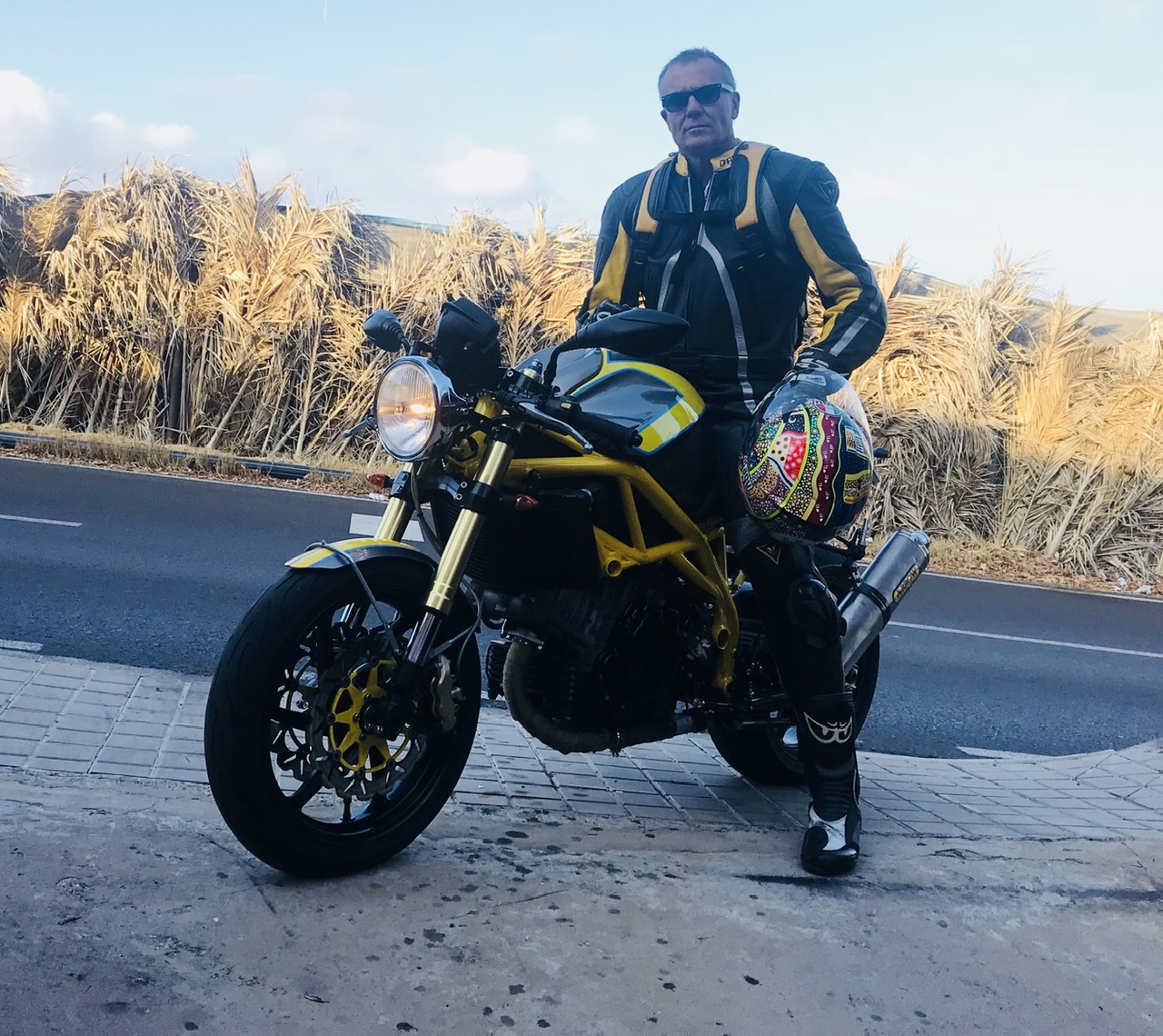

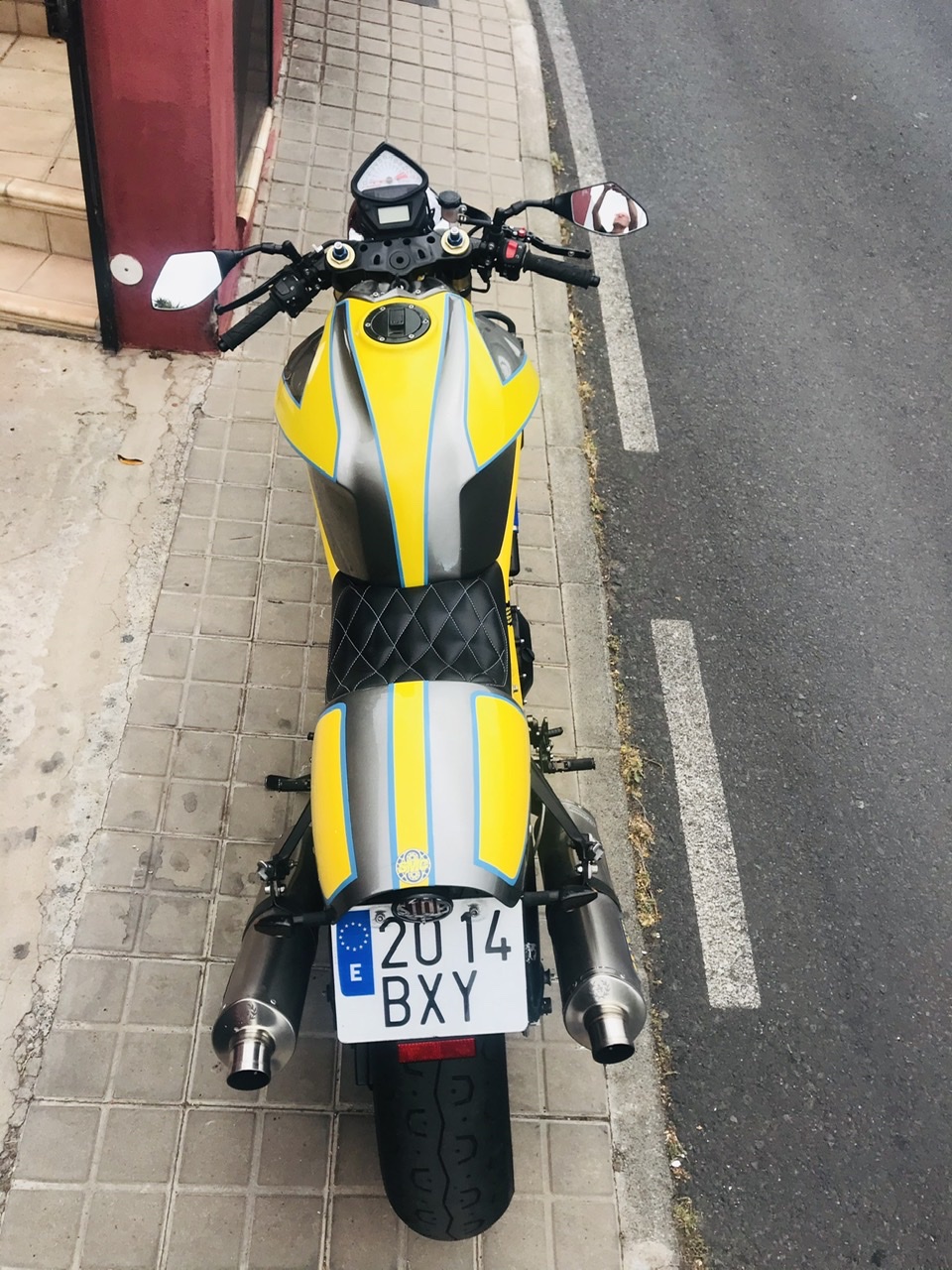

  8. Last June I crashed the bike!
    The bike did just suffer some some minor paint scratches and needed new mufflers, I broke my shoulder in three and the clavicle in two pieces, Now I’m recovered and back in business again.
    8DC3AC14-D7FB-4345-81C2-E21B56D4CEE9.jpeg 4E9C2C12-2556-4F3C-83E0-C124B941D9A5.jpeg 85D7F5C0-71C2-46BF-AA1A-E408725E4469.jpeg 2D7651AC-705A-4957-842E-E00821ABFDBE.jpeg 90649660-A1D5-4FEB-BBE1-4C65C04CE488.jpeg 4D67B024-F05A-49F9-A630-20CC77D08983.jpeg

  12. Looks cool. 1st shot of yellow frame I saw and I was thinking..”what is he doing?” But the finished colour scheme is/was great!
  13. Yep, it looks great!

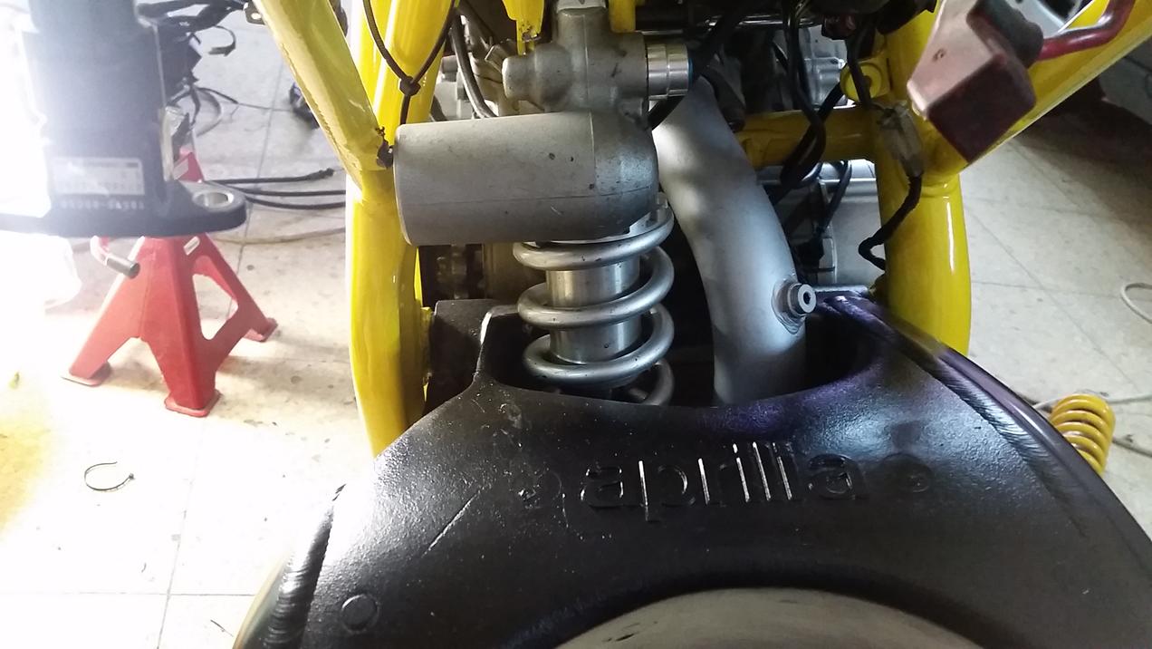

  14. Sorry to learn of your accident. It just occurred to me that the Aprilia swingarm fit is pretty incredible, did you hear of someone else doing it or did you find it was close and offer it up yourself? Maybe it wasn't as simple to fit as it looks but otherwise it must have been quite an Eureka moment. :)
  15. I didn’t invented nothing, It’s a frequent upgrade at the Raptor as it’s more or less a bolt on option.
    Many parts from Aprilia, Ducati and Cagiva is always shared.
    So yes you can put it into a Monster also....
  16. Well worth remembering, I was aware of many Cagiva/Ducati swaps as am a Cagiva nutter first. I used to fit the Mito front disc and caliper to upgrade many a Ducati to twin discs.
  17. That’s correct!
    The Cagiva share same fork legs, calliper, discs with Ducati, As Miguel Angel Galluzzi was in head as designer at Ducati, Cagiva, Gilera, Motor Guzzi, Aprilia etc..
    I suppose he just used the parts and measurements he know was working well..
