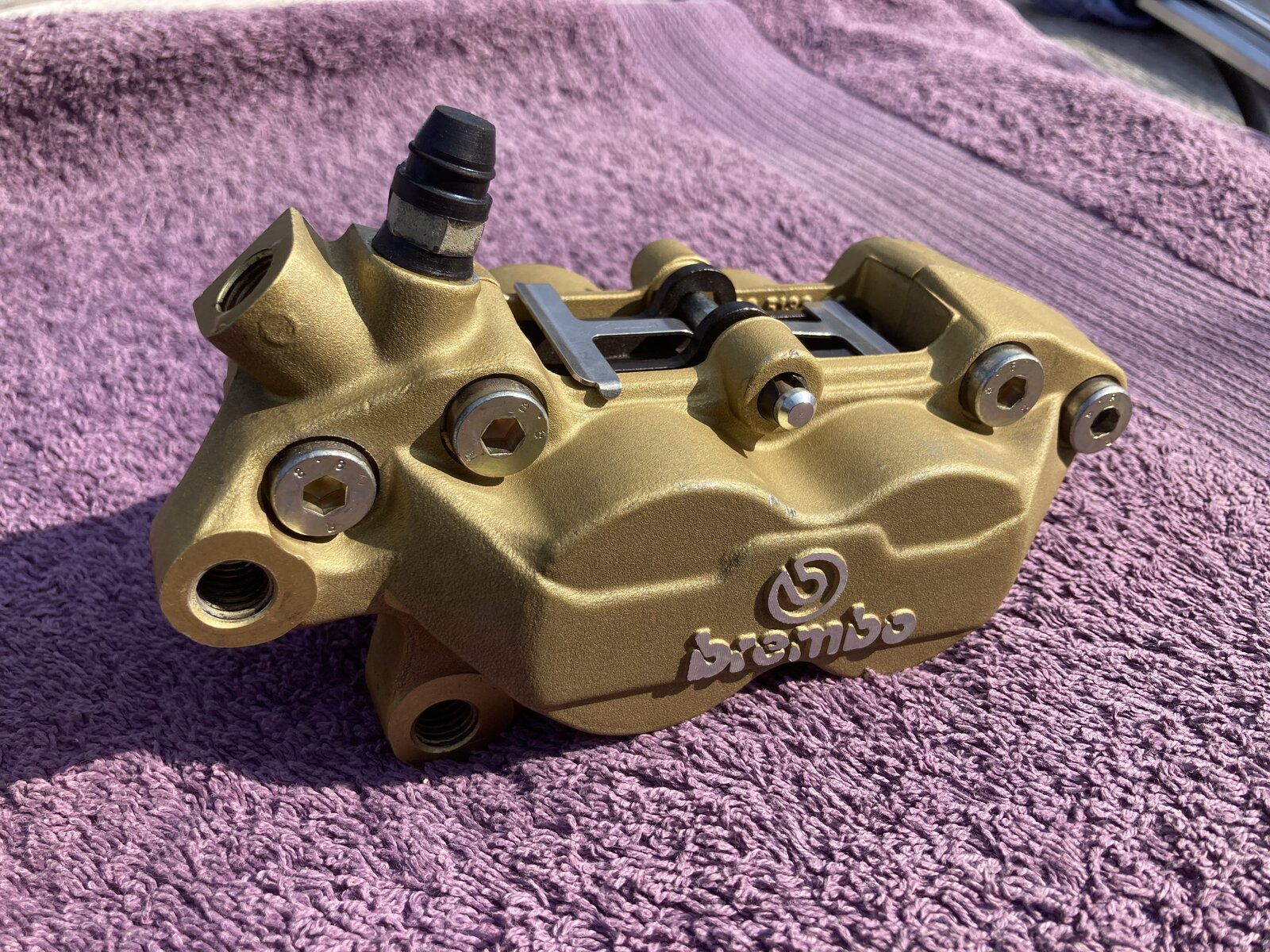

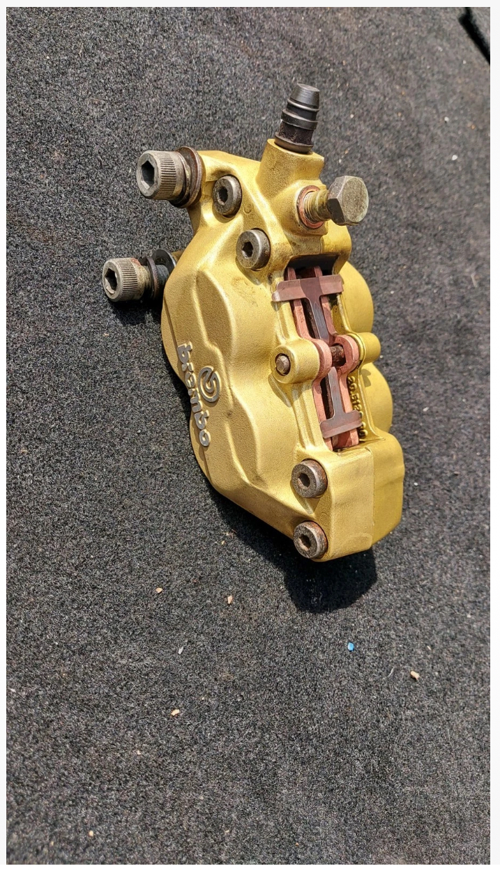

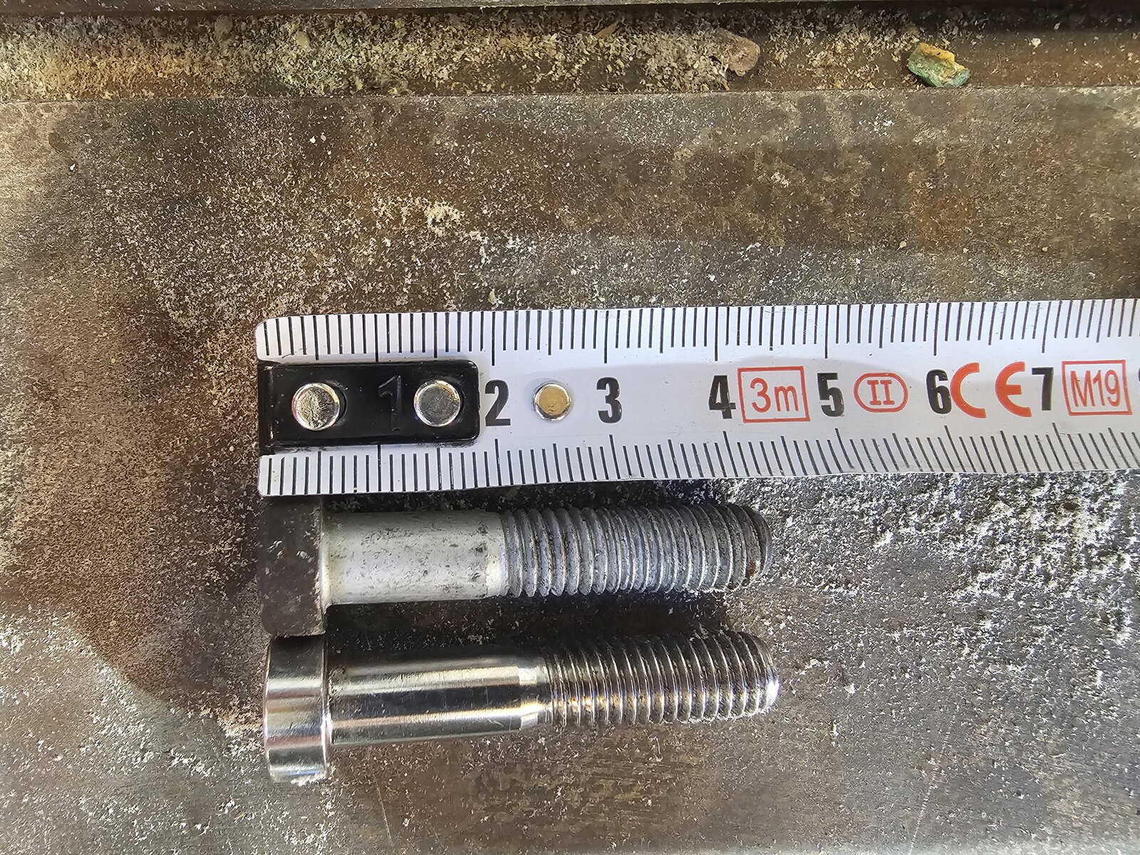

  1. I’m looking for the original or new caliper bolts for my 1993 Monster. They were changed some years ago to new stainless ones but they are not correct, the head is far too deep compared to the ones in the picture.
    If I am to buy new and have plated any suggestions on which quality to buy, worried I’ll buy the wrong type from eBay..
    picture below for reference not from my bike.

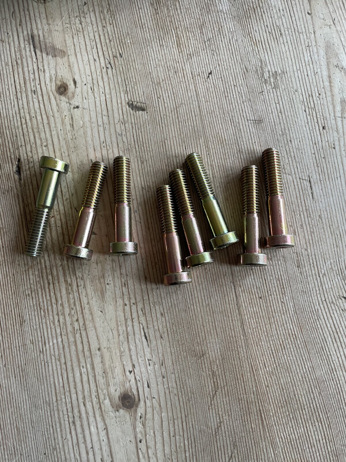

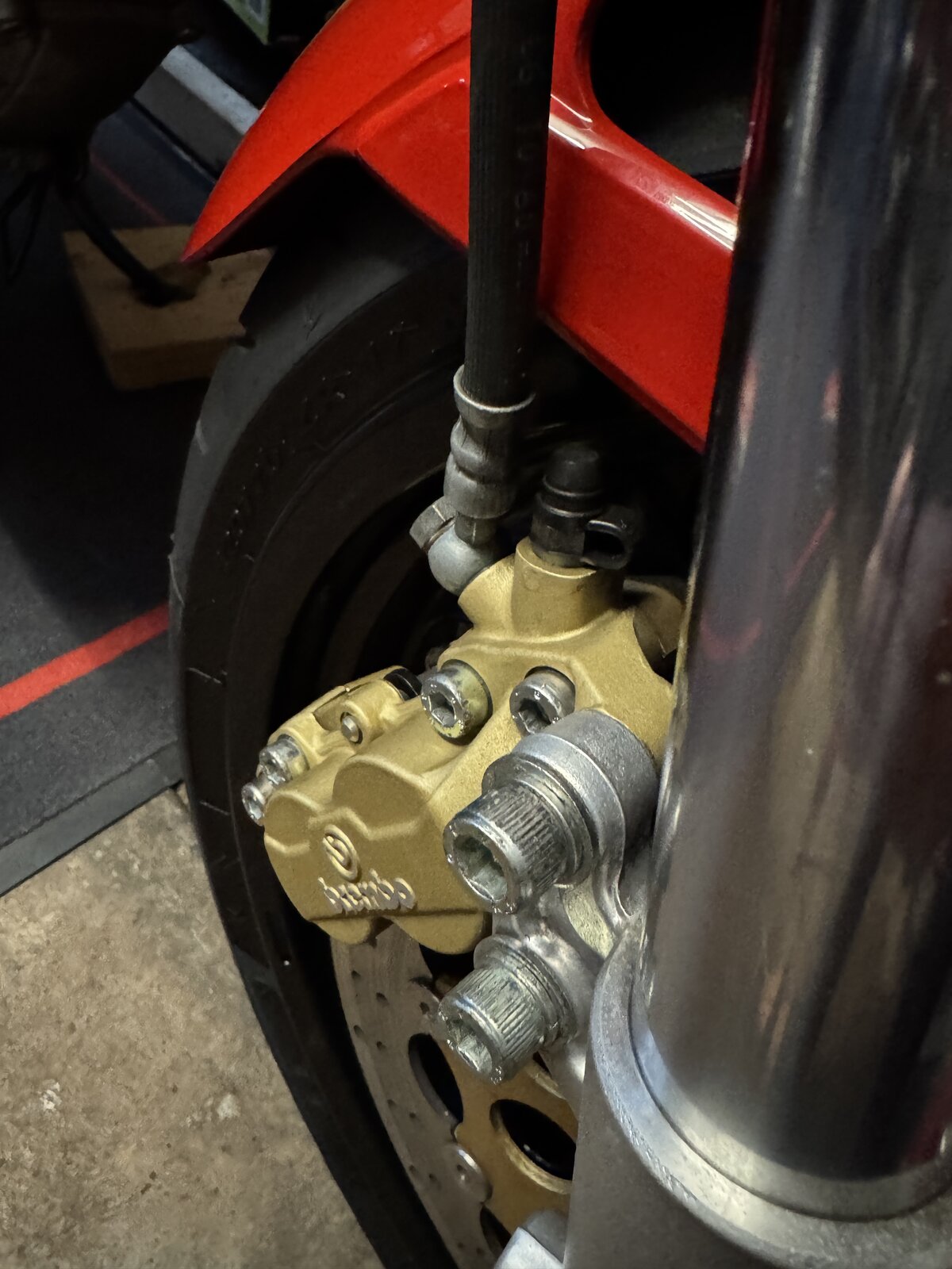

  5. This is what mine look like below, clearly the wrong head size. I’m looking for original bolts or new aftermarket but have to be the correct low profile head. I can always have them plated yellow if needs be…
    The mounting bolts are the wrong had size too…

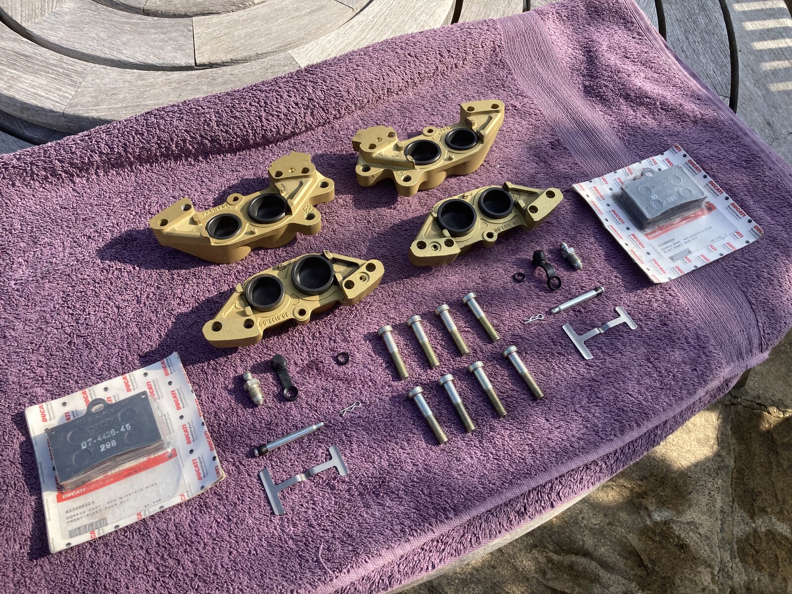

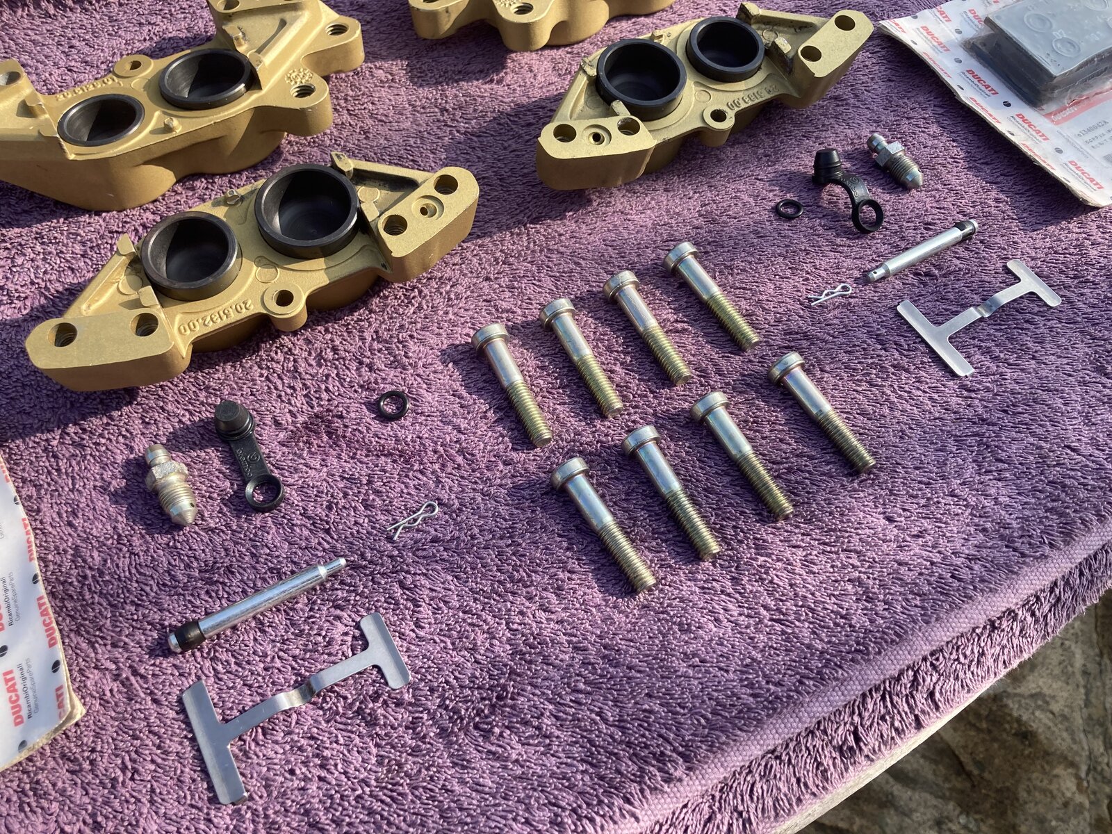

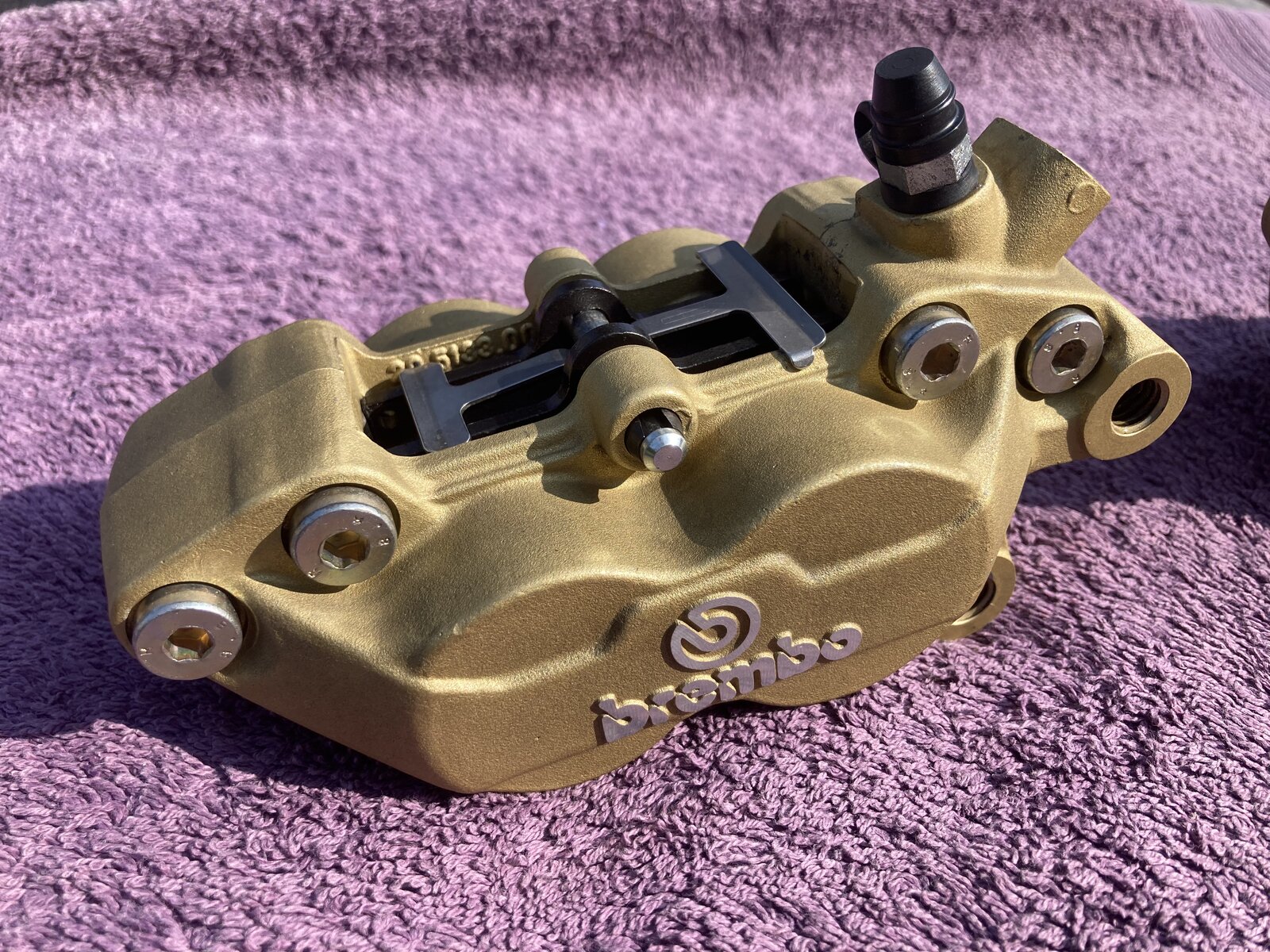

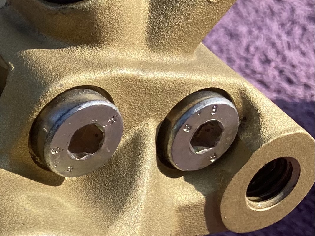

  10. I refurbished my 916 calipers in the summer, here’s a few photos which may help identify the bolts - I had mine zinc & gold passivate coated by JW Rudge in Birmingham.
    As mentioned above by Sev, they are marked with 8.8 and also an R.
    #10 jcw, Oct 13, 2025 at 8:19 PM
