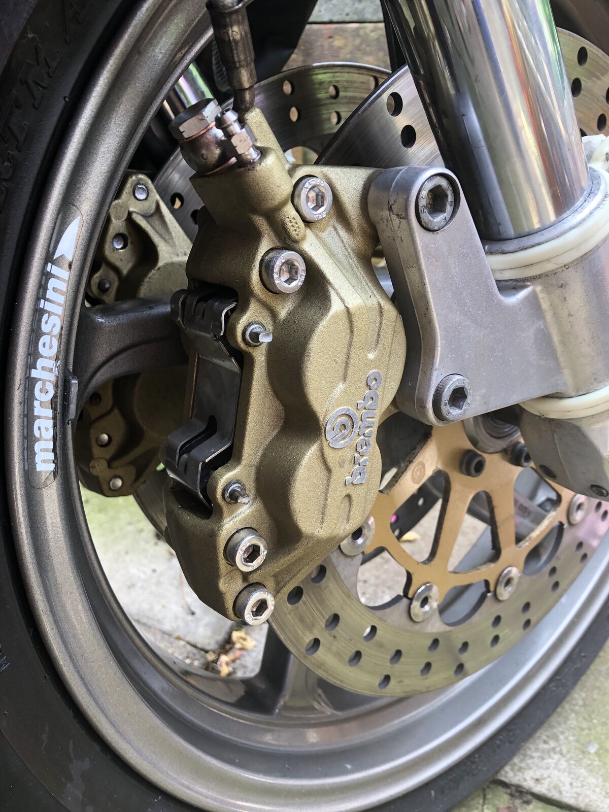

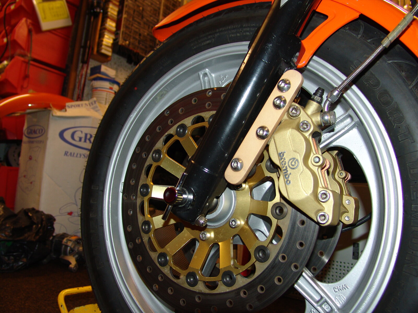

  1. Got the new caliper bolts in today which was a nice quick job to tidy up the front end a bit. Thankfully all the old ones came out OK. One started to round but easing it gently back and forwards got it loosened up.

  5. What torque setting did you use and where did you find it from please?
  6. They look nickel plated - assuming they are youll be back in the same boat in a few years.
  7. The brake lines and nipple I might replace at the end of the year when I do the large service with brake fluid change, but to be honest i'm not going to be replacing every little 'imperfect' bit of the bike, as thats how people get sucked into full blown restorations just because of a few bolts. The bike I will be using a lot, for commuting and weekend rides so having something absolutely immaculate defeats the point, as I will never then want to take it out.
    I do however like doing odd little improvement jobs throughout the year to keep myself occupied and get to know the bike.
    The bolts were genuine ones from Brembo. I don't like replacing brake components with stainless really, and the last ones lasted 23 years so i'm not too worried about longevity :upyeah:
    • Disagree Disagree x 1
