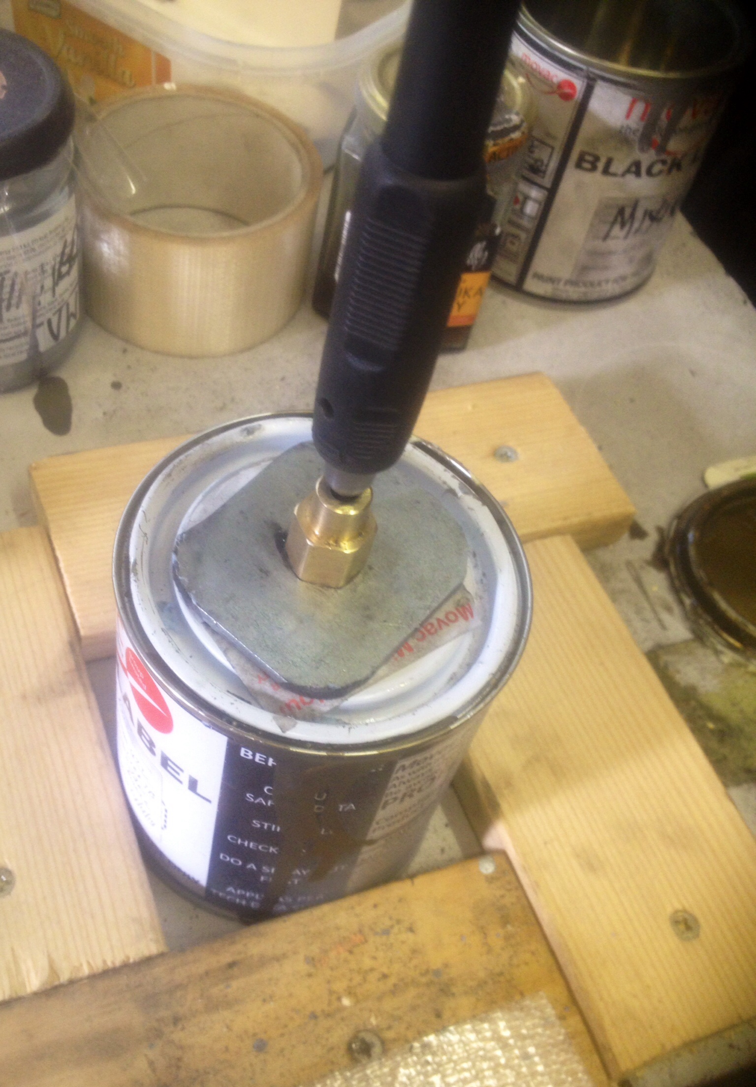

    I was talking to the guy who painted all my new carbon panels.. I wanted to do a bit of the less essential paint work eg engine and sub frame bits and pieces... He was telling me how a lot of people don't stir the paint anyway near well enough and to purchase a paint mixing machine.. They are not cheap.. Yes I could get one of those attachments for a drill, very messy and he said a long 1 hour slow stir is what he would reccomend.. Now I only need small paint quantities for what I do.. So I thought I would make one myself..

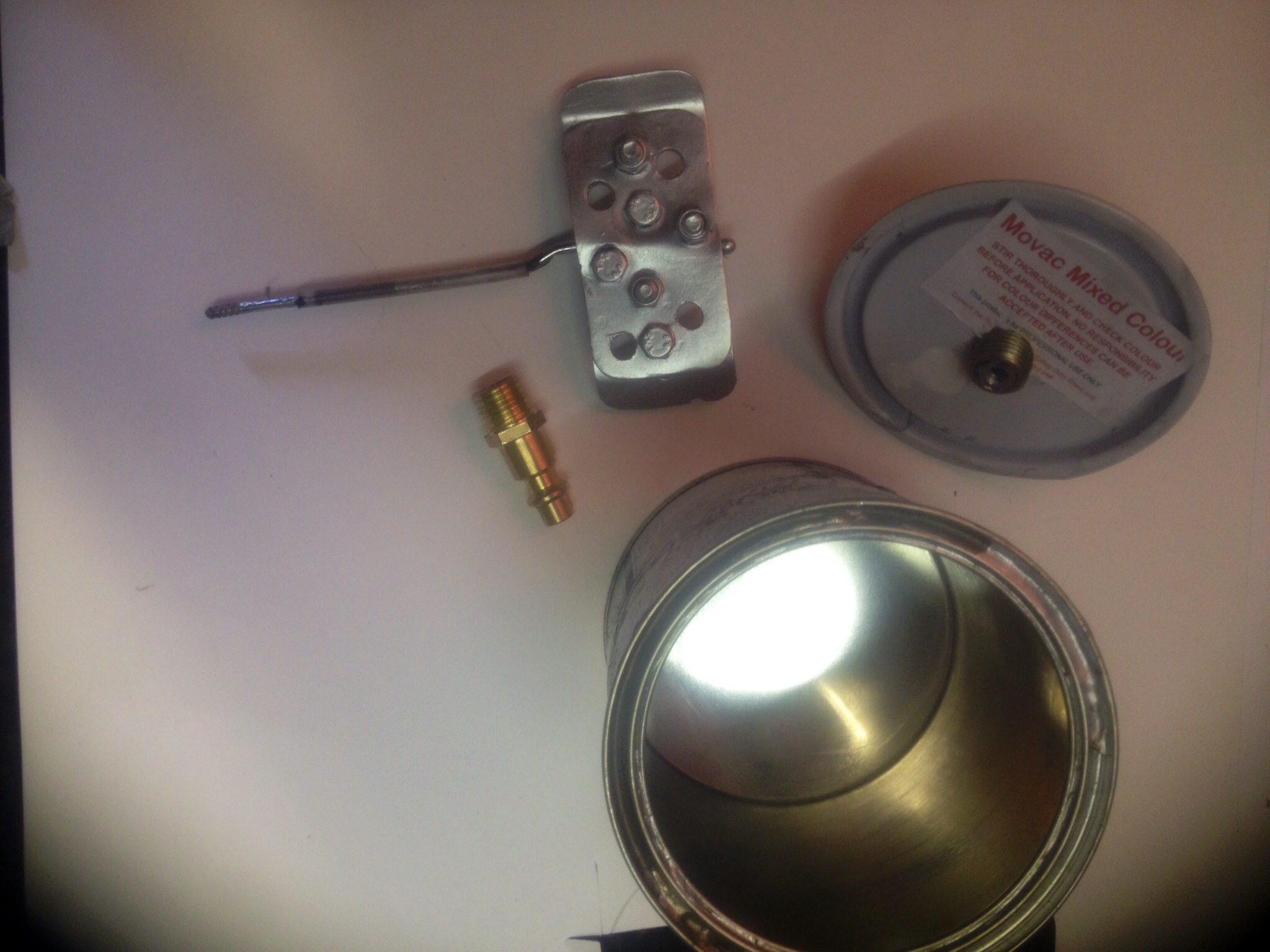

    I cleaned out an old paint tin the same size as The paint I purchase.. I then straightened a coat hanger wire and made a paddle with scrap alloy, drilling holes for paint flow.. As picture
    I then drilled a hole right in the centre of the lid, important so the paddle runs smoothly .. To find the centre of a circle go on YouTube, it's actually easy if you know how..
    I then used one of those air hose quick connectors fitting it to the lid.. Threaded the paddle shaft through the centre of the connector.. I also used the plastic tube off one of those pump spray bottles like those used for window cleaning products sliding this over the coat hanger shaft to perfectly take up excess play and act as a bearing..poured in the amount of paint and thinners req attached my dremel on slow speed... And cook for approx hour.. In meantime I was able to prep a couple of pieces before paint while mixer worked away flawless... No mess, perfect paint mix.. Took I hour to make and no cost at all.. Luv it.. Saves so much time and my spraying has improved because of the better mix..

    Really appreciate your reply.. I fully agree with your comments..
    With respect, I'm not spraying fuel tanks or anything like that, non critical paint jobs perhaps..
    What I've found with my home made device is that it vibrates quite a bit anyway. The paint is filtered before and after stirring and then given another good snake up before use.. I then shake the gravity type spray gun in between strokes..
    Ok it's basic, but a lot better than standing there hand stirring for ever...
    Really appreciate your advice though..
    Thanks.

  5. Thanks Red...
    Yes I don't expect to become an expert in paint spraying but, I feel I'm never old to learn..
    Mark at paint supremacy has given me so much time and advice together with a superb paint job..
    The way I look at it is .. If I spend less on these type of items it leaves me more to spend on the wife... Sorry I meant my beloved, Ducati, that is...
    Also if it helps a few other people then all the better..
    Finally, I sometimes req a tiny amount mixed.. So this way is ideal for ME... As I write this I'm mixing Ducati gold...
