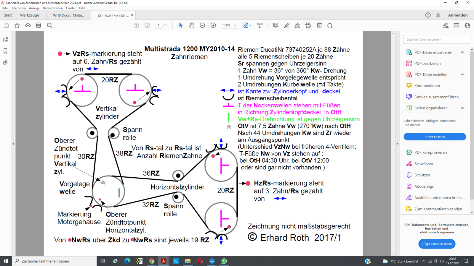

    Following instructions, I turned the engine over to align the tdc marks on the cog and case. So far, so good. I then marked the cogs and belts with Tippex. Still good. I removed the belts …. Here comes the bad bit…and in doing so, smeared/erased the marks on the vertical belt!
    I’ve read the Ducati Workshop manual which requires the vertical cylinder cam gear ‘slots’ to be aligned horizontally (the inlet rotates when the belt is removed.)
    Question: if the engine has stayed at tdc, the cog/case marks still lined up, can I “simply” align the vertical cylinder cam end ‘slots’ horizontally and refit the belt?
  3. hope it helps
  4. Assuming you have put the new belt on, then surely you just need to rotate the engine till vertical is at TDC on compression, then check the alignment marks are correct and you're good to go?
