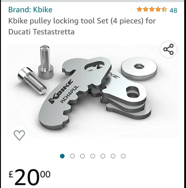

  5. Yeah - though you cannot adjust the verniers with tools like that. The design of the verniers on the Stretta is to ensure that the belts / pulleys adjust perfectly, unlike on the quattro where it is only based on the tension.
  6. How would that work on a Ducati where two belts share one pulley? It could work on the vertical cylinder I guess but not both.
    Personally I think all the tools actually make the job harder. Just do it by hand.
  7. Yeah - how are you supposed to fit the vertical belt with half a belt for the horizontal in the way on the bottom pulley?
    Some people do mark the pulleys and the old belts and then reproduce the markings on the new belts and match the markings of the belt they fit to the pulleys.
    I see how that can work, although Ducati's intention with the vernier pulleys was to adapt to tolerances (manufacturing and from use) for a better timing. And such a technique does not account for this.
    And more importantly, that would stop me from indulging in a new tool. ;-)

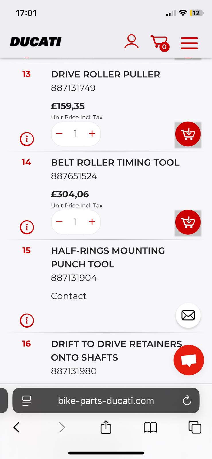

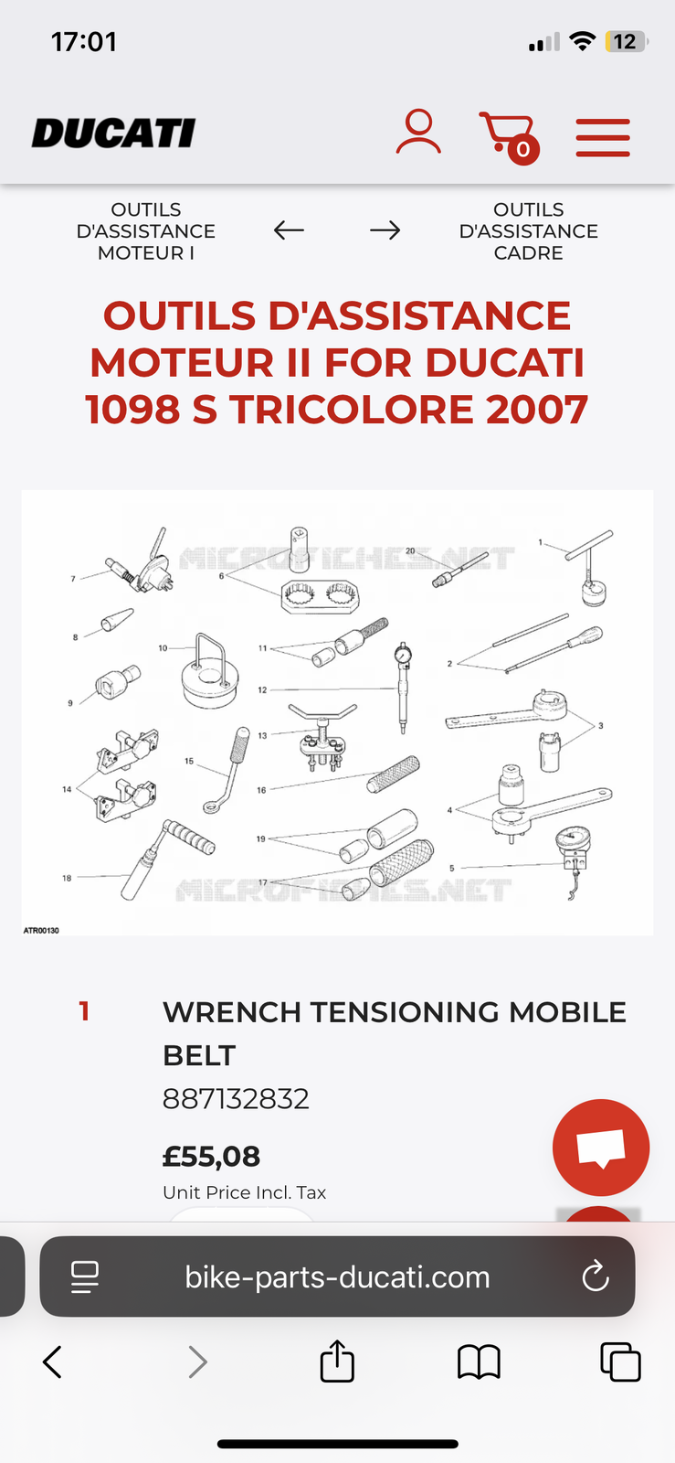

  13. You can buy the official ducati tool. Item 14
