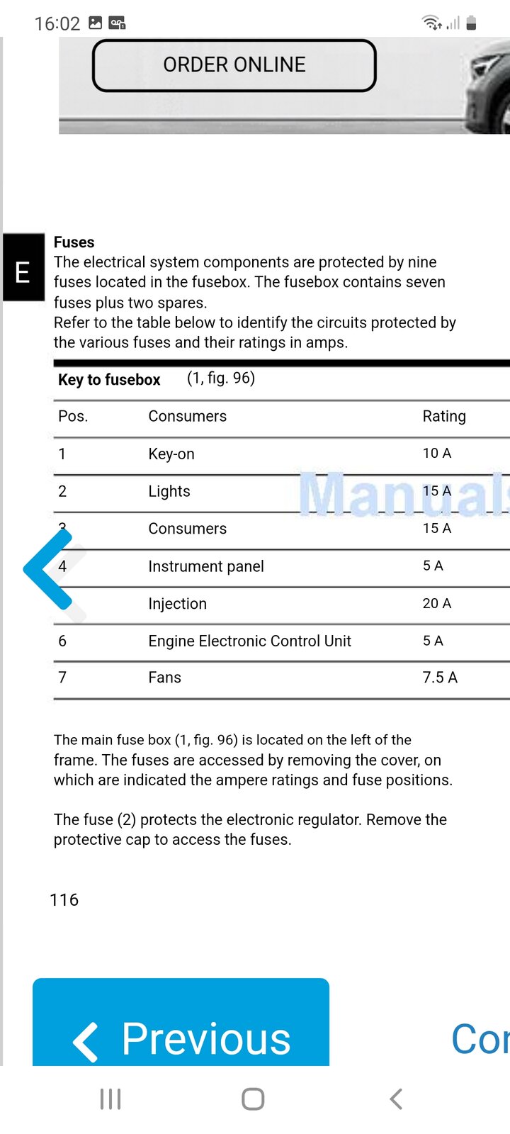

  10. Standard fuses. The ECU fuse is a 3 amp as well.
  11. Sorry mate. Bit confused. Page 117 of the manual fuse guide has no 3 amp fuse in it. Says it is a 5a. Sound right?
    I bought mini. Plonker. Will pop back to the shop tomorrow!

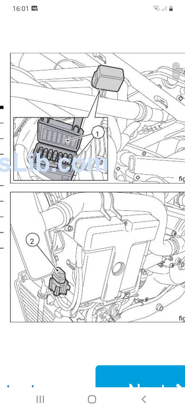

  12. I'm assuming it's fuse Box number 1 I need to look at? Thank you.

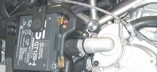

  13. Two more fuses to left of battery
  14. OK I'll have a look and see what I can find. Much obliged.
  15. That appears to be a 749/999 battery box. I believe the OP has an issue with an 1198?
  16. Yes that's correct. There's 2 fuse boxes, the main one plus another that is highlighted in the photos I added above. I'll check both out. The second one is close to the battery looking at the diagram.
  17. My bad. Been talking 999’s and forgot this thread was 1198.
    I can blame my age!!!
  18. Still, I assume, the same principle? Re ecu. But a 5a fuse and fuse Box 1?
