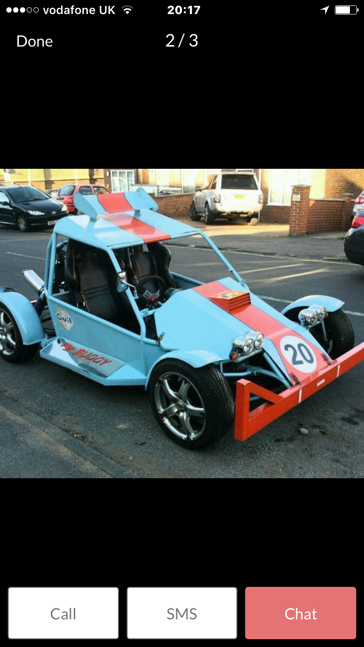

  1. Hi,I've spotted this "special" locally advertised.The power unit is an R1 Yam with a manual gearbox setup.The guy has obviously spent brewsters on the build and it looks pretty good quality with plenty of the right trick bits!What I would like to get some advice on is changing the gearbox to a sequential (paddle) setup.is it major work and roughly would any of you clever engineers out there have any idea of the cost to get the job done? Thanks for reading

  5. That should already be sequential because it would be using the r1 box. A propshaft is connected to a specially made flange that bolts onto the sprocket shaft. What i would be looking for is a push button shift which mounts behind the steering wheel slightly.

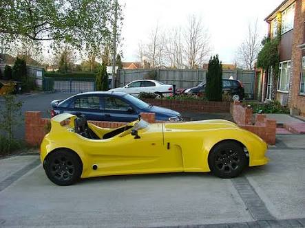

    I built this about 14 years ago. Formula 27 with a zx9r engine in it.
