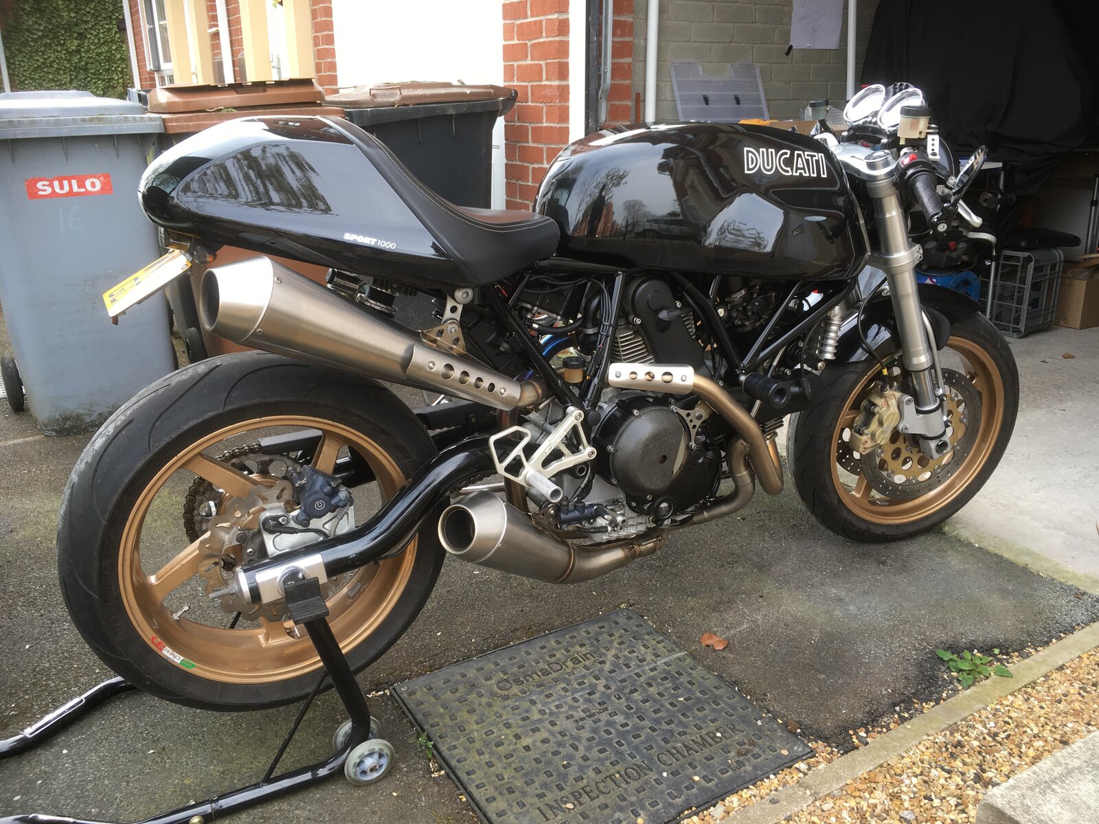

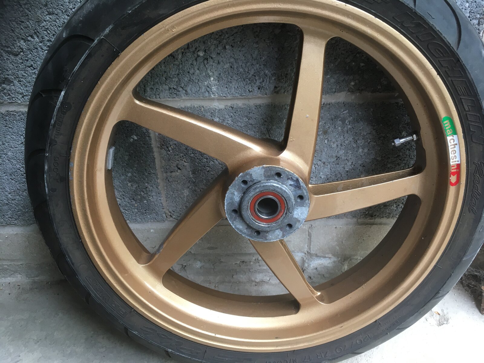

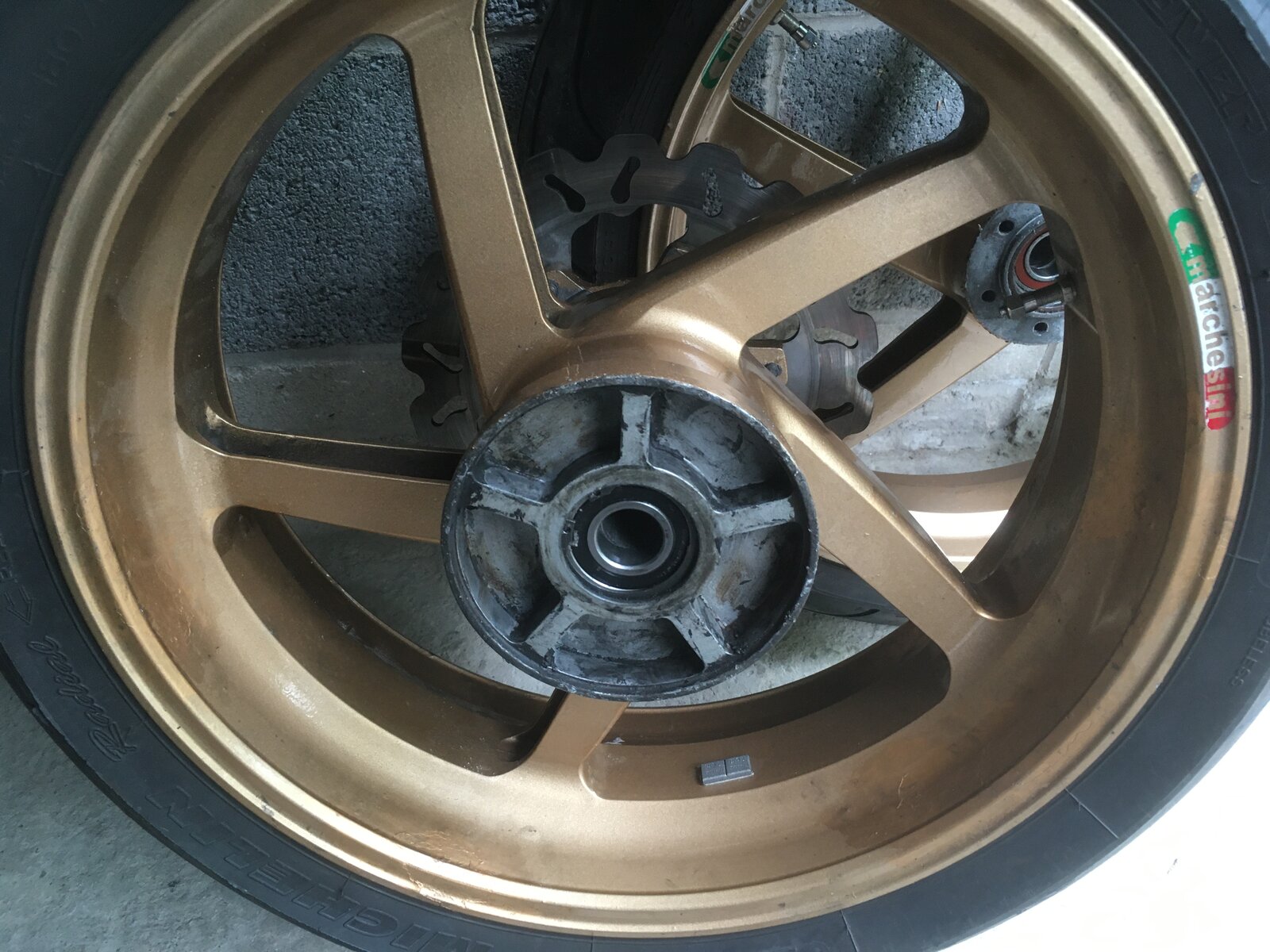

  1. Hi Gents
    Got a question for you. These are the wheels which were on the bike when I bought it.
    Claim to be Marchesini, seem to be magnesium. Not one casting mark to ID the rims.
    Just wondering if anyone else has these rims fitted or know about them?
    Upload image... hope that worked. See my bins too.

    The front callipers are also different to fit the front wheel.
    Standard rear calliper, some fabricated axle spacers, and a 14/45 sprocket set-up! The bike does 120max, but is very punchy.

    they look Marchesini to me.
  8. The front looks like the Marchesini 748/998 mag rim.

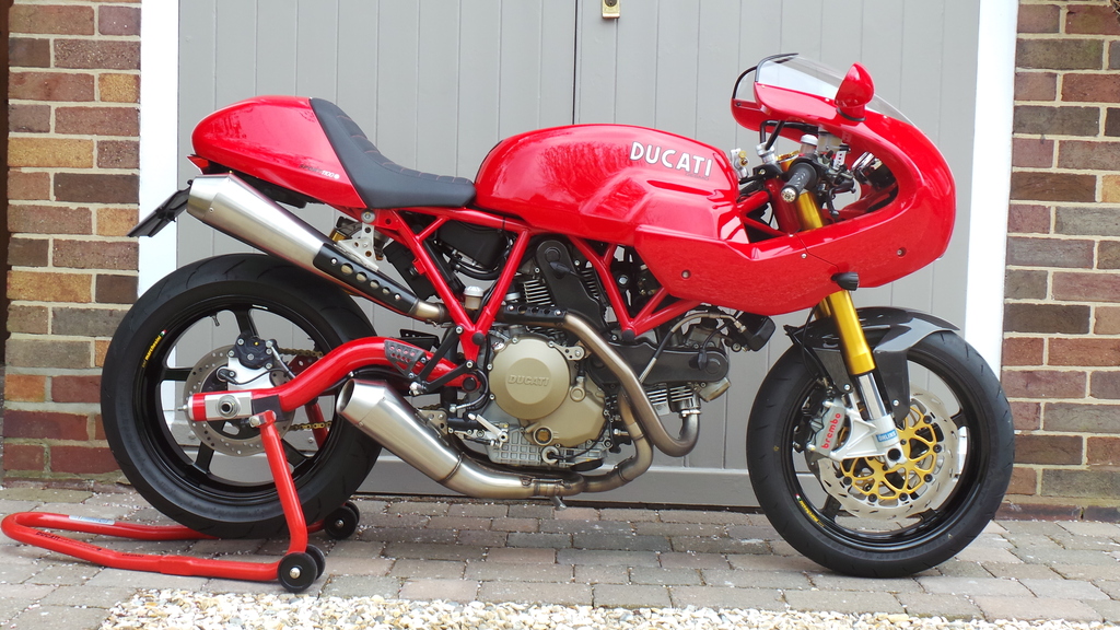

  9. Had them on mine back in 2011 - i think they were 5 spoke lightweight Marchesini for the Monster S4 and SS range...
  10. That looks lovely!

    Ok, that a good lead to follow up. Monster S4 and SS.

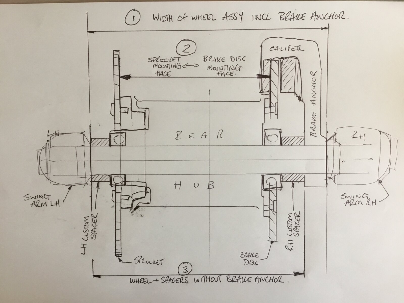

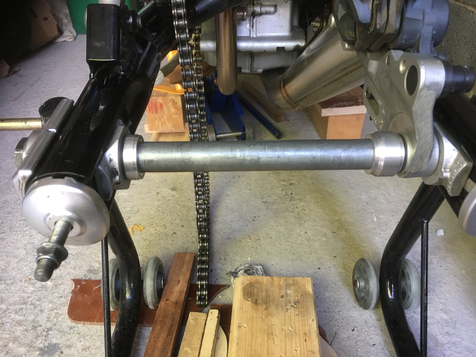

    Absolutely, I agree with checking the alignment.
    There are spacer collars either side of the rear wheel to position it, left to right.
    I need to make sure the wheel is actually inline to the front wheel and then check the sprockets and brake are correctly laterally aligned.
    It has been like this for years, the chain and sprockets don’t look oddly worn, so it cannot be out by much if it is at all, but I want to make sure.
    As I don’t have an original wheel assembly to check against, it would help if someone can get a measurement or two for me off their bike.
    The rear wheel position is currently driven by the brake disc. There is a spacer between the factory brake anchor and the wheel. Allowing the disc to sit mid calliper.
    Thus the sprocket position is dictated, it is tricky to say if the sprockets are lined up. Straight edges etc, all a but vague.
    Could one of you fine fellows get a dimension or two for me please?
    If know the distance between the brake disc mounting face and the sprocket inner face, then I know all is well.
    Also the overall width of the wheel and spacers, this way I can check the overall width of the wheel and spacers which fits into the swing arm.
    I have a standard brake anchor so a value with or without this will show the spacers add up to the correct width.
    I have made a sketch of what I mean with the 3 dimensions I would really like to know.
  14. Nice sketch - I hope someone can get the info you need.

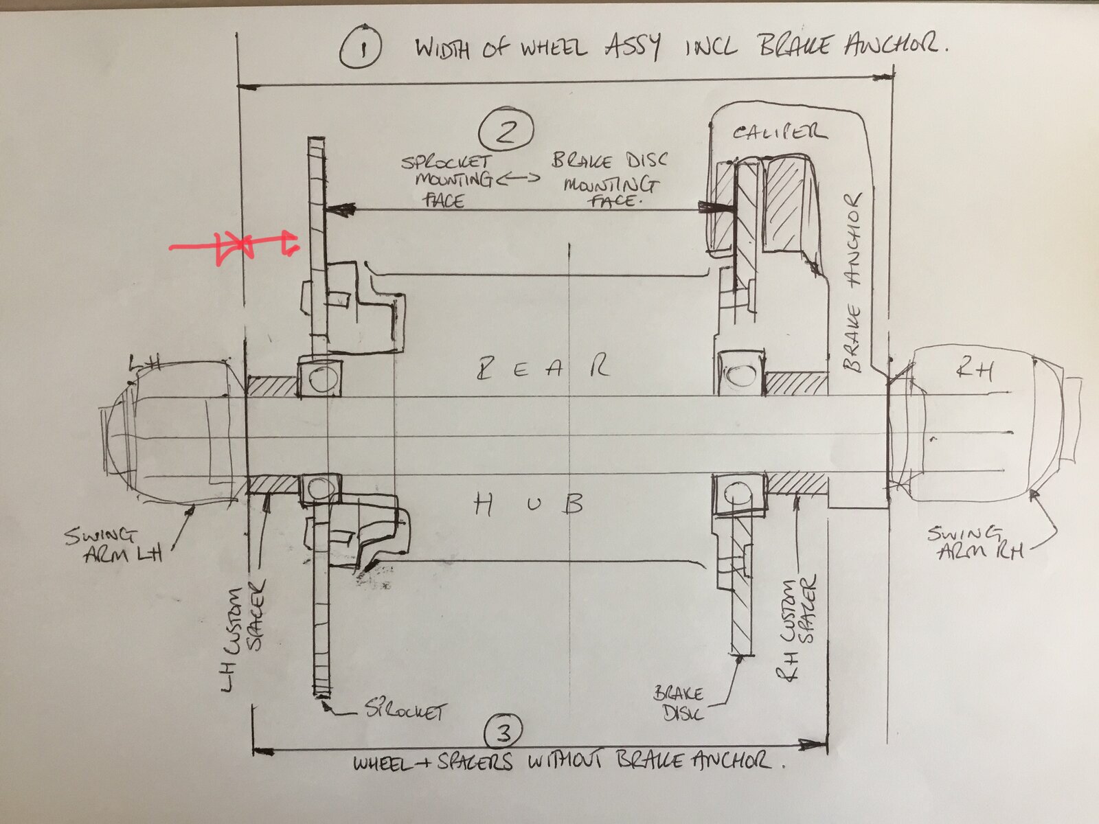

    Would it help to also know the dimension from the inside of LH swing arm face to outside face of sprocket - this should be the same as a standard wheel/sprocket.
    Rubbish annotation of your sketch:
  15. Absolutely yes, another good dimension to check. This would also robust the stack of swing arm, sprocket, brake disc as measured from the left side.
    If I can assertion the sprocket and brake disc are the right distance apart on the hub, and the sprocket be the correct distance from the swing arm, then the brake disc should sit centrally in the calliper.
