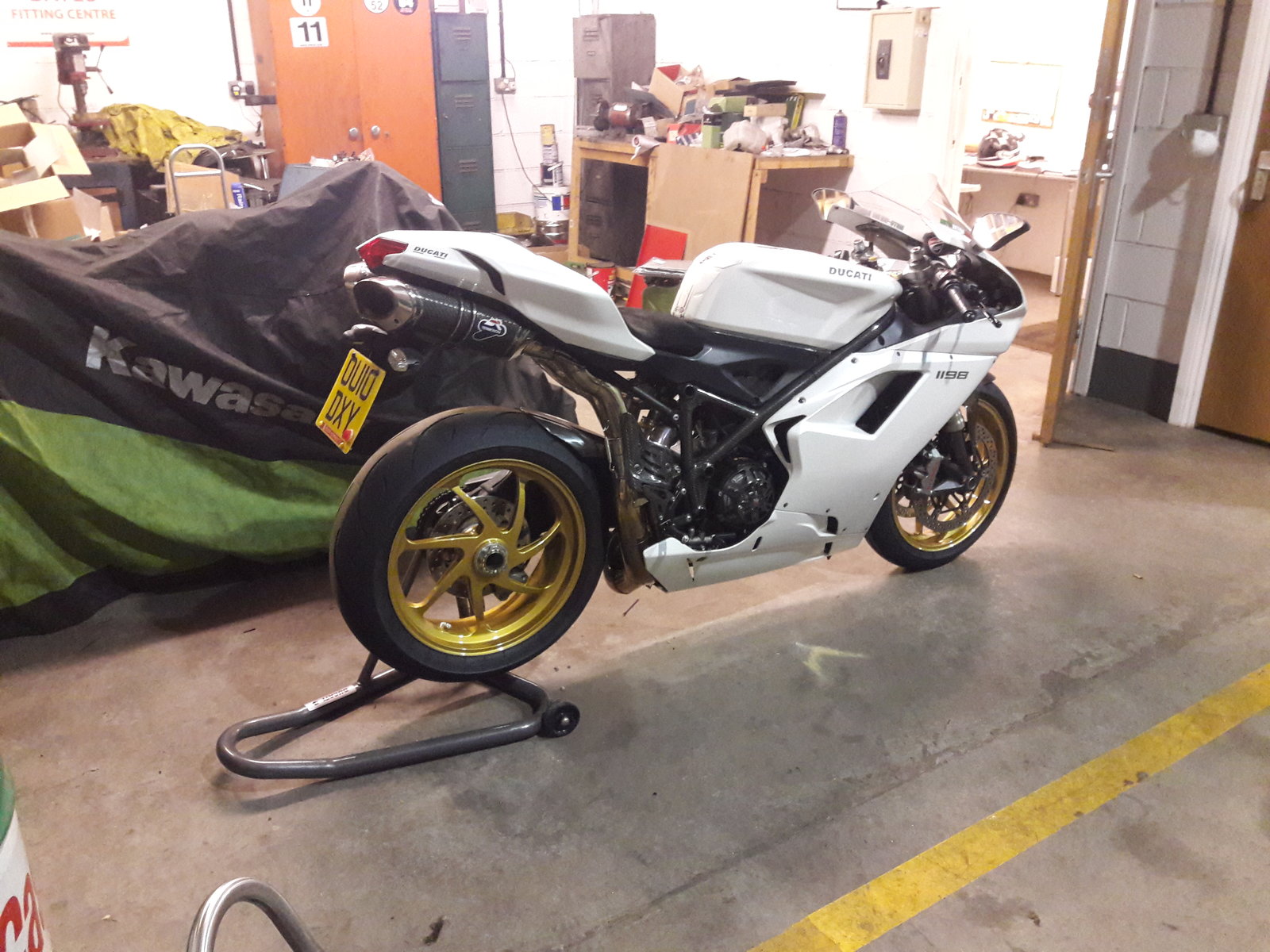

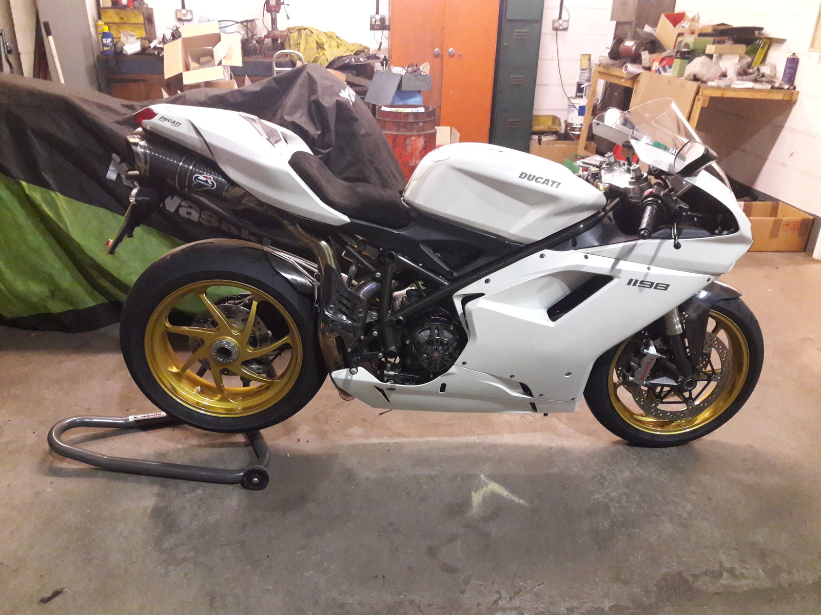

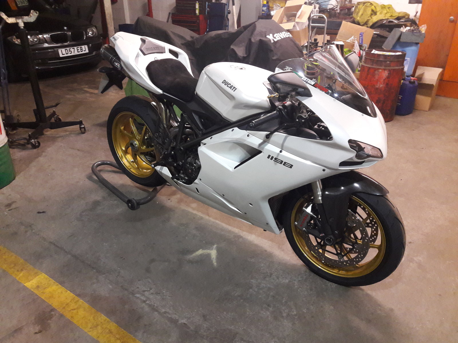

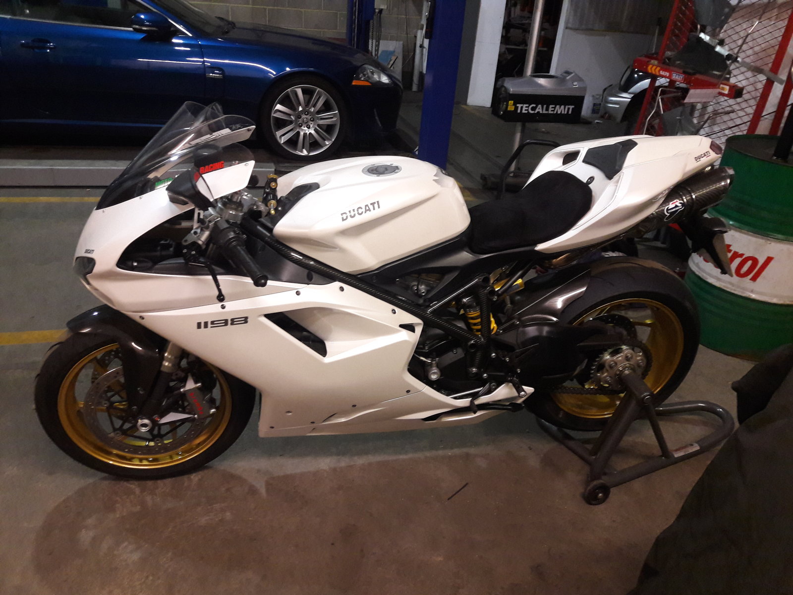

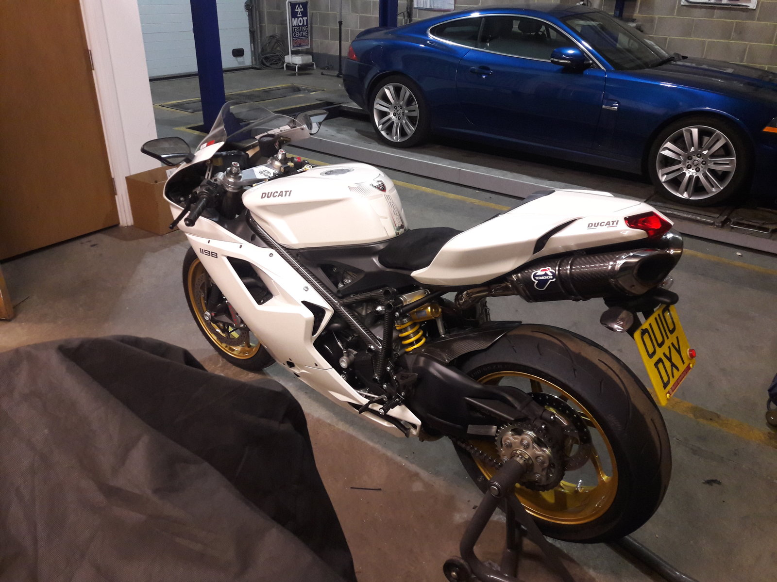

  17. pictures, so we can all enjoy:):):)
  18. My 848 showed me how good handling could be on a bike. A properly confidence inspiring front end that you could just bury into corners. Only downside was my poor wrists.
  19. Get an 1198
  20. 20171228_174102.jpg 20171228_174018.jpg 20171228_174003.jpg 20171228_173935.jpg 20171228_173923.jpg
