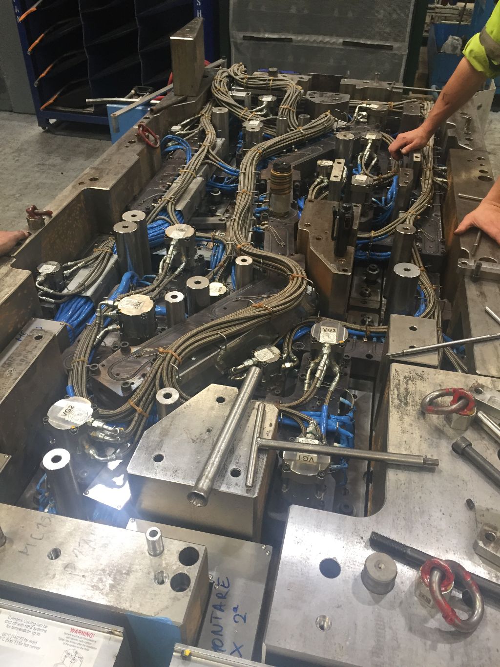

You might like a view of one of out 30 tonne core back twin shot £1,000,000 injection mould tools, fixed half with the back plate off
The hot runner system alone will be worth a fortune! If it’s a 2 shot, what kind of parts is it making? Thanks for that, I’ll be having nightmares tonight !!
