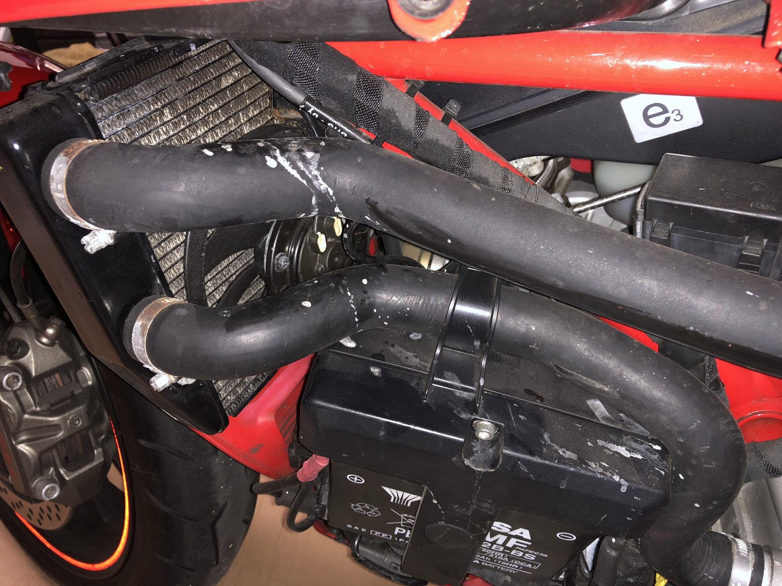

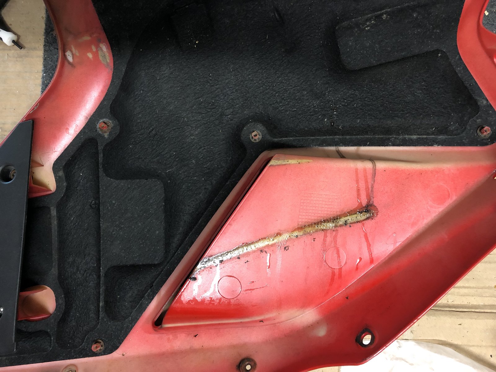

  1. Hi, noticed yesterday that on the left had side there was a strange liquid coming through a gap in the fairing. I am not receiving any warning lights and all seems to run and sound good.
    It feels slightly oily but does smell like oil. Pretty sure its not brake fluid. I have taken the fairing off and the pictures are below. Is this a common issue if so what is it and what do I need to do to resolve it?
    Many thanks in advance
  2. Looks like a radiator leak possibly. This is a common issue with 848/1098.
  3. Rad leaks have a particular smell, so if you can smell a rubbery watery stink, then rads the culprit.
  4. They all do that sir - either re core, buy a new one for a million pounds or get a Chinese one like many have.
    Lot's of threads if you do a search.
    Top row is leaking near the mount... you can see where it is wet on your first picture.
  5. Had this with mine. Top left mount is usual weak point.
