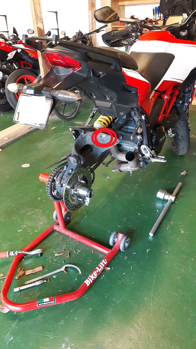

  19. Is this the hole circled in red
  20. That's the hole for the lower shock mount I believe. The hole in the swingarm that the cap goes in is to the front of the casting adjacent to the rear of the gearbox. Have a look at the photo in the link I posted above, there's an arrow pointing to it.
