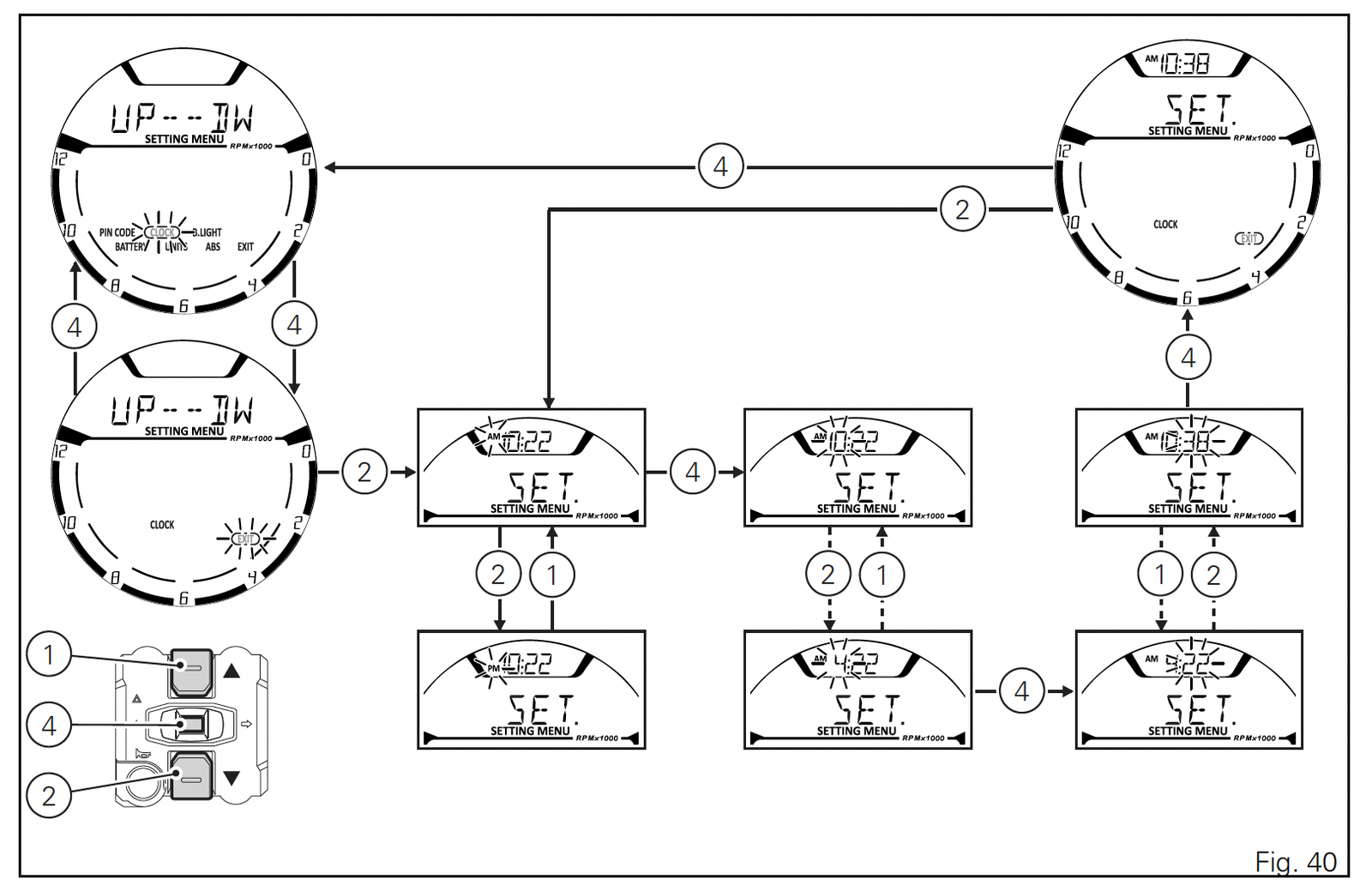

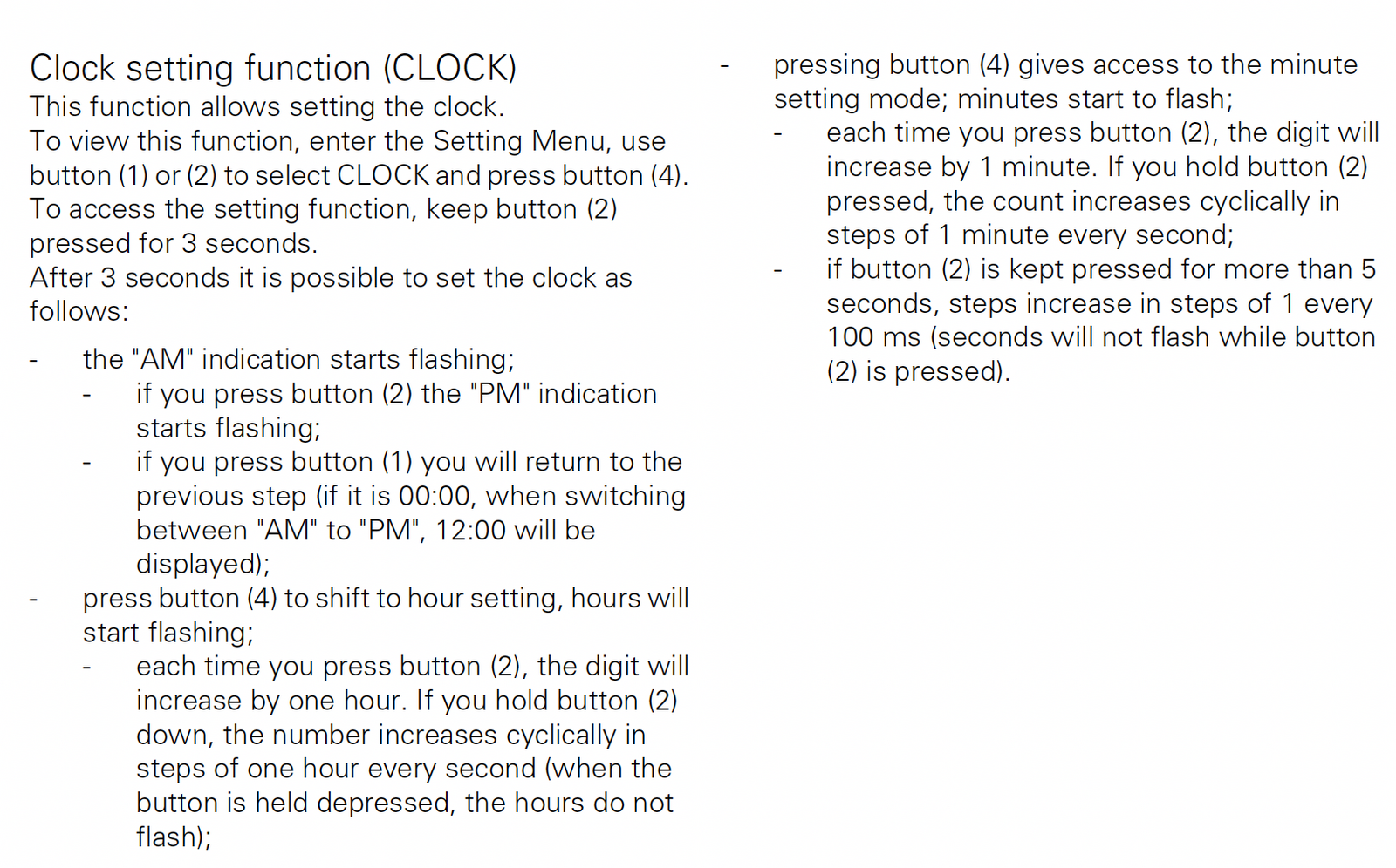

    Lee - newbie. Can't reset time on display. All other settings functions seem to work, but I select clock in settings, then press indicator shut-off button to bring up clock change mode, and all I get then on settings screen is clock and exit options. I can provide pics if anyone has an idea. Have seen threads on this topic in other Ducati forums but not definitive solutions??? Software issue? Thx in advance.
    Lee
  2. The clock is a total PIA to set, it's completely non-intuitive. Here are the pages from the handbook if it helps.

  4. Hi Derek, Thanks so much mate. These instructions did the trick, but what an unintuitive design. Italian, of course!!
