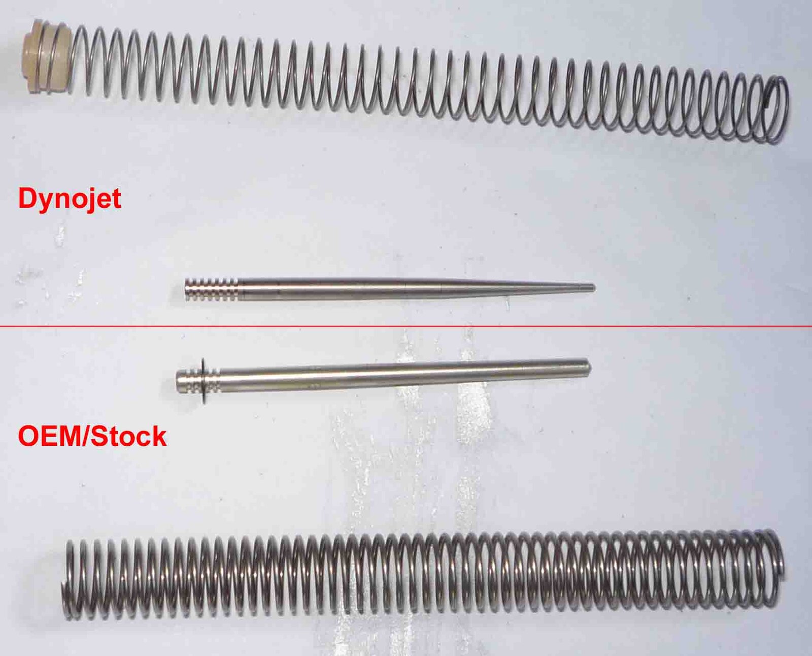

    Are you sure you have a proper Dynojet kit in the carbs.......for example, how do you know the needles are 'set for open cans'? DJ needles aren't marked with any sizes. Are the springs definitely DJ?. Are the jets DJ? (They will only have a size on them, no other mark)
    In other words, check the photo below.
    When you are satisfied you have the right parts / kit; check the float measurement - if you have set them at 14mm, it will run weak - they need to be about 12mm (or even 9.5mm).
    Also check the diaphragms are torn/split and causing the slides not to lift - up to 2000rpm - 2500rpm, the carbs use the pilot circuit only.
    It would be a good idea to take the pilot screws out to check the springs; O-rings and tiny washers are there (or actually exist).
    The file below is the Dynojet Stage 2 kit instructions and specification.

  14. Arquebus, yes the needles and springs are dynojet, exactly like your picture shows.
