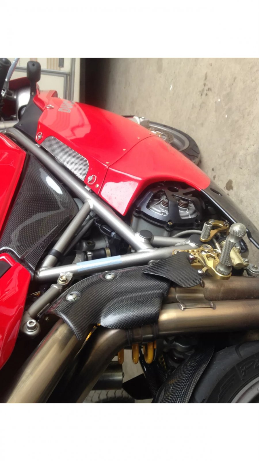

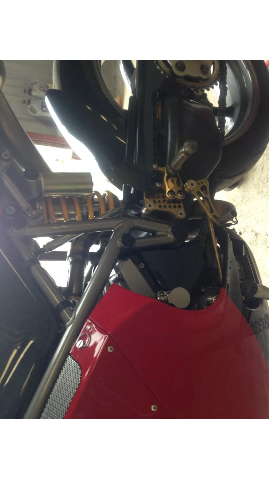

  8. Do these pics help identify if it's a 50mm system?
    I'm going with what the previous owner said.
  9. all that pic says to me is you NEED carbon intakes ;)

    Selling the rearsets as they're a pain in the ass to ride with. Fitting standard footrest hangers.
  11. I have some standards from my 996S
    first thing I saw when I looked closely at your first pic was "I need to get new rearsets"
  12. Already got standards mate but thanks.
    These are gilles rearsets. I'm 6ft4 so can't get comfortable with them even in lowest position. If you're interested is buying PM me and we can discuss.
