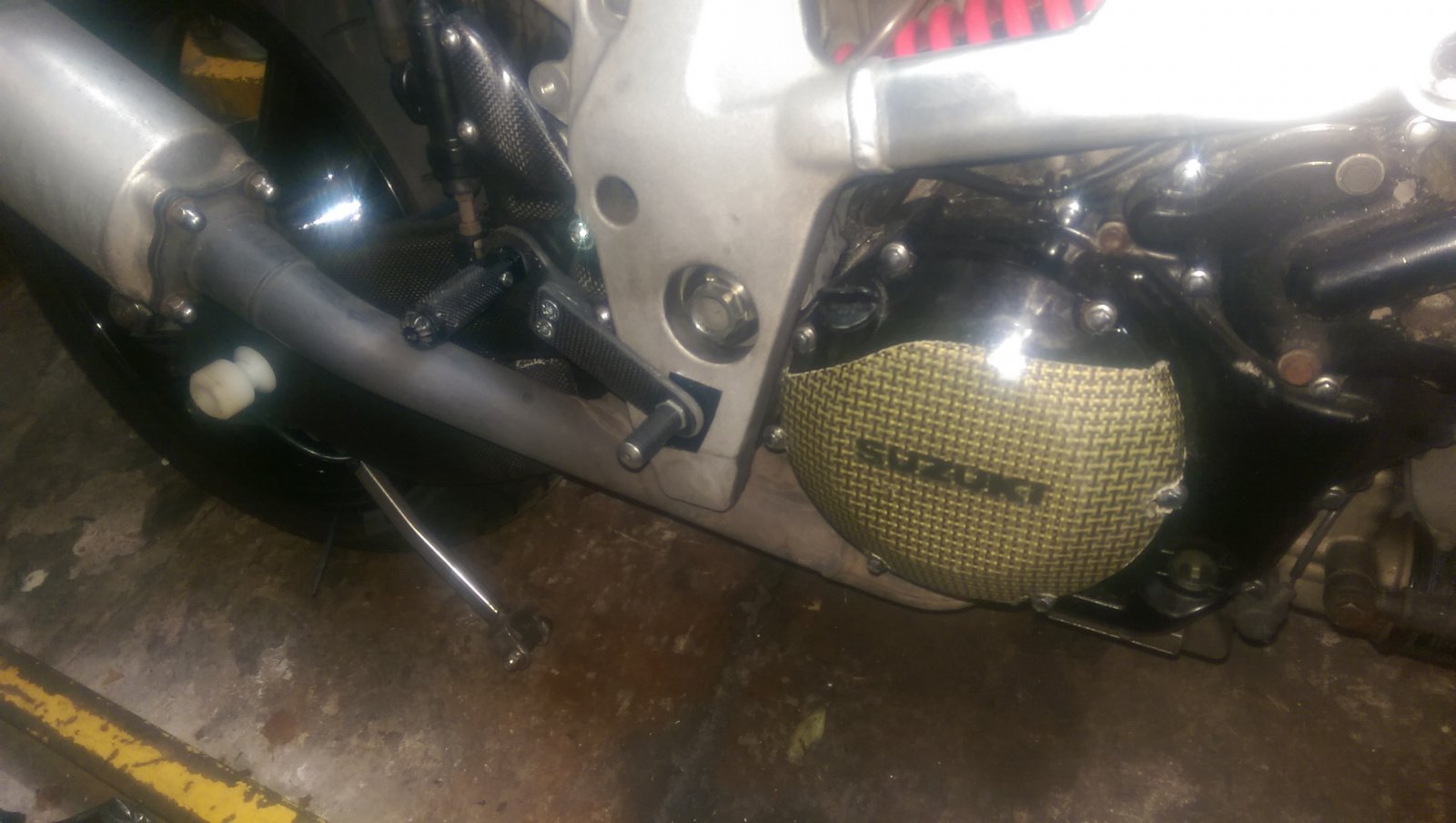

    I've made loads of carbon and Kevlar parts and there's a good few factors to consider. Not least, weight, strength required and cost.
    Here's some current work. Swingarm covers, rear sets, case cover. IMAG0546.jpg
